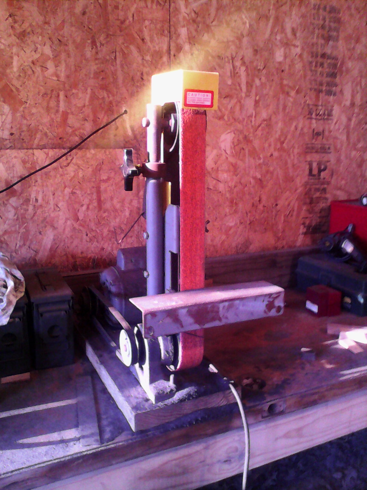

I just snapped a pic as I was leaving the shop. This is the 2x48. When I bought it it I didn't own a welder but I have since acquired a Lincoln Weld-Pac. I will soon be building a four leg platform for the grinder out of 2" angle-iron. I'll mount the motor underneath. I have friends who own Burr-King shop grinders and I can't stress enough, this little machine is not in the same category as a  $3500.00-$5000.00  grinder. It is however a workable option on $350.00 budget.

I have the exact same grinder, only I modified it for my own uses. Put a decent motor on it and it'll remove material quite well for its size. I've had this for over 12 years and it's been about trouble free. I have maybe $400 in it total including the brand new motor I bought for it.
