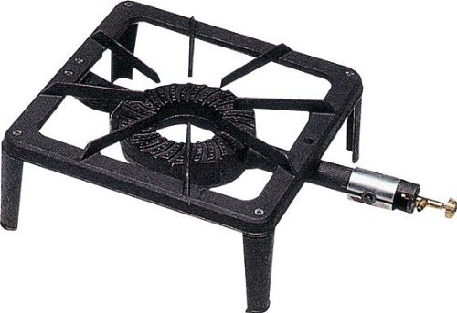

February 17, 201610 yr hello I have a big stove Methane gas burner, as you advise me to turn it into a forge to heat and make plastic the metal for forging? thanks to those who will want to provide tips and photos hello to the next
February 17, 201610 yr NO; you are far better off to build your own air/fuel gas burner, and build the forge you want from scratch; there are loads of instructions for doing so on this forum. Stove burners are not designed to run in an enclosed heating chamber.
February 17, 201610 yr I would recommend making a real gas forge either from a freon bottle or propane bottle. It would be much more efficient and safer. That's what I am doing, building my self a freon bottle forge. Go to waynecoeartistblacksmith.com and go to forge supplies. From there you can get all the materials you need and read his PDF on making a gas forge. Read around on the gas forge section of this forum for good tips and safety. Have fun!
