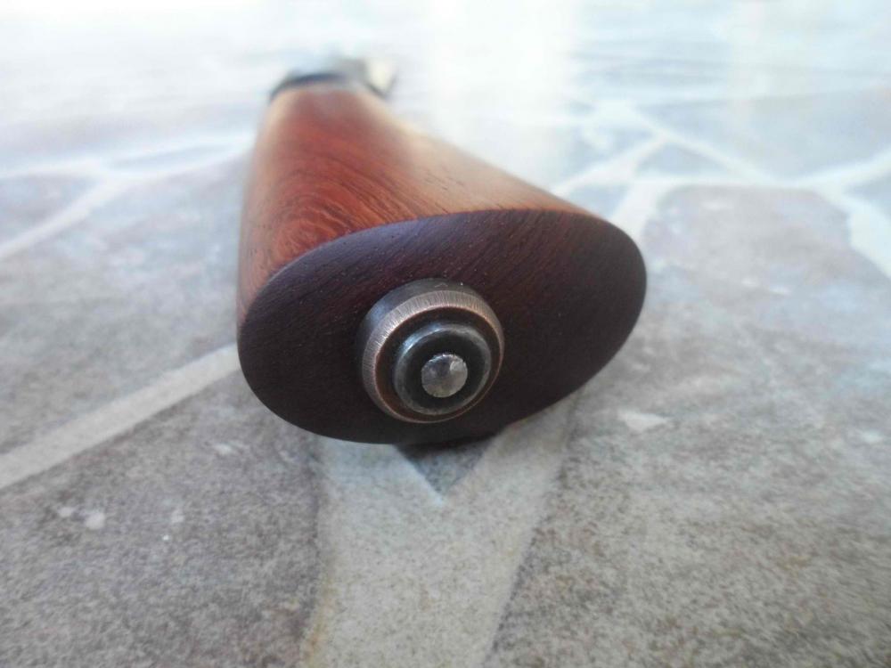

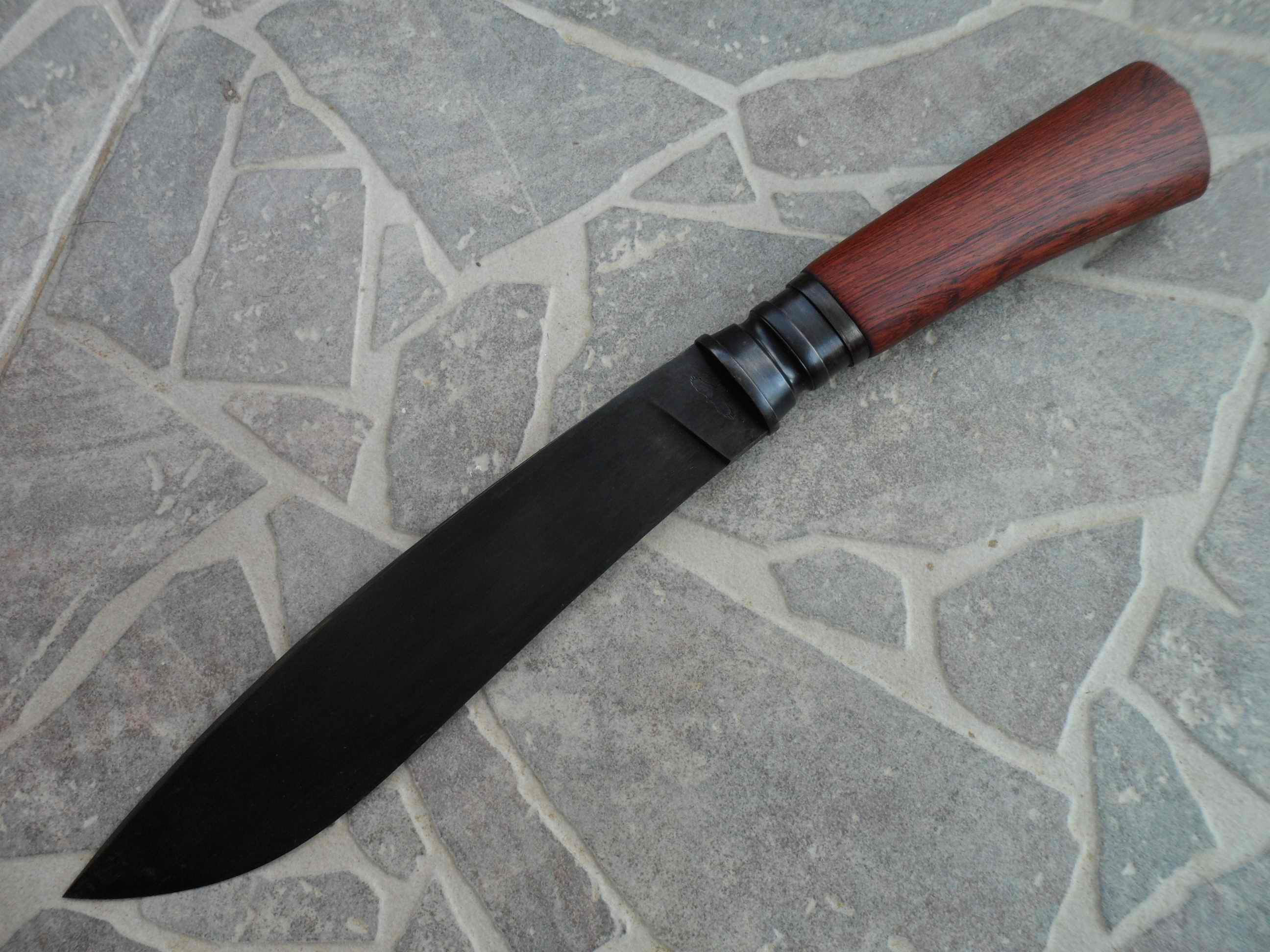

templehound Posted December 30, 2015 Share Posted December 30, 2015 This one has a O7 blade with a length of 205 mm, overall length is 348 mm.Fittings are iron and the handle is Padouk root. The sheath is from water buffalo hide and the tip is reinforced with horn. Happy new year. Quote Link to comment Share on other sites More sharing options...
neg Posted December 30, 2015 Share Posted December 30, 2015 It's just beautiful. I wouldn't change a single thing, really great job! Quote Link to comment Share on other sites More sharing options...
Daswulf Posted December 30, 2015 Share Posted December 30, 2015 Very nice blade. Love the overall dark look. Quote Link to comment Share on other sites More sharing options...
Stormcrow Posted December 30, 2015 Share Posted December 30, 2015 Always love your work. So graceful and useful at the same time. Quote Link to comment Share on other sites More sharing options...

otto Posted January 8, 2016 Share Posted January 8, 2016 Wow, That's an amazing looking blade. What is the finish on the blade? Quote Link to comment Share on other sites More sharing options...

templehound Posted January 12, 2016 Author Share Posted January 12, 2016 On 1/8/2016 at 0:45 PM, otto said: Wow, That's an amazing looking blade. What is the finish on the blade? It is brought to an 600 grit finish, sisal polished lenghtwise and cold gun blued....no specific brand, I take what makes dirty and dark. Thanks. Quote Link to comment Share on other sites More sharing options...
