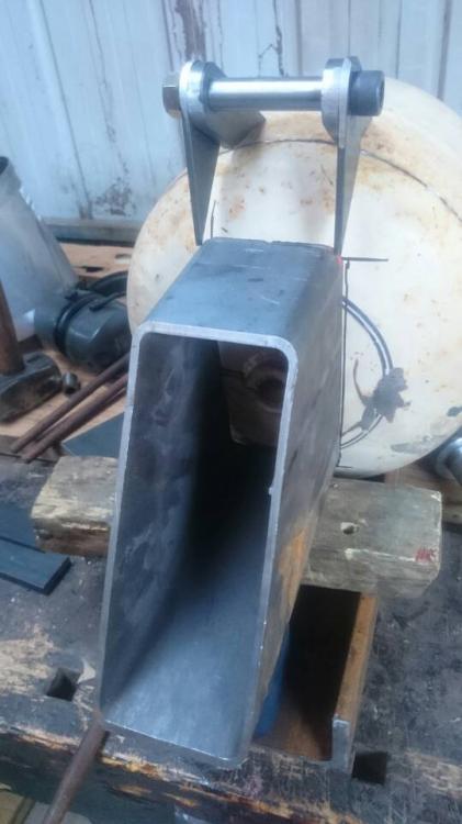

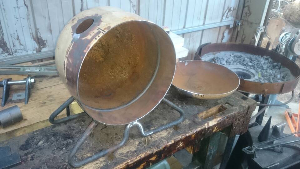

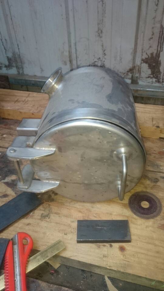

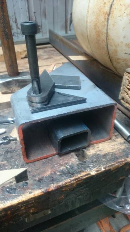

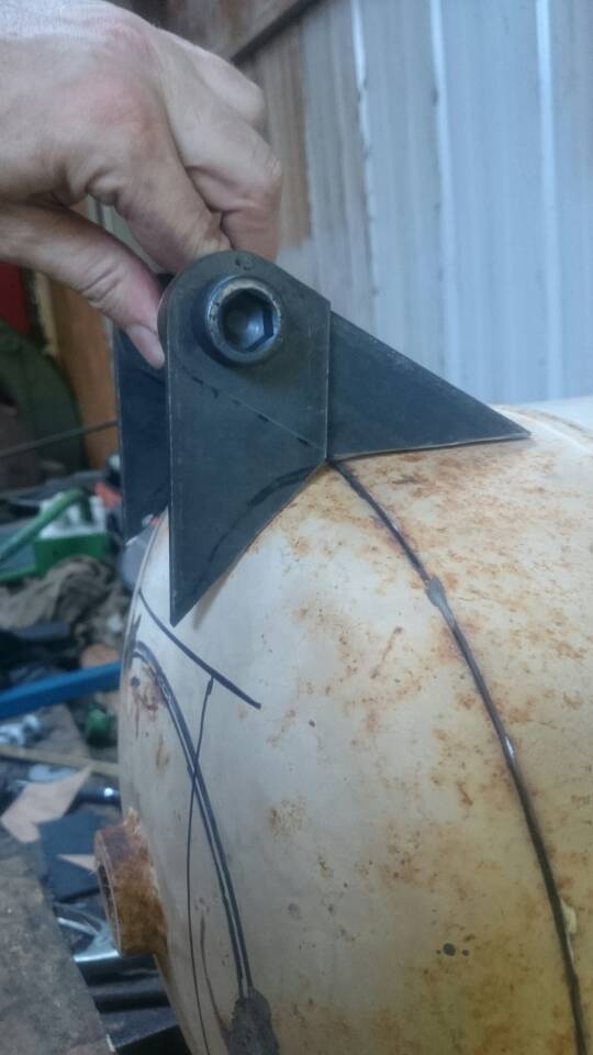

FlyingXS Posted December 25, 2015 Share Posted December 25, 2015 Got my Isowool, 1" Thick and ended up with the top heat rating and density as the one I paid for was out of stock so they gave me the better one at no extra charge. I plan to use the kiln tiles as the forge base. They are the white ones and look a bit like marble tiles. If they fail I can substitute the orange fire brick in. Making two forges one from a 9kg lpg gas bottle and the mini forge. The large RHS tube will become the front mouth, the smaller RHS is the rear mouth to allow for long items to poke out the rear. Hinges are done hinges just need to notch out the front to follow the curve. Hinge is made to match the width of the forge mouth. Next I need to make the feet and fit them so I can set the baseline foe horizontal to which the mouth can be cut parallel and the hinge pin at 90deg. Only problem is I have to wait for a non fireban day (Summer here and bush fire risk area) to light the coke forge to bend the feet. Quote Link to comment Share on other sites More sharing options...
ForgeMan32 Posted December 25, 2015 Share Posted December 25, 2015 That's a great looking set up. Especially the mini forge that's an awesome little stainless contraption. BUT,one thing I do see from the pics is that the propane tank forge looks to have a GALVANIZED burner tube and assembly . please correct me if I am wrong . I've made a few gas forges and I always shoot for black iron for those parts. Just looking out for a fellow smith and those parts don't get terribly hot but the burner tube itself may get hot enough to put off zinc fumes Quote Link to comment Share on other sites More sharing options...
FlyingXS Posted December 25, 2015 Author Share Posted December 25, 2015 Cheers mate I appreciate the concern. Only the pipes and the gas valve are plated, the others parts are all plain cast steel. The entire burner assembly comes from a gas fitting company that has a specific section for knife makers, blacksmithing etc. SO WHILST NOT 100% I'm reasonably confident it will be ok. Quote Link to comment Share on other sites More sharing options...

Mikey98118 Posted January 3, 2016 Share Posted January 3, 2016 Loved the photos of the hinge; they really were worth a thousand words. Quote Link to comment Share on other sites More sharing options...

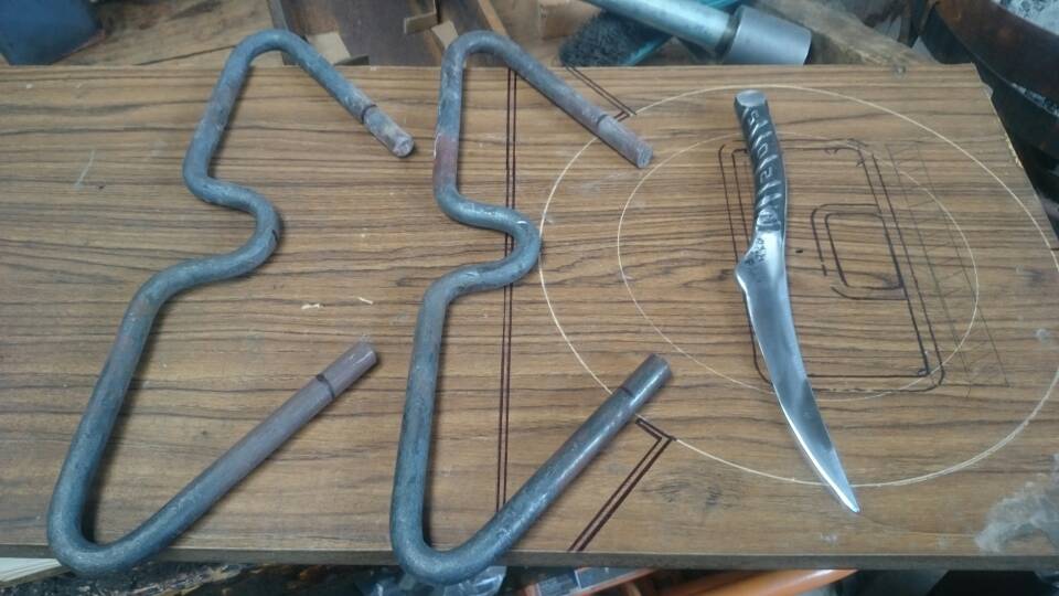

FlyingXS Posted January 3, 2016 Author Share Posted January 3, 2016 Fired up the coke forge and bent the feet up. Made a rebar filleting knife while I was at it. Welded the feet on to set the base horizontal. Plan was to fit the hinges before cutting the last few tabs that held the door on but that left me with a guess as to the location of the mouth. So I cut the door off today. New plan is to line it and fit the floor measure the height. Tack the door back in place cut the mouth and fit the hinges. Not 100% sure where the burner is supposed to point. So I'm thinking of pointing it at the centre of the floor. Quote Link to comment Share on other sites More sharing options...
