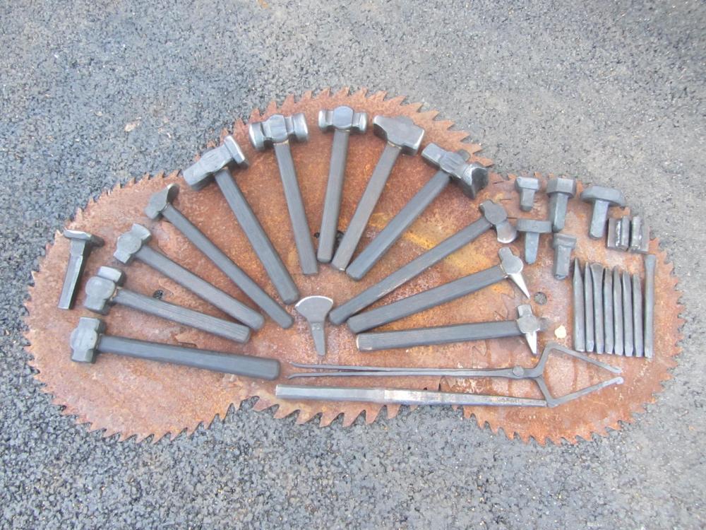

I finally got around do get the photos ready, and I shot a video showing the tools.
this was a 6 day class in Norwich, Norfolk, England. and o yes........I would definitely go back, and do it all over again. Alec Steele is a wonderful instructor.

What type/types of steel is everything made from?
Hammers were 1055.
Top tools were something a bit softer, like 4140 maybe ......
And the punches were something like 5160.
Excellent work, impressive array of tools, top recommendation for Alex's courses and I at last know what those tongs are called.....and am now wondering why I couldn't work that out myself! :D
Thanks for posting Ethan.
Very nice tools Ethan it is great to see blacksmiths of your age interested in it. Its a dying art that we need to keep alive ,it's so addictive when you have really get into it. And I think when you said 4140 was softer I'm not so sure of that.4140 is some tough steel to forge especially if you forging hammers from it. Great work and tools
