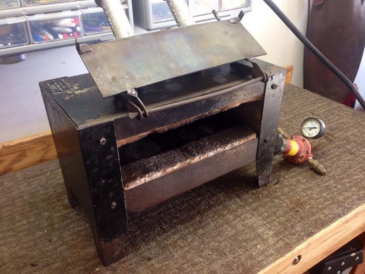

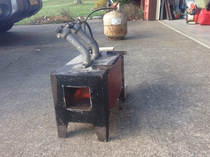

I took an old farrier's gas forge with a front door, and converted it into a end loader. Open on both ends, so I can put long pieces through.
Problem is, with both ends open the flame keeps blowing out.
But if I cover one opening with fire bricks, it burns just fine.
WTF?
It looks like the openings on the ends are a modification from the original design in the first picture. The burners are designed for a certain amount of back pressure and the change has altered the back pressure. You can get some soft firebrick and reduce size of the openings till it runs properly.
It's breathing exhaust gasses. Does it sputter or just shut off?
Try making a shroud to either direct the exhaust away from the burners or isolate the burners from the exhaust. Two different things with the same effect. No need to get fancy to test the modifications if one works you can make it more permanent later. Try opening a short piece of small stove pipe or a large tin can and slipping it over the ends of the forge to direct the exhaust farther away from the burners. Or place an open ended pail over the burners so they're drawing air from farther away.

I've looked at the photo, and it seems unlikely that uptake of exhaust gas into burner intakes is the problem; not with the burners offset like that. But, he doesn't say whether or not the burners have flame nozzles attached, so lack of sufficient back pressure just could be his problem. I think the addition of flame nozzles will prove to be the simplest solution for it. Of course your idea of redirecting exhaust gas further away the the burners with  temporary structures is painless enough to be worth doing, just to eliminate the possibility. Stuffing a firebrick under the burners within the furnace should be a fairly painless way to check out the back pressure possibility, too.
The new holes on the ends result in about 1/3 less area than the original front door. I would think that the back pressure would be slightly increased with the modification.
