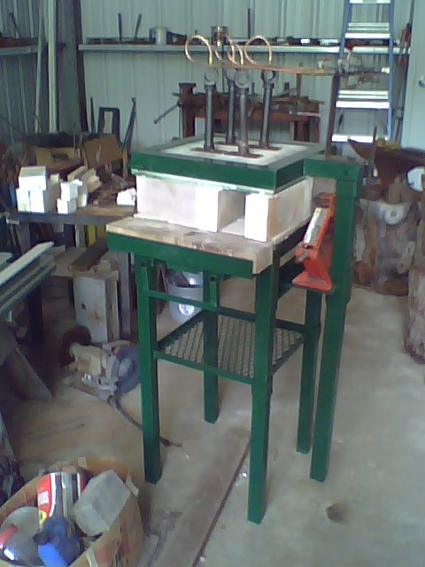

Below is my main shop forge in it's 3rd incarnation. The pic's only reason here is to show how bad a place it is for rubber supply hose. The manifold and hose fitting is above the jack on the right. I've only had all 4 burners running at the same time to test and on a couple occasions when there were 4 of us using it. the new forge is much MUCH smaller.
