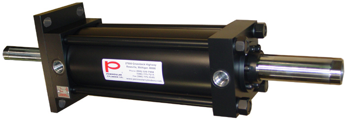

so i have been thinking about a easy ( for me at least) head design for a kinyon style, or guided helm (rusty style).
i was just thinking the modified kinyon head from gearhearts and love it but i dont have access to machining equipment.
i just thought what if i took 2 hydraulic cylinders of the same diameter, cut the top 3-6 inces off and welded them together the matching cylinder rod could pass up and down through them both . driven by either a air ram as the kinyons are or maybe as the rusty are. I doubt if the rusty would have the power for that sort of set up, but for a cheap option for a guide with no machining.
it would require welding it and keep it straight but im sure i can do that, and you could fill or put an amount of oil in there to lube it up as it goes.

They do make double ended cylinders to "skip the middleman" of what it appears you are doing by welding cylinders end to end.  They are not uncommon...just harder to find.  I most commonly see them in lumber mills.  Just last week I saw at least a dozen appropriate ones at the auction of a limber mill equipment supplier.
Would be far better than the hassles of welding....assuming I am understanding what you propose.

Chrome shaft is very cheap in standard sizes, it should be possible to use the cylinder and caps from two rams and run a shaft through the middle and do away with the piston. there is only a seal and a rod wiper in the cap that the shaft exits from. the trick will be finding two cheap and crusty old bolt together rams to wreck.

if the ram is shorter than the stroke half a cup of oil in the cylinder will keep the seals lubed, if it is a long shaft two rams might be needed. The most common ram I see is 8 inch stroke and inch shaft. I can tell you inch shaft flexes a lot and is quite easy to bend.

sorry bud I'm not so much thinking of an actual working ram just using the caps as a guide for either a new rod as yahoo mentioned or reusing one of the ones from th original Rams I cut up.

Now we are on the same page, yes exactly. I was thinking about a 2" shaft diameter and just a standard ram cut and welded to each other and the frame rather than a bolt together.
however the bolt up idea might be even easyer. I was thinking of just using the shaft from one of the Rams I salvage. I was thinking the ideal ram would be 2-3"x 2'. Should get a good bit of stroke out of that. All depends on what can be found I guess.
Cylinder shafting does not weld well as it is a high carbon very hardenable material. The rod bearings from cylinders are not designed for much side loading and will wear quickly. The piston seals will make much drag. If bound and determined to use something like this, look at Parker Hannifen brand "Jewel glands" these are a cartridge bearing used in hydraulic cylinders and are a kit you buy. Take the seal out of the bearings but use the rod scraper to keep the scale from eating the bronze bearing up. Us a long rod salvaged and use the threaded ends to attach to the ram and the spring.

I would agree with ptree about the seals not holding up to the movement a powerhammer makes.  And they are not cheap to replace.  If you have easy access to hydraulic cylinders a press may be the way to go.
