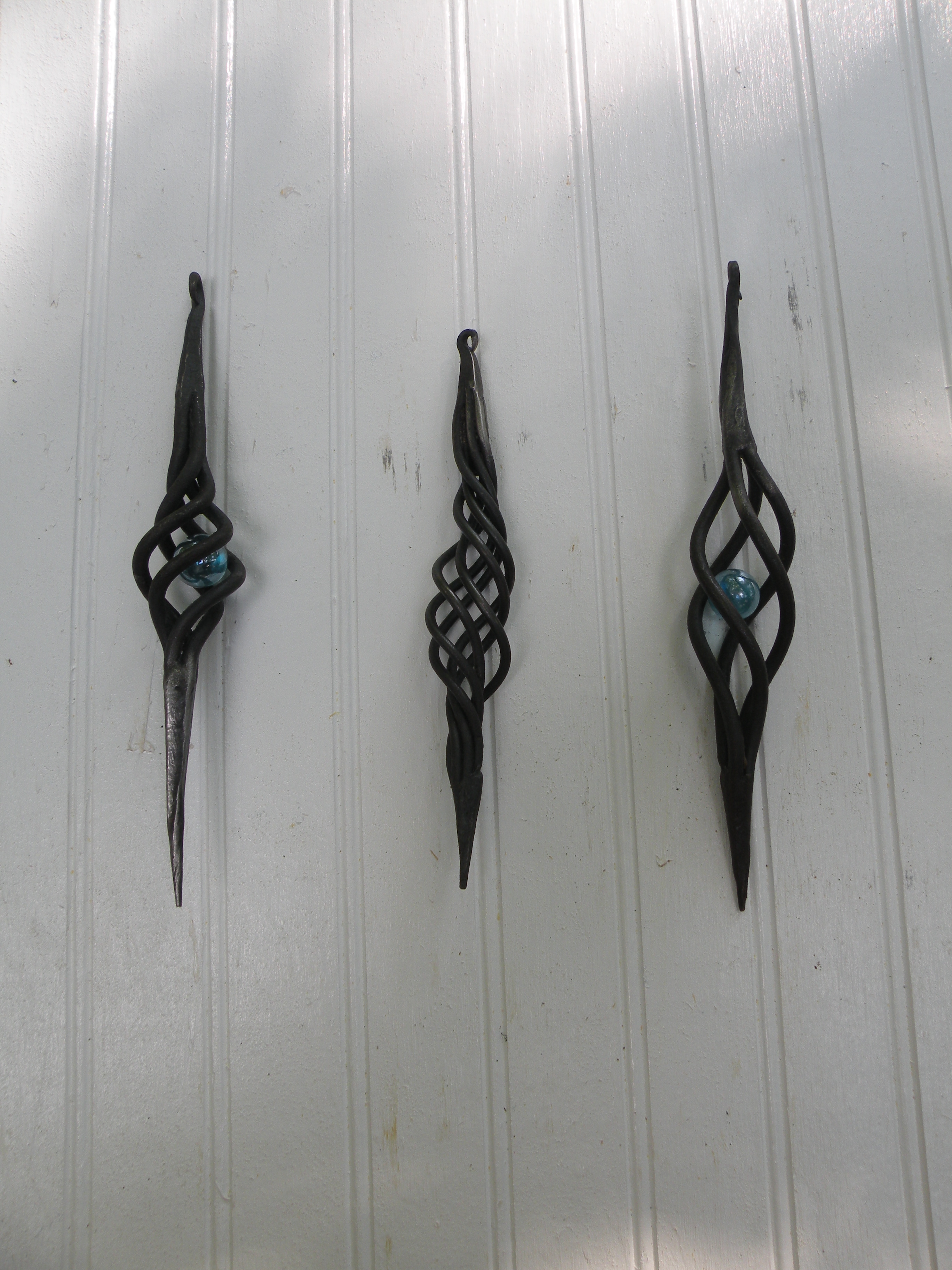

I already figure on the split crosses and I found a nice twisted "icicle" with a marble inside in the gallery by J W Bennet here from back in 2008. I figured maybe you others might have some ideas, something else besides the simple cookie cutter sheet metal shapes cut out and textured. I've thought about dishing out and making a few hemispheres and maybe brazing them together as hanging balls. I've thought of a large piece of round stock flattened into a disk/mound, and have a few thoughts of maybe some heavy bar stock necked down and tapered as a tree. I wonder if I can find some thin sheet stock if I can't do the old folded paper snowflake in steel... Heat it and fold it all up, then take the saw or chisel to the stack and see what happens when I unfold it..

The pict may make it look bigger than it is. The bead board paneling spacing is a bit less than 2" IIRC. I want to say overall height of the "icicles" is maybe 7-8". I used 6" of stock to start with. Larger stock was 1/8" and the smaller stock is 1/16" rod. I've seen a lot of wooden commercial ornaments that are larger/heavier than these are.

Icicles.thumb.jpg.9eff5e180cf2339cea7796
