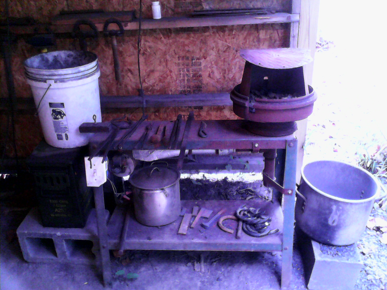

TwistedCustoms Posted August 17, 2015 Share Posted August 17, 2015 Alright, I have a question. I made a terrible side draft forge and used it to make a lot of stuff actually, but I really need a forge with airflow from below, so, the Brake Drum forge. I recieved both rotors and drums for free and was wondering which makes a better charcoal forge? Opinions, Ideas? Hi Armourer. I'm posting some photos of how my forge is set up. It's made of two brake drums bolted together back to back. The smaller drum on the bottom makes a stable base and provides ductwork. When I set all this up two years ago I didn't own a welder. I had one goal, to start forging, and one obsticle, make it happen with bolt together parts. The big drum on top is 12" across. I cut slots in the sides so I could get longer length work deeper in the fire. I burned wood charcoal in this fire pot for about three months and was able to forge weld just fine. Nothing fancy, but basic welding and forging was no problem. Since then I've switched to burning coal and coke, mostly coke, and I've burned over three thousand lbs of coke in that fire pot. I'm on the bottom half of my second ton of coke in the past two years. You can see the cracks in the bottom but it's still going strong and I'm going to keep forging in it till the bottom falls out. I may purchase a "propper" forge when that day comes and I may go back to the scrapyard and pick up another brake drum. I didn't let not being able to afford the best equipment stop me and noone else should! Lots of people online say you cant forge on a cheep, soft, cast iron anvil. Not true! If the steel is hot and you dont mind standing up to the anvil snobs you can make beutiful things with a brake drum and a cast iron anvil. When I decided I wanted a guilotine fuller I made one out of stuff already laying about ( still sans welder) My first hammer came from harbor freight and after doming one face I forged with it for a year. If I do decide to build my next forge at the scrap yard I will use a smaller brake drum because of burning coke. If charcoal was my only fuel I would say the bigger the fire pot the better. If there is any chance you will switch fuel I would use whichever vesel thats closest to the size of a grapefruit. I hope the pictures give you some ideas and look forward to seeing what you build! Quote Link to comment Share on other sites More sharing options...

TwistedCustoms Posted August 17, 2015 Share Posted August 17, 2015 Hi Forging Carver. The hood is (i think) around 18 guage steel i just cut and bent. The top is a thin peice of diamond plat. It all stacks together and I remove it often once my coke is burning good. I mainly use it to tame the flames when I first light a fire. I use pine knots to start my fires and when you shoot the air to the pine lighter you get big flames jumping up. Two years worth of fires in that spot about 10" from a wood frame and OSB wall. The wall gets warm to the touch but so far so good. As to weld temp, I'm no expert but it's my understanding that the fuel doesnt matter, fire is fire. The air flow is what accelerates combustion. If you feed fuel fast enough you should be able to burn paper or anything and reach weld temp, some fuels just burn up faster than others. I cant articulate the science involved but I can tell you that using charcoal I was able to turn steel into sparklers and even burned some 5/8" stock in half, as in dripping when I pulled it out of the fire! Way too hot! I would guess that if you're not getting hot enough you just need to increse the air flow and be prepared to burn through fuel faster. Quote Link to comment Share on other sites More sharing options...

TwistedCustoms Posted August 17, 2015 Share Posted August 17, 2015 Ok thanks. So once the fire is lit, you dont use the hood anymore? I leave the hood in place if I'm working on small stuff but I have the option of lifting it off with tongs after the coke is lit and the fire settles down so I can heat the center section of longer stock. There is a caveat to that; if your air exceeds the maximum amount of "burn" your forge can acheive then the excess is actually cooling the fire. Why you can blow out a match when a softer exhale will just make it burn faster.The max output on my little squirrel cage fan wont reach that volume with the fuels I've used, coal, coke, charcoal, hardwood. The only real difference I've seen is the consumption rate, hardwood burns up the fastest and coke gives me the longest burn time by volume. I haven't played with different fans because the first one I hooked up was able to produce forging and welding temps with all those fuels. Im guessing it would take a pretty stiff breeeze to blow out a coak fire but I do live in Tornado Ally ;-) Quote Link to comment Share on other sites More sharing options...

TwistedCustoms Posted August 18, 2015 Share Posted August 18, 2015 So does the hood act as a flue and take away the smoke?Thanks The hood doesnt draw because it doesnt go anywhere. I have a big shop fan hanging from the rafters pointed at the forge. I run the fan when I first light it to carry out the wood smoke. Once the lighter burns off there is little to no smoke frome the coke so I can kill the fan in winter.Thanks. Currently I have been playing around with the idea of a brake rotor in a brake drum? I found one that fits perfectly, nice and snug and the downward pipe is extends without a gap, together 55 pounds, I kinda like the weight lol, could stand some heat! Or what do you guys think, bad idea, a waste of brakes? Unnecessary?It wont be a waste if it works! If you can nest the two together to get the size firepot you want and the ducting works go for it. It cant hurt to beef it up. One advantage to not welding anything together is that after burning a pot of fuel you can rearange things easily if you decide to modify the design. Quote Link to comment Share on other sites More sharing options...
