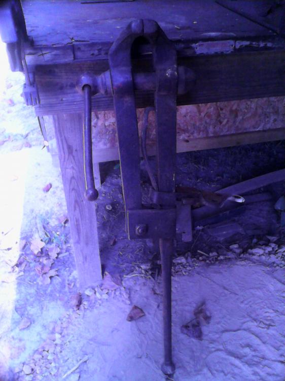

Perfect end to a busy morning. $80.00! Works like a champ, never been welded or ground with the dreaded angle grinder! I'm going to pick up a 6x6" post and a few bags of concrete this evening. I'll update when I get it mounted.

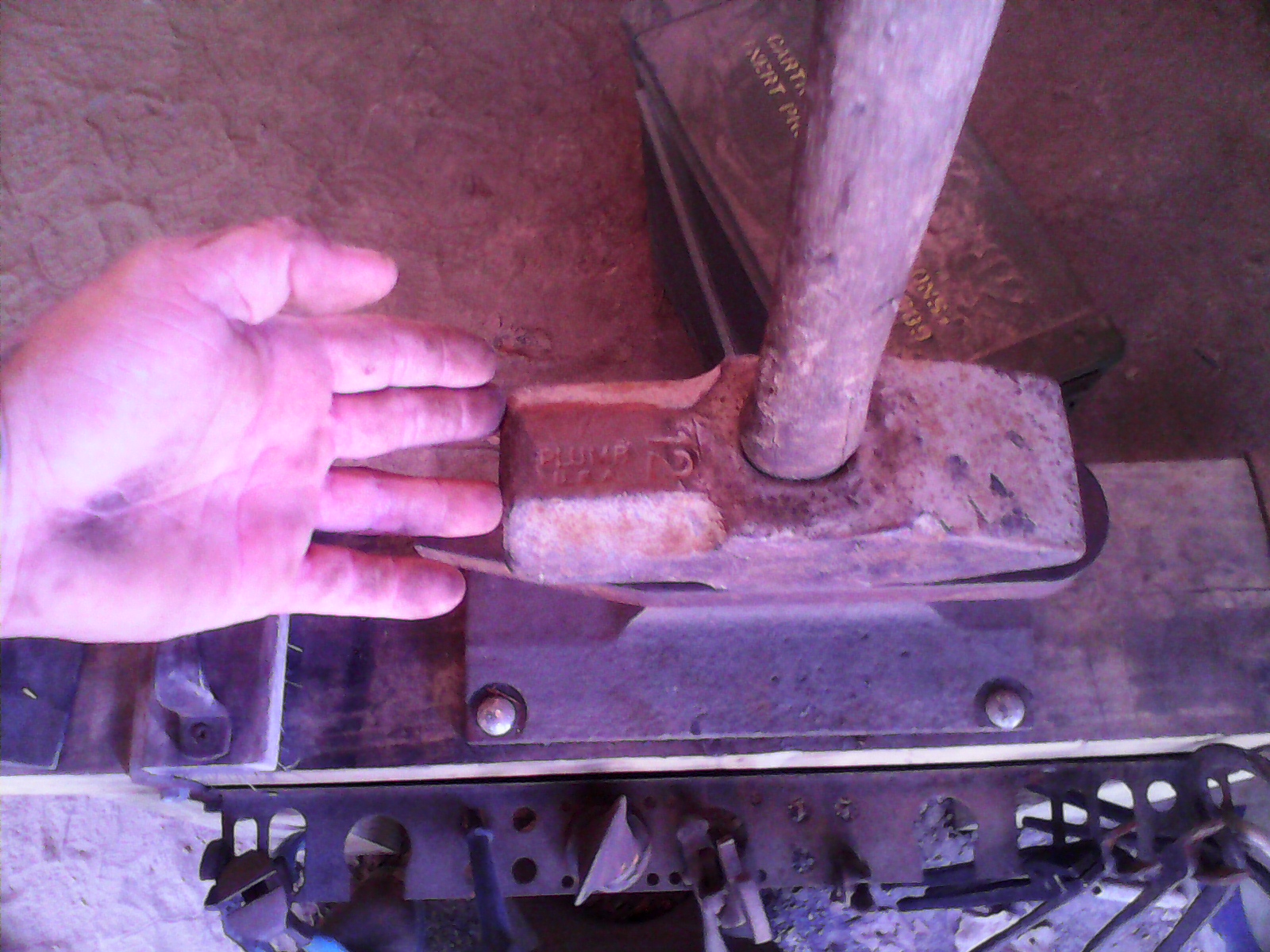

 Also got a nice 12lb Plumb sledge for a few bucks.

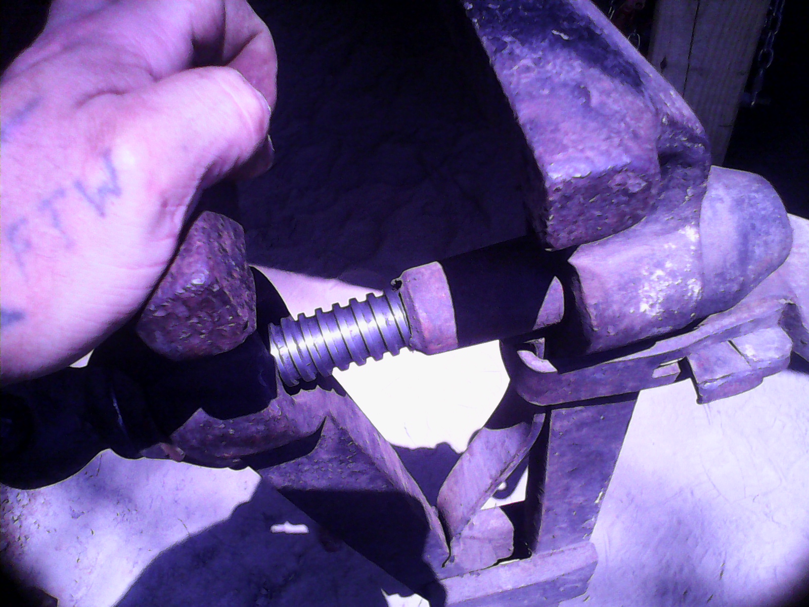

Dont know about the C yet, I'll check when I go back up to the forge this evening. Does the "C" denote a certain maker? Its a 4" jaw and the acme thread screw is pristine! Ill open it up and take more pics this evening. I dropped it off at the forge and since then Ive been soaking up air conditioning!
unbeveled legs, screwbox with a short back with it wide open, can be indicative of a Columbian  Vise, as is a C on the mounting plate. (though mountings tend to get shared around between vises more than other parts do...)  If it a Columbian it was made in Cleveland Ohio

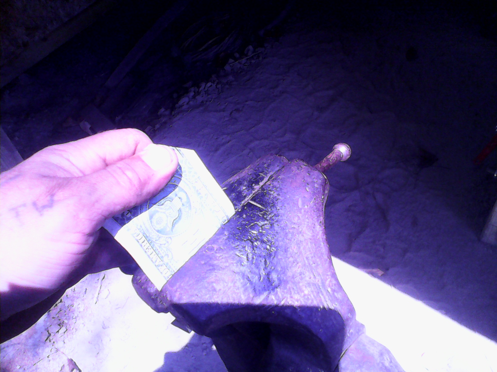

OK, I didnt find a C or any other marking, stamp or makers mark. The jaws will grab paper all the way across and the screw looks good to me. Any info you might have would be appreciated.

Those are square threads not Acme.

    I just saw the 29 degree thread pitch on the ACME. Thanks for the heads-up, I've been missusing that term for some time. Any idea if the square threads are indicative of earlier manufacture or were any post vises ever made with ACME threads?
Square threads are used for heavy loads. Acme threads are not as good in an application such as vise due to the angle on the sides.  The square thread is a straight push whereas the acme will want to also move laterally.

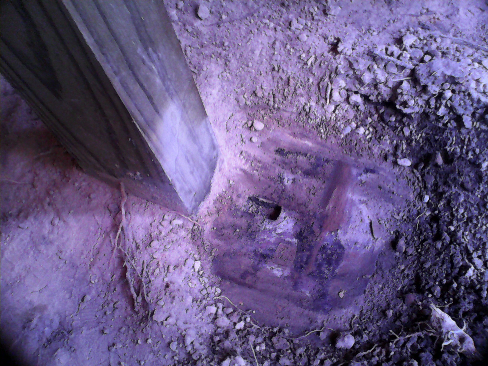

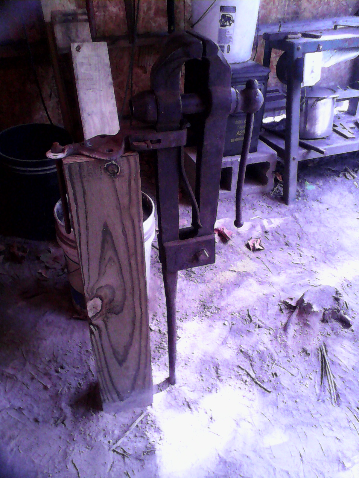

1/2" steel plate slotted to accept the lug on the post set into a 3' deep quickrete footing. The 4"x6" post is also in 3' of quickrete. Tomorrow when the CoOp opens I'll be drilling a hole in the base of the post to accept a bolt that will anchor a chain and binder tie down. I plan to build a portable stand for the vise at some point so everything I'm doing now is with a view to being able to remove it quickly. I have one 3" lag bolt holding the mounting plate on for now but lags in end grain wont hold. I may end up forging a strap I can bolt through the post and not use the original mounting plate until I can bolt it to a steel stand. My footing is strong so I'll keep at it till I know I can hammer on it! Work in progress.

If you're going to make it so you can swap the vise between stands, I would definitely save the OEM bracket for the other stand.  It's easy work to make a bracket that would work for the vise and not screw into the end grain of the post you have.  Then all you'd have to do is knock out the wedge and gib key and move the vise to the next stand.
My thought exactly, if that post was a bit higher you could have just bent a strap around the vise and slotted it for the wedges and have it go on back to the sides of the post, (I would probably put in a bolt behind the wedges to keep the strap from getting further apart during use)
Thanks for the advise guys! After looking at it fresh this morning I am going to forge a strap and save the original mount for bolting to a portable stand.

Your set up looks a lot like mine. Right now I've got mine screwed down with a few of the long 3/8" star drive construction lags that I can quickly drive with my impact wrench. The other one I have set up with hanger bolts. The ones that have wood lag screw on one end and machine threads on the other. To remove that vise, all I have to do is spin off the nuts and lift the vise. The threaded studs stay in the wood post. The original idea was to use cast steel hand wheels like big wing nuts, but I've been too lazy so far to either machine them on the lathe, or too cheap to buy premade ones.
End grain isn't all that strong, but that's in tension. Your bolts are in shear and hold fairly well that way unless you split the post. I really don't see you pulling out those lags in that application. Forged straps would look cool though.
a long enough/big enough lag won't come out. I used 4 8"x5/8" lags for mine. I'm not worried about them coming out at all. Especially since you're hitting towards the wood, not away from it.
