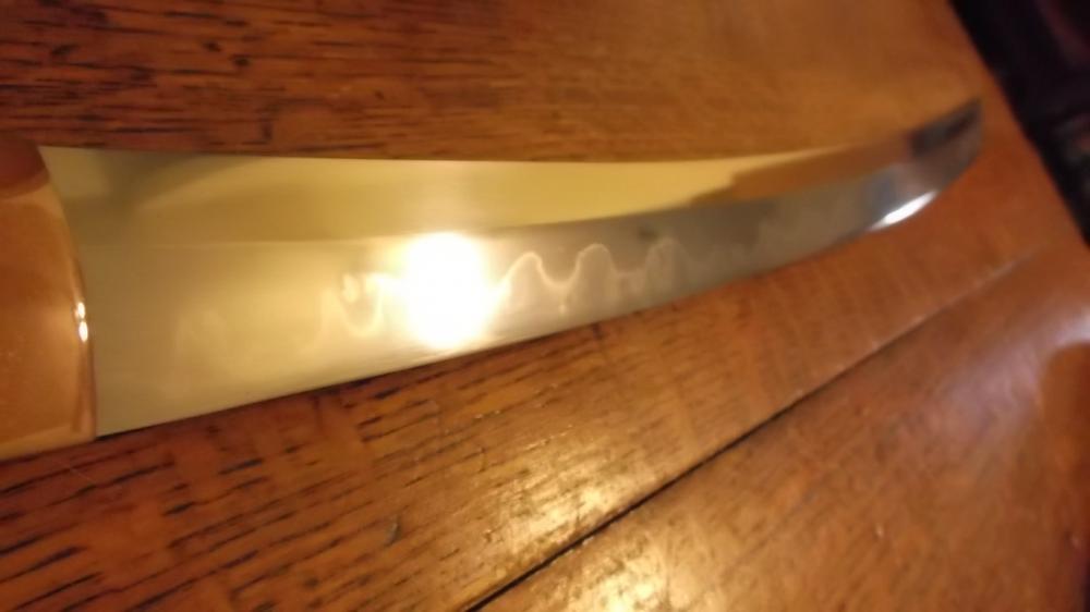

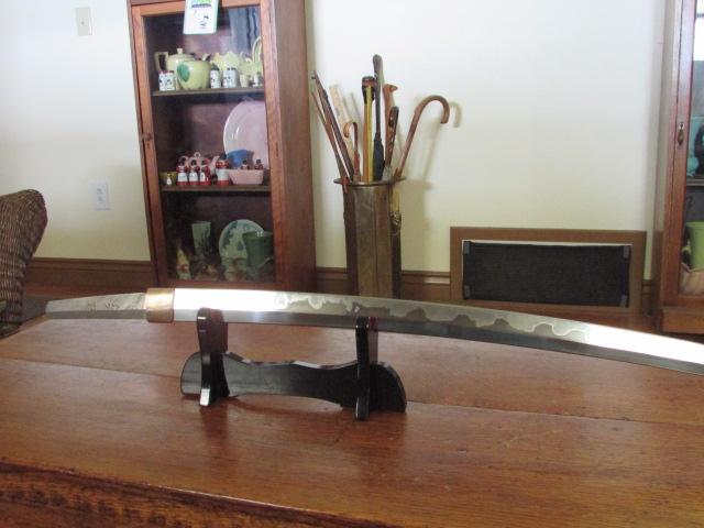

New Wakizashi and bronze habaki
Bubbasan

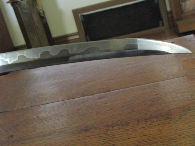

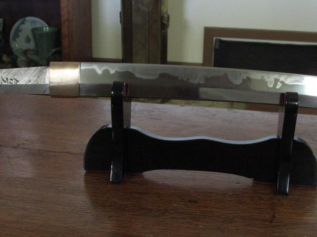

Are you using Aldo's 1075? That's a really nice hamon, and the sori is really visible - not something 1075 is known for although I know that some low manganese variants like Aldo's are shallow hardening enough to get these kind of results. Also, out of curiosity, what was you quench medium and temp?
-J
-J
Hello JW., Yes its Aldo's steel .I quenched in Parks 50 . Temp was right around 1475-1500 F Just a bit past non Magnetic. I did not use temp gauge I go by color and such. This particular 1075 was a special order from Aldo , pretty low in Manganese.
I really like the results I got . Although it's a crap shoot when doing traditional claying and quenching and luck is a factor . As I get older it seems I break fewer blades .
 Ordered some extra when I bought this steel, enough for 20- 25 blades. Guess I will be making some things from Aldos steel for a while.  He also has some really nice low mang. W-2 that is also very good for Hamon.    Aldo quite a guy , easy to deal with ....      James
I just go a nice hamon to show on his W2, it's a little trickier than just slapping some clay on it though. Normalization is the key with his W2 - 3 cycles, first around 1560 cooled to black, second around 1475 cooled to black and the last at around 1430 cooled to ambient temp. This is one of the reasons I might just have to throw another high temp electric oven together. :)
-J
Normalization and Polishing skills are the key to a vibrant Hamon . Tempering Japanese style is also key , as they use a flash temper that does not affect hamon
Heat is the biggest enemy of a good hamon.     regards    James

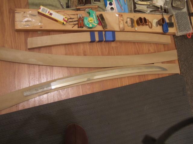

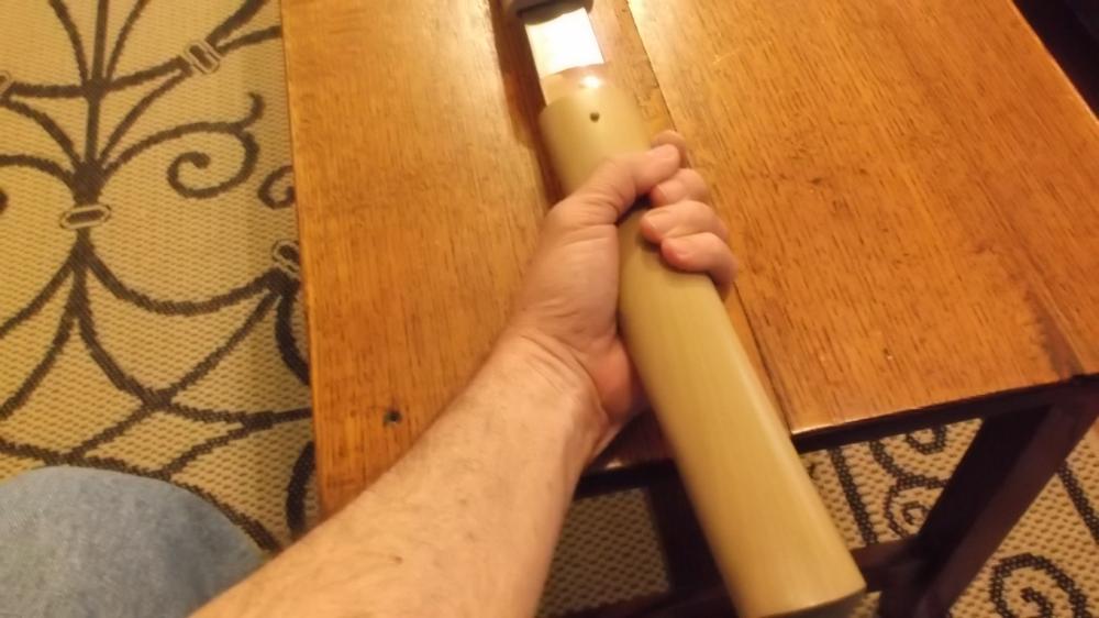

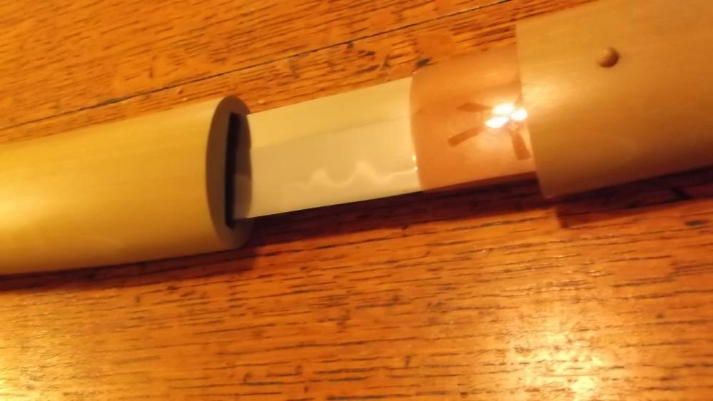

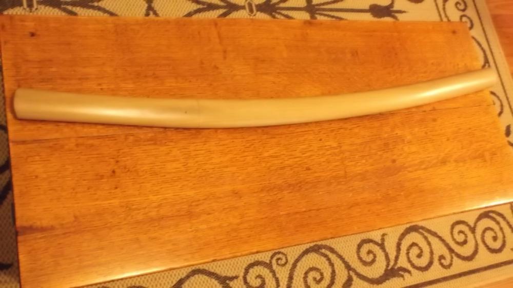

Here are pics of finished shirasaya. Turned out allright.  I normally don't make saya during warmer months because wood soaks up moisture and when it dries out saya can shrink
and make it rattle a little . This wood was dried for 7 years in Japan  .  I kept the wood inside where it is nice and dry so It didn't shrink.  Thanks for looking ........     Bubba
