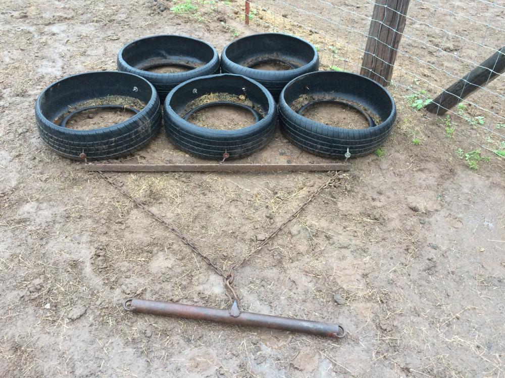

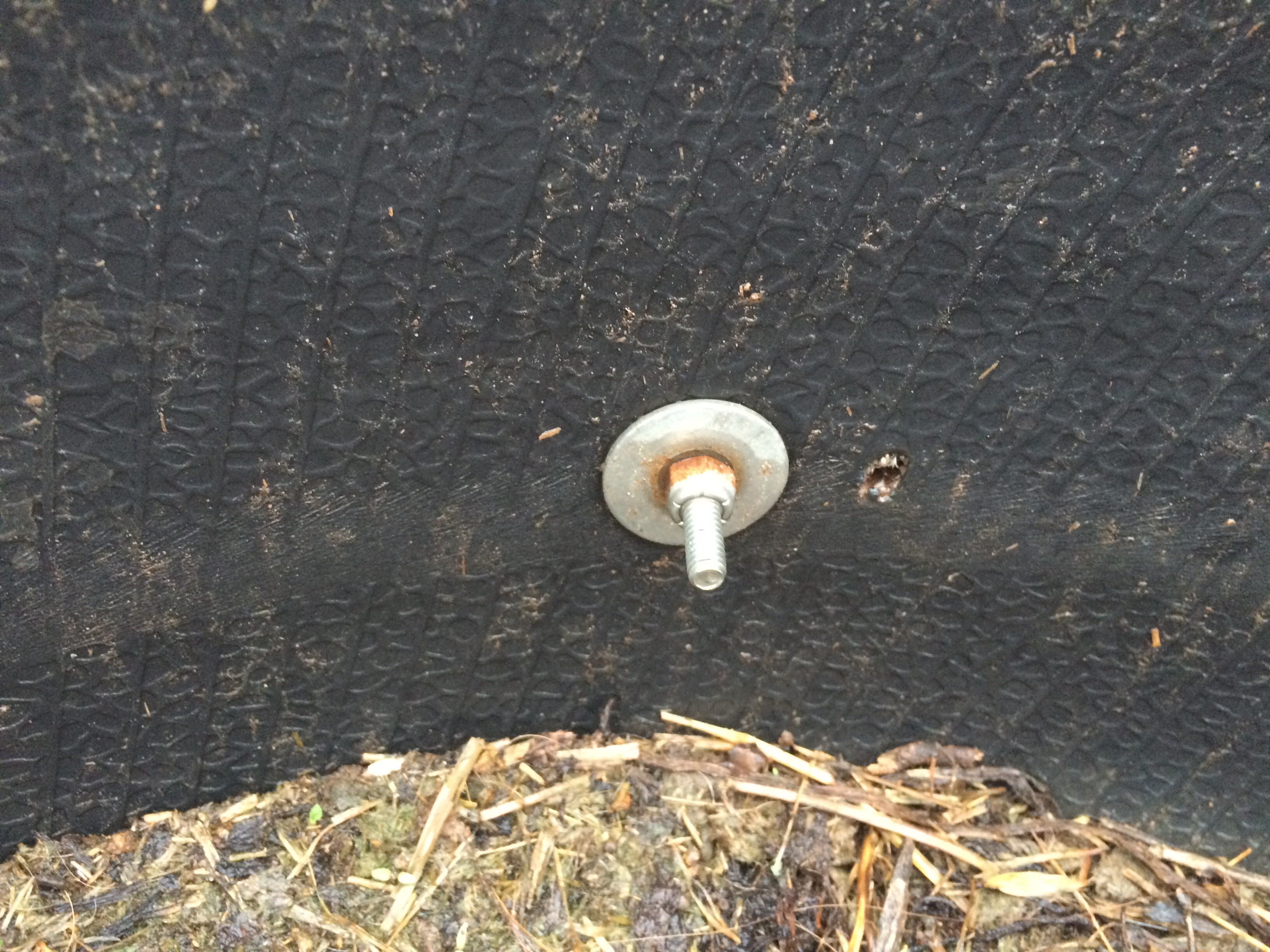

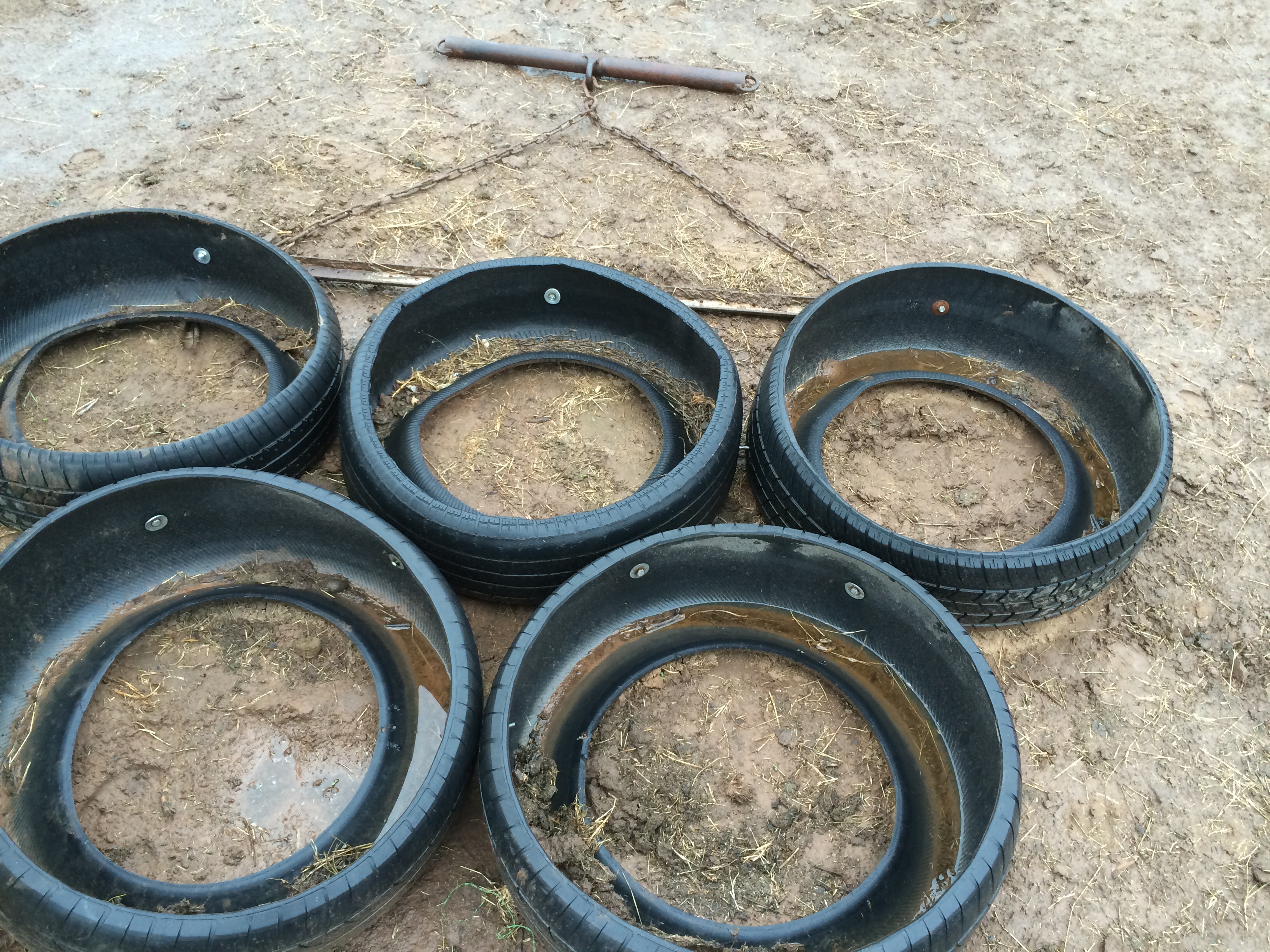

Sring stock , prefrably heat treated, operate at an angle so the debre formes furles between passes as aposed to being drug behing the rakes. Use a drag or finer tinened rake to finish ( old tires bolted to gether make an exilent drag, and can be mounted on a three point frame.

You can pull a wooden pallet or gang several together if you have a stronger pulling device.  You can pull a section of chain link fence secured in a frame. Pull at a slight angle to move the debris to one side and form a row or furrow. If you add a little weight it digs in and becomes more aggressive. Combine one or more devices if needed.
