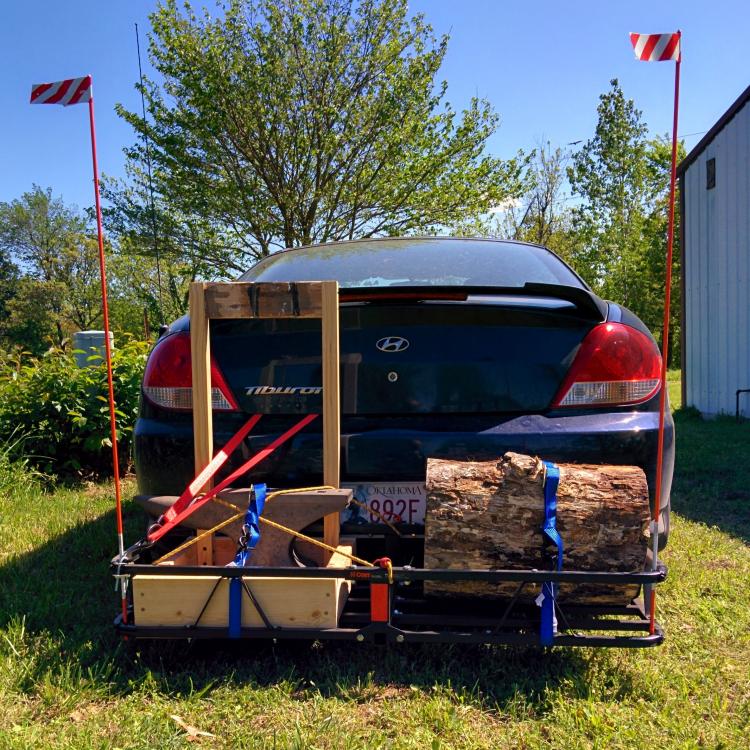

Just an old boys 2c..  If your tank blocks your tail lights your up for s ticket.. I would also consider the cars exhaust and heat..  Watch your backside..  A small trailer would be best.

Drove around with the anvil strapped on at about 70mph for about 45 mins while running errands today, just to see how warm the frame / wood / anvil got.  Temps were fine, but I'm probably going to add 3/4" plywood with steel flashing on the back just to make myself feel better.
Good tip on the taillight; I thought of the license plate but not the other.  With the ratchet straps attached to the child safety ISOFIX/LATCH points in the trunk and/or a balanced load, blocking the taillight shouldn't be a problem as the load will stay vertical.
Definitely will want to move to a trailer when I can find a good deal, but the rack was a ton cheaper.  Appreciate the advice!

Yup.  Carrier is 500lb limit, tongue weight is 200lb limit.
Carrier is 29lb, wood about 15lb.  50lb tank will never weigh more than 85-90 full.
So!  I'm pretty comfortable with 60+ pound margin.  Thanks for thinking of gotchas, I'm pretty new at this.
All in all, it's my least unsafe option.  If they made a trunk-top rack I definitely would have preferred that, though it would look even more insane than my current setup.
There's a small trailer for sale at a great price nearby, but I tapped out the Fun Budget through about July.
Yeah, I just need to get a truck when the wheels fall off this thing.
