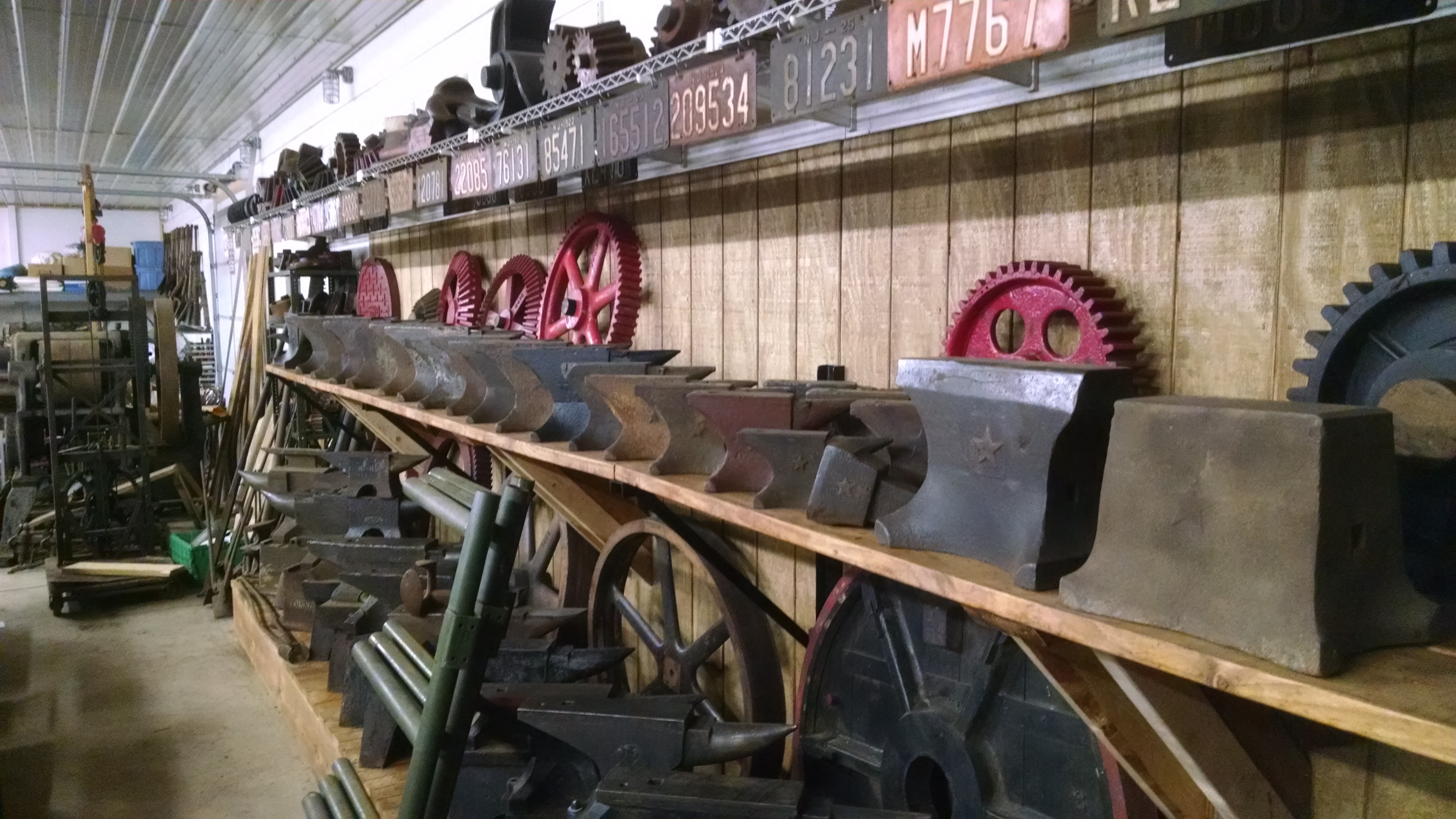

njanvilman Posted January 19, 2016 Author Share Posted January 19, 2016 The STAR anvils in the Fisher & Norris Factory Museum. First picture is the smallest and biggest in the collection. 20 lb on top, 240 lb on the bottom. Second picture is the complete line-up. 240 lb on the far end, to a STAR stake, STAR hornless, and a STAR sawmakers. 23 STAR anvils in the line. Quote Link to comment Share on other sites More sharing options...

njanvilman Posted September 1, 2018 Author Share Posted September 1, 2018 Soon to be added to the collection STAR #27. Second heaviest STAR anvil known. Top face dimension of 12" x 6 1/2". Quote Link to comment Share on other sites More sharing options...

njanvilman Posted November 2, 2021 Author Share Posted November 2, 2021 I have been neglectful for not posting more in this thread of American STAR anvils. A few updates: There are now 27 STAR anvils in the Fisher & Norris Factory Museum. The largest/heaviest STAR known is now here. It is a 420 lb. Sawmaker's anvil. The collection also has a 315 lb and 210 lb Sawmaker's anvils. These are very rare. Not many were made, and few survive. Also a rare piece is the Hornless STAR anvil, shown in the second photo to the left of the Sawmaker's. This is the only one I have ever encountered. It was bought on EBAY many years ago, and picked up only about 35 miles from me. The dates of this companies exitance have now been confirmed to be from 1852 to 1868. It closed because the principle owner retired. Fisher did not buy them out. 420 lb STAR on the left. 315 lb STAR on the right. 196 lb Hornless STAR on the left. 210 lb STAR Sawmaker's on the right. Quote Link to comment Share on other sites More sharing options...
