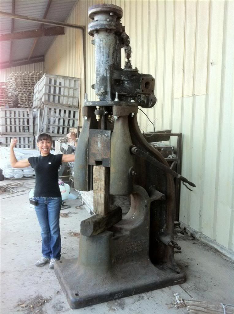

mrichard76 Posted September 7, 2011 Posted September 7, 2011 It seems as though every scrap yard in Baton Rouge knew about this place and was hounding the last owners on a weekly basis to let them get in there and haul them off. I really don't know how they would have got the 400 out of there though. We used an articulated front end loader with a 12,000 lb tipping load capacity to lift these and transport them to the lowboy trailer. The rear tires were just floating when picking up the frame for the 400! On top of that they were located behind a house in a subdivision. Makes me wonder how they got those hammers back there in the 50's. Quote

Tom Allyn Posted September 8, 2011 Posted September 8, 2011 Makes me wonder how they got those hammers back there in the 50's. There are some massive forklifts out there. When we were relocating one of Boeing's machine shops we used a 100,000 lb. capacity forklift to move many of the larger pieces of equipment. 100,000 lbs is the equivalent of 2 dump trucks filled with gravel. The thing looked like an army tank with a pair of mammoth tusks sticking out the front. The wheels were steel with solid rubber tires, about 36" high and 24" wide. Weights are stacked on the back to increase load capacity. And it could expand in the middle to push the counterweights further back from the forks for more leverage. It looked similar to this forklift.http://omegamorgan.c...y-moving-09.jpg Omega Morgan was our subcontractor for this work. They can move anything. One day they backed over one of our steel job boxes and flattened it like a paper sack! Amazing power in that machine. Quote

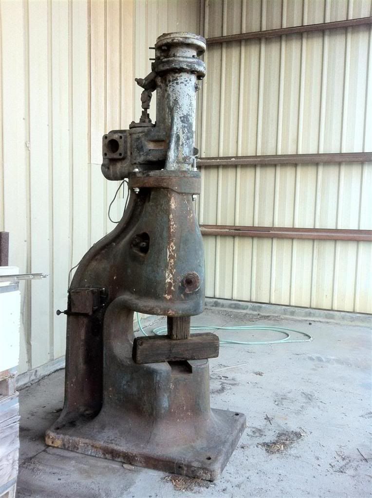

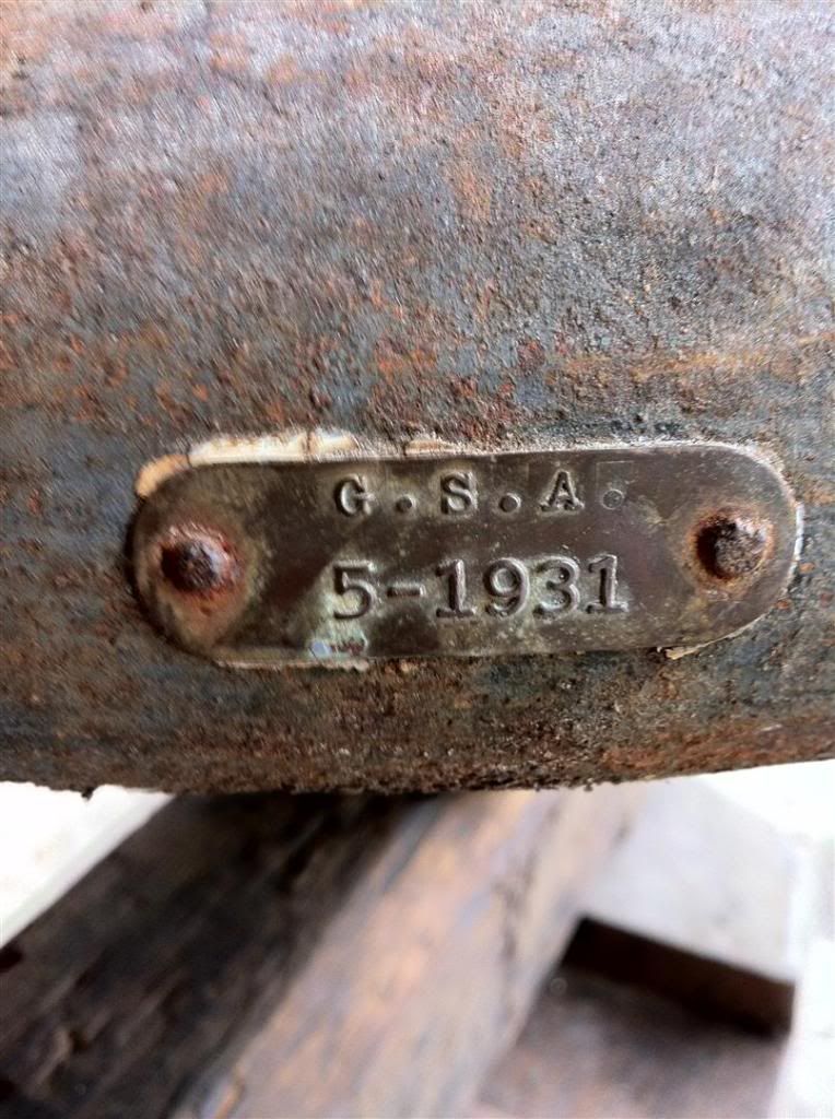

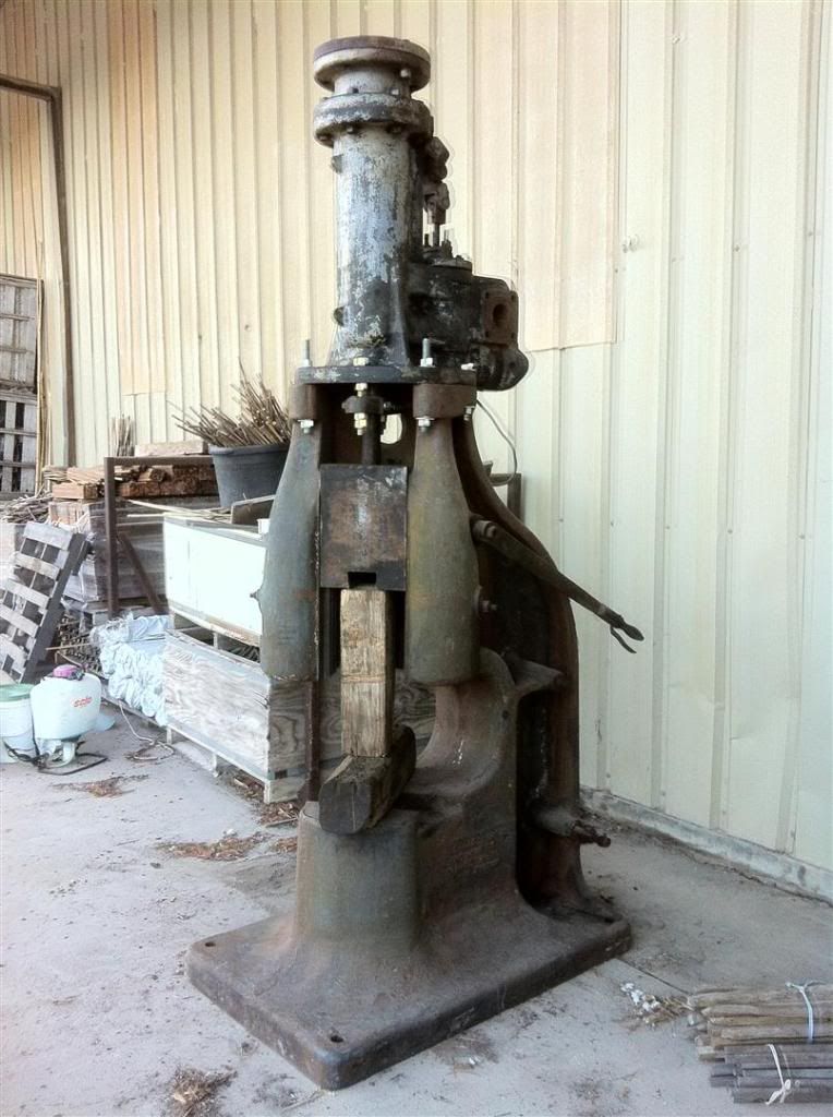

mrichard76 Posted November 21, 2011 Posted November 21, 2011 Got the cylinder/ram assembly mounted back on the frame. Opened up the cylinder and everything looks good inside with no broken rings or gouging. The frame was outside laying on its side for the last few decades after failed attempts of removal by the local scrappers. The whole upper assembly was kept under a carport out of the weather. I found a small brass plate on riveted on the frame marked G.S.A. 5-1931. Does anybody know what that might be? The General Services Administration was established in 1949... Quote
Dillon Sculpture Posted November 21, 2011 Posted November 21, 2011 The tag is probably inventory# form the shop that owned it, my Bradley has three different ones. You have the original bolts for the top? The all-thread would be fine for a test fire but I would'nt trust em for for on hammering. I really like that HAMMER! Quote
mrichard76 Posted November 22, 2011 Posted November 22, 2011 I have all the originals but the got really screwed up by whoever disassembled the hammer years ago. The all thread is just temporarily holding the upper assembly in place - not under power :-)) I'll be using 1" grade 8's for the permanent ones. I love this hammer too! Just hope the compressor and reservoir can handle the hammer! Quote

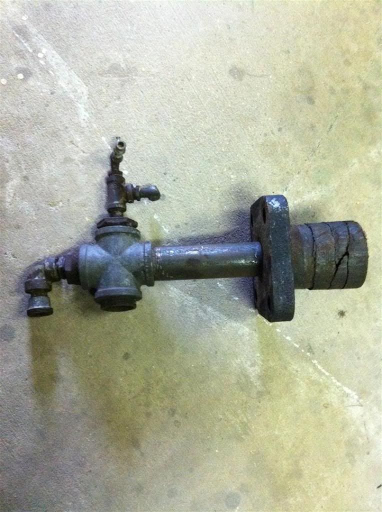

mrichard76 Posted November 23, 2011 Posted November 23, 2011 Here's a picture of the inlet plumbing if this can tell anything. Quote
Dillon Sculpture Posted November 24, 2011 Posted November 24, 2011 Probably steam, check clearance of the control valve. The large port out the back of the inlet goes to the safety cap, sends pressure to the top when you top out the piston. The other two could have been to warm the dies, blow away scale or remove water from the line. Quote
