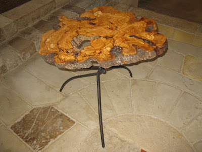

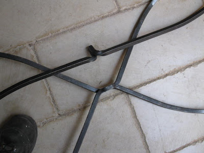

That's a interesting joint design. Thanks for showing us that. The wood is great too. Never saw a tenon made like that.
Guess you would anchor, screw the top of the table to the iron. ???
Shouldn't That hold it in place?
THE BASIC IDIA IS TO PUT THE TABLE APPART AND INSYOLE IN OTHER PLACE IF NEEDED.
IN THE PHOTOS ONE DO NOT SEE THE FINISHED PRODUCE BUT THE QUESTION WAS ASKED AND HERE IS THE ANSWER.
ON THE UPPER PART OF THE LEG A SMALL PLAT WITH A SLOT IS WELDED. ON THE WOODEN OLIVE PLAT TOP ON THE BOTTOM SIDE 3 GOOD WOOD SCREWS WITH A NICE HEAD ARE SCREWED IN TO A CERTAIN DEPTH ,THEN WHEN TUREN OVER THE WOODEN SCREWS HEAD IS GOING INTO THE SLOT AND THEN TURNING A BIT LIKE IN THE BAYONET SYSTEM ( like holding the lence in the camera ) THE TOP IS HOLDING THE WHOLE INSTLATION FRO FALLING APPART. NO NEED TO PUT A SCREW OR A PIN IN THE TENNON JOINT!!!
HOPE THINGS ARE CLEAR FOR NOW
HOFI
Great explaination on how the top gets mounted. And a great idea too, by doing it That way. Nice lines, and love the tenon joint in the center.
Truely learn something from all your post.
Thanks for sharing.
