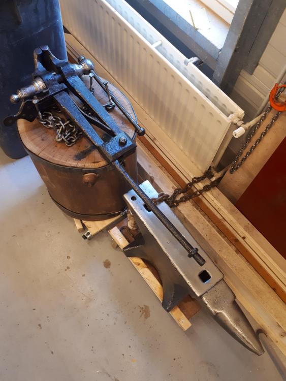

  5. Stumbled upon this gem of a post vise on "marketplace". Sold by a friendly lady, dealing in all sorts of 'vintage knick knack's' 66#, jaws 4,8" (12cm), few minor marks from use on the jaws, spindle and box as if they were made only yesterday! Only the nut on the hinge bolt (?), I'm not sure if it's original because it's hexagonal and not square. However: the amount of rust and erosion suggests that it is. I did some digging and was suprised how much it looks like a PW, even in detail. No markings to be found, so there is no way to be 100% sure. What also made me wonder is how many 'look-a-likes' that were made by other manufacturers. But who's complaining? Certainly not me!! *widegrin* (The 'nice' photo is taken from the ad itself) ps: and please forgive my 'dunglish'...
  6. Well, after a lot of cleaning, wire brushing, electrolysis, more wire brushing and many hours of reading I am happy to declare the mystery solved! Not a Mousehole and not an Isaac Hill. It's an Attwood - Stourbridge! -The weight and makers markings are stamped on the correct sides: weight left, the rest on the right side. -There is also an inspector's mark on the front of the base, in the middle, under the horn. -part of the name ('OOD') is still visible, also part of the word 'warranted' ('ANTE'). Year of production estimated between 1830 and 1850 based on the bulging of the pritchel hole. So, there you have it. Not a mysterious 'Jane Doe' anymore. This beautifull lady now has a name AND a history! Only one thing left to do: build her a glass showcase... (just kidding)

  12. Hi, Dax. That's a very good looking anvil! It looks to me that one pritchel is drilled and the other is driven... if that's correct she will be almost two centuries old. Have you tried wire brushing the markings on the sides? I took things even one step further by cleaning my anvil using electrolysis... which led to an 'almost' 100% positive identification! Almost because I'm still comparing foto's on the web with the markings on my own anvil.... There is loads of info on cleaning anvils out there but be gentle: to much 'cleaning' can do serious harm to the id-markings that withstood the test of time! Good luck and please share your findings with us!
  13. Thank you, Neil. You're right, I'll absolutely enjoy using it. However: knowing her history and where she came from will make a big difference on the experience. To me it wil add to the magic, otherwise it will be 'just an anvil'... if you know what I mean.
  14. Don't worry, I didn't grind anything. Just a soft wire brush on a powerdrill. Previous owner only polished the face and put some oil on the body. No sighns of welding either.
  15. Now I'll stop spamming you with pic's, I promise! (unless you want more... -lol-)
