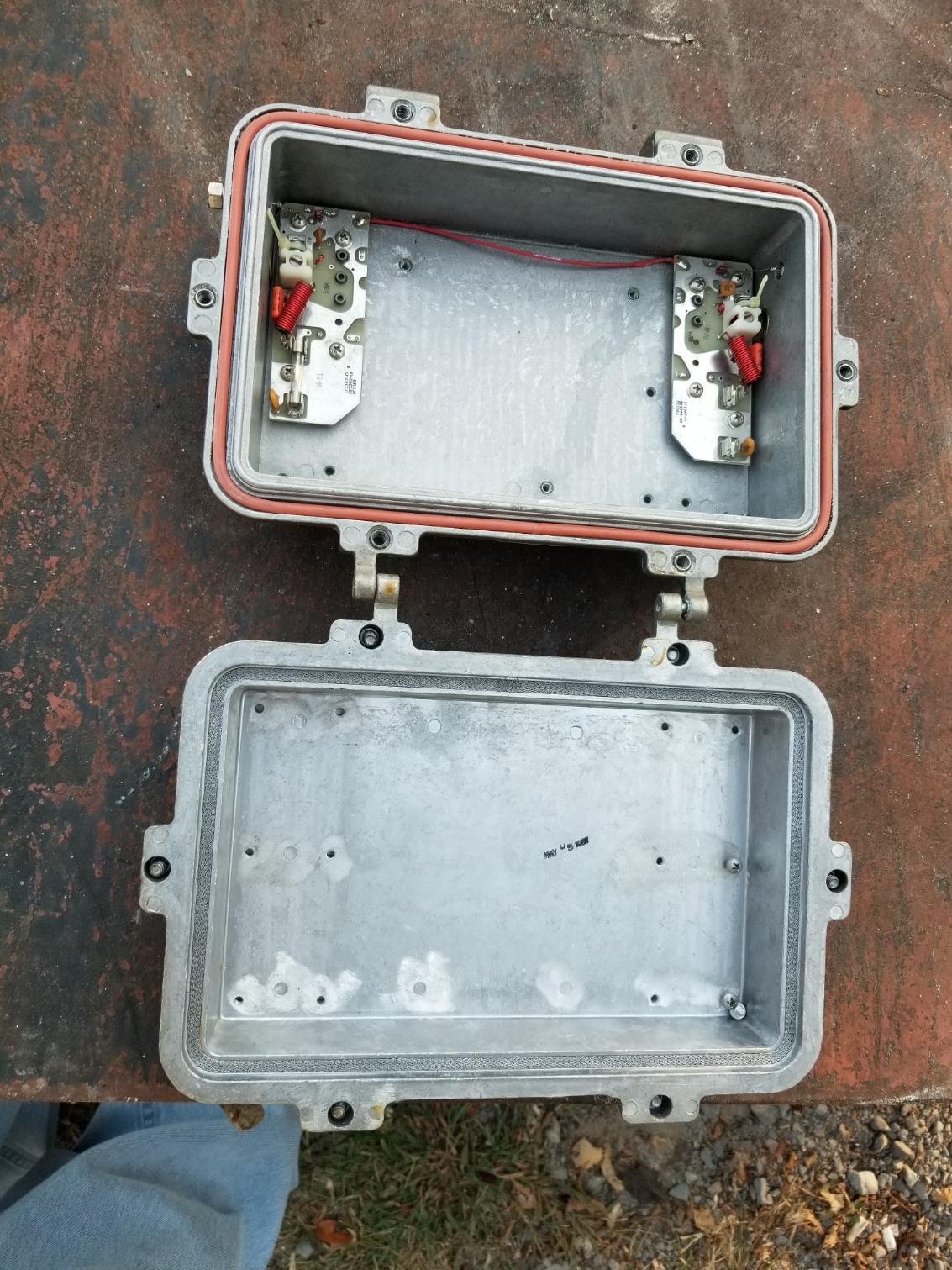

What are cable company amp cases made of?
br5409 replied to br5409's topic in Smelting, Melting, Foundry, and Casting
Vinegar=no reaction. Fire with scrape test = no reaction. CLR = no reaction with shavings(scrape). -
I will try the acid test also. Thank you. -
Thanks to hills over at the scrapmetal forum for this. Says to use the burn test like many of you said. -
total weight: 6.77lb dimensions: 10"x13"x5" not got around to scrape test yet. Another person said I could use copper sulfate and test it also. -
I had a guy that owns a scrap yard tell me that he thinks that it is cast aluminum. He did not know if it had any magnesium or zinc in it though. I will try the "scrape" test next. Thank you! -
Closest BIG scrap yard to me is SA Recycling or PSC metals. I will have to call and see if they have a XRF gun. Thanks guys. If anyone knows anything or a cheap way to find out, please respond below. I pecked it with a grinder and no sparks. -
What are cable company amp cases made of? Cast aluminum? Magnet does not stick. These are old C-core amplifier cases. I think they are cast aluminum? I have not done a spark test yet. Just wondering if any of you guys have messed with them. I would like to melt them down if they are aluminum and do not have any magnesium in them.
