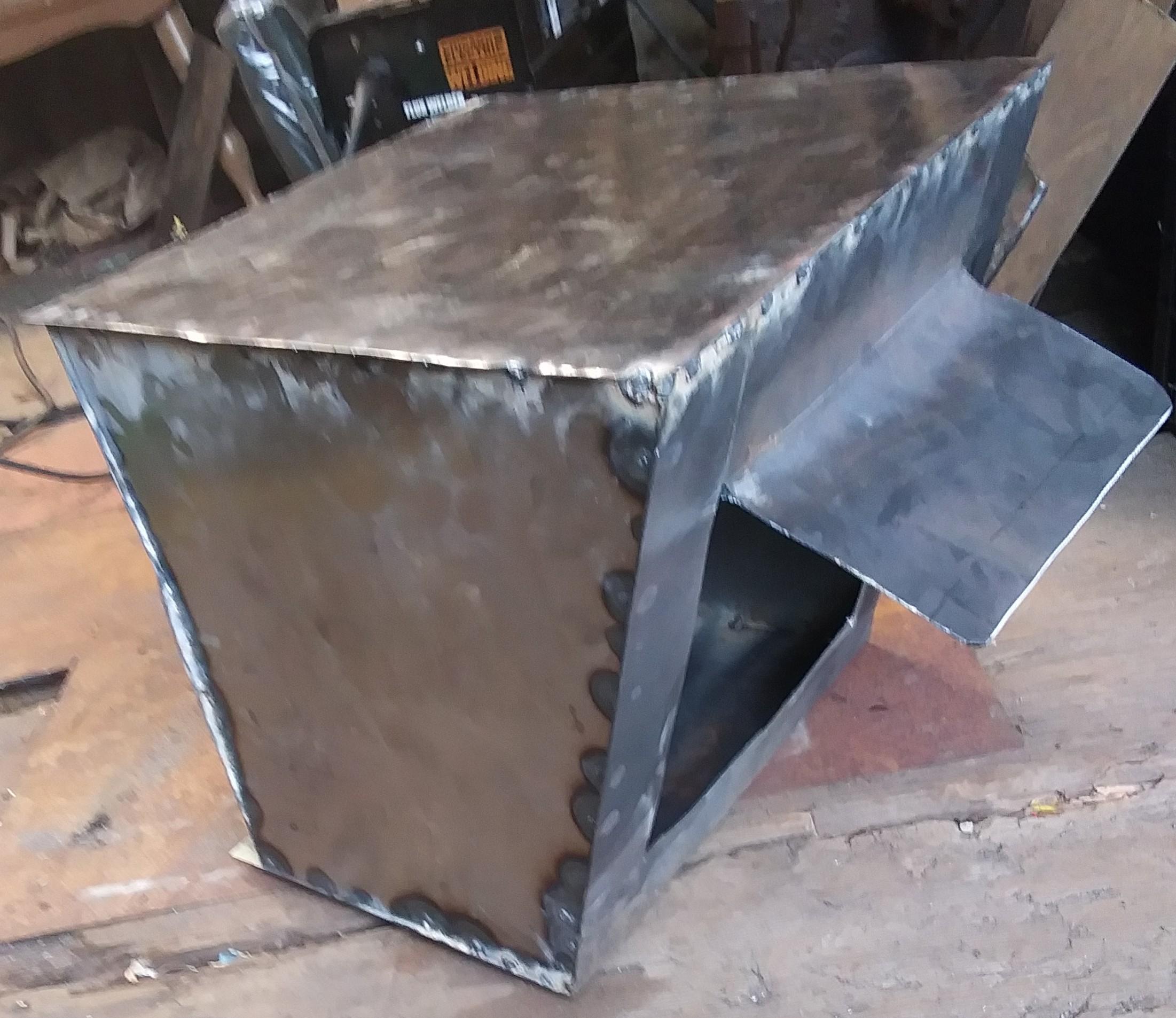

  16. Made a super sucker flue for the forge yesterday. Cutting the opening for my stove pipe and forging its ring today. My last one was made from a tin bucket cut close to one of these. It rusted over the winter and neglect from my being laid up from the crash. Can't wait to try it out!
