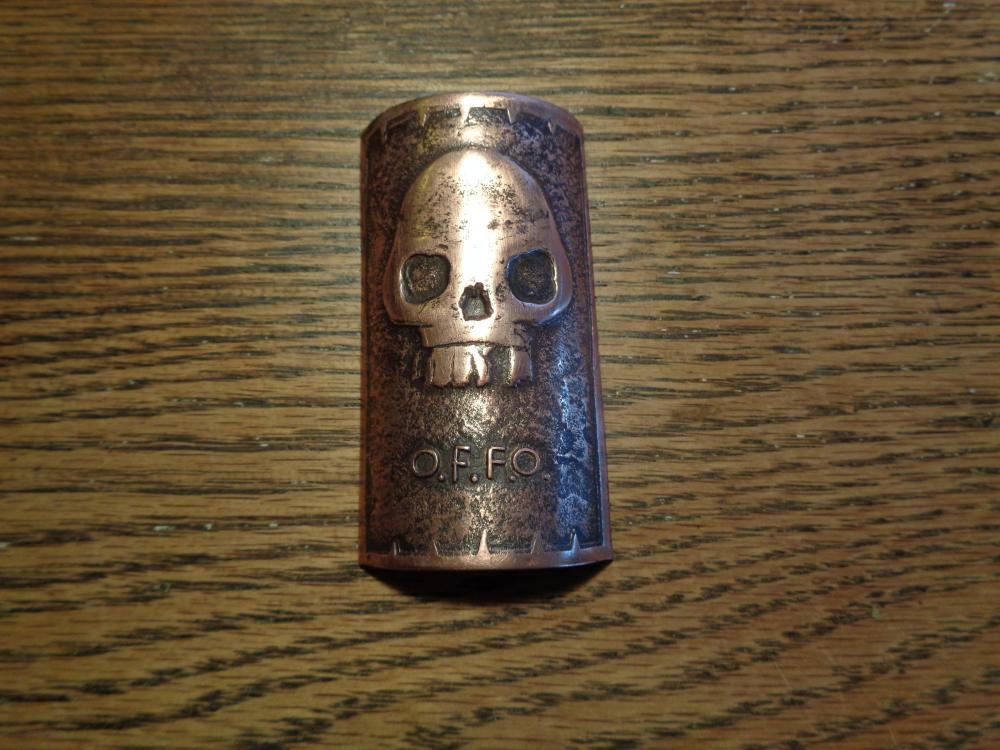

  11. The badge is hot forged into a die. The rough texture is from the rusty flat bar I made the die from. I was motivated to join your forum after looking at treadle hammer tooling. Thought I might blunder around that section, and see if I can't embarrass myself.Thanks. Sorry if my intro is a bit much.
  12. The mushroom knife is for foraging. Some mushrooms are best identified if you can get to the bottom of them. Hence the folding trowel. Some 'shrooms leak a milky substance when cut. Also used for identification. If you're going to eat them is best to know what you've collected. My blades are made, start to finish with a hammer, and just a bit of filing. No grinders. Here is a pic of the lock-back, and a copper head badge. O.F.F.O. stands for Others Forever, Forever Others. Oh, I have both Coal fired forge and propane. Mostly I use propane for the convenience and cleanliness, but a coal fire is hotter than my propane unit. I've been using 'Elkhorn Smithing coal' from Lazzari fuels in South San Francisco. It is the best smithing coal I have encountered. Super hot, really clean, and very little ash or clinker. It's wonderful stuff.
