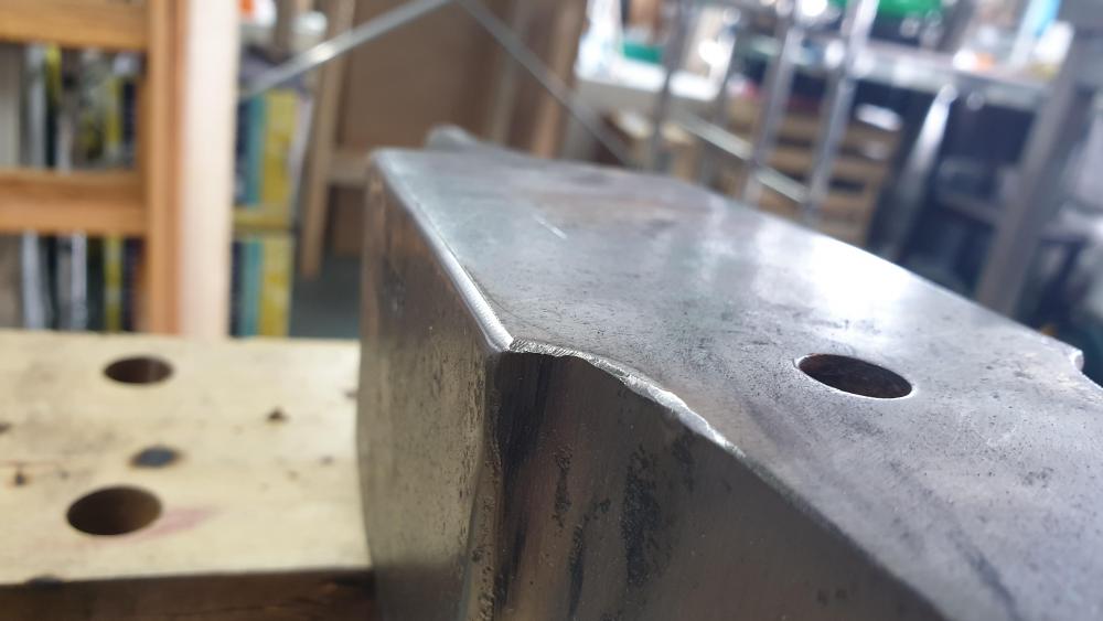

  3. Made the radius on my anvil today, didn't want to overdo it without getting an opinion, easier to redo that to undo. What do you think? Said by side comparison. Also got my first touch mark of many to come today funny how it's so hot it doesn't even hurt, everything just dies. Oh well, tools of the trade I guess.
  4. Oh, on the way home is was trying to figure out how to keep that little edge from happening, now I understand. Thing is, my anvil edges are in mint condition so I'll have to figure something out hehe Thank you so much frosty, your help has been invaluable, I wouldn't have managed all of that on my own, specially with no one to help around these parts.
