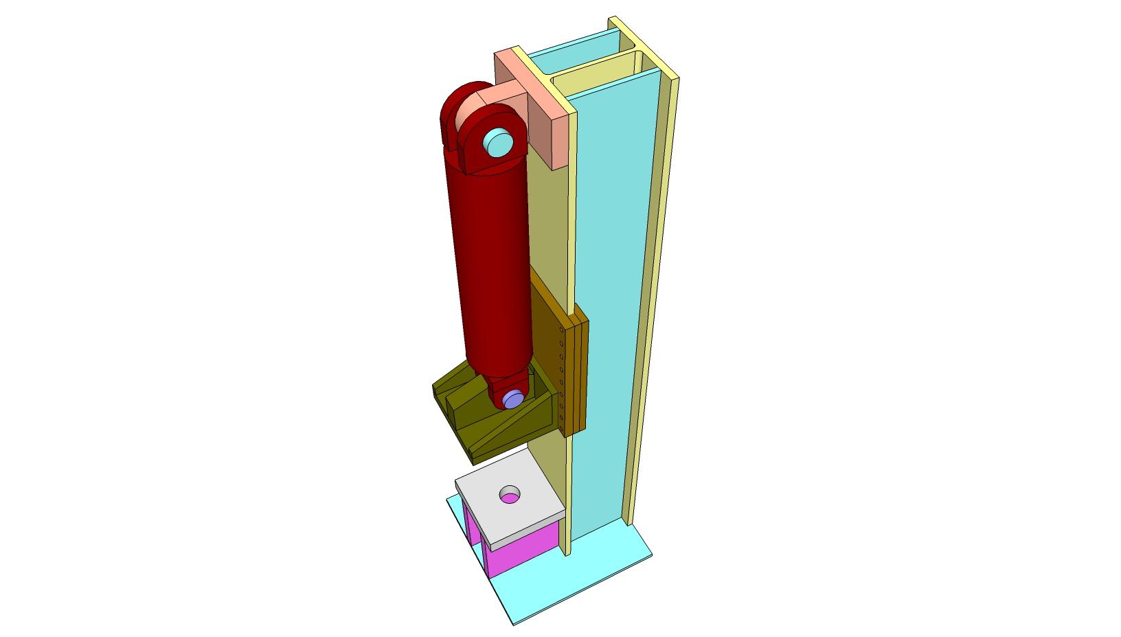

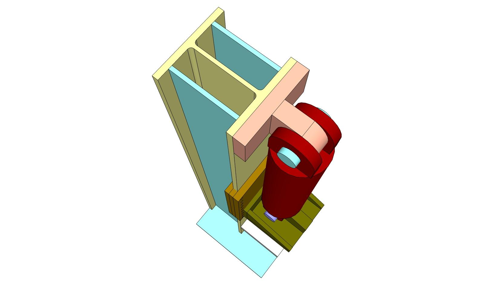

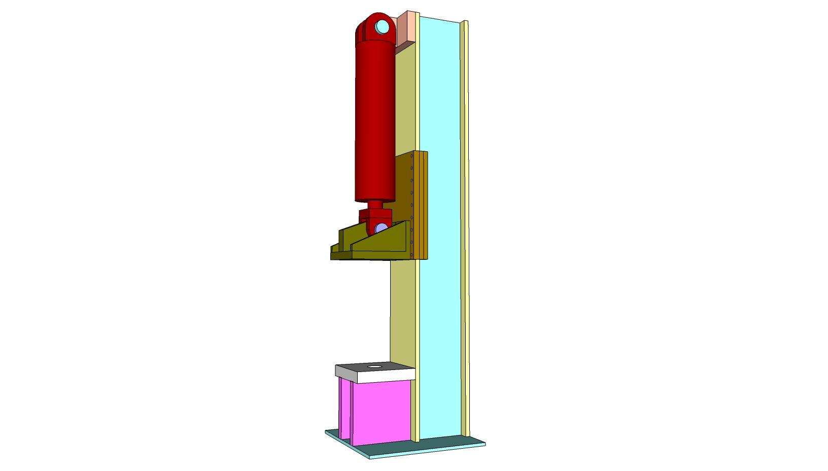

I've made a design for a 20 ton forging forging press that i'm planning on building. the main beam will be an HE-b 200 I-beam that will be stuffend up with 2 10mm thick plates in the I-section to prevent torsion in the I-beam. total height will be 1400mm and the usable stroke is 350mm. i'm no quite sure how i'm going to attach the dies but i'm leaning towards drilling and tapping holes. any idea's, advice and pitfalls would be nice thanks
