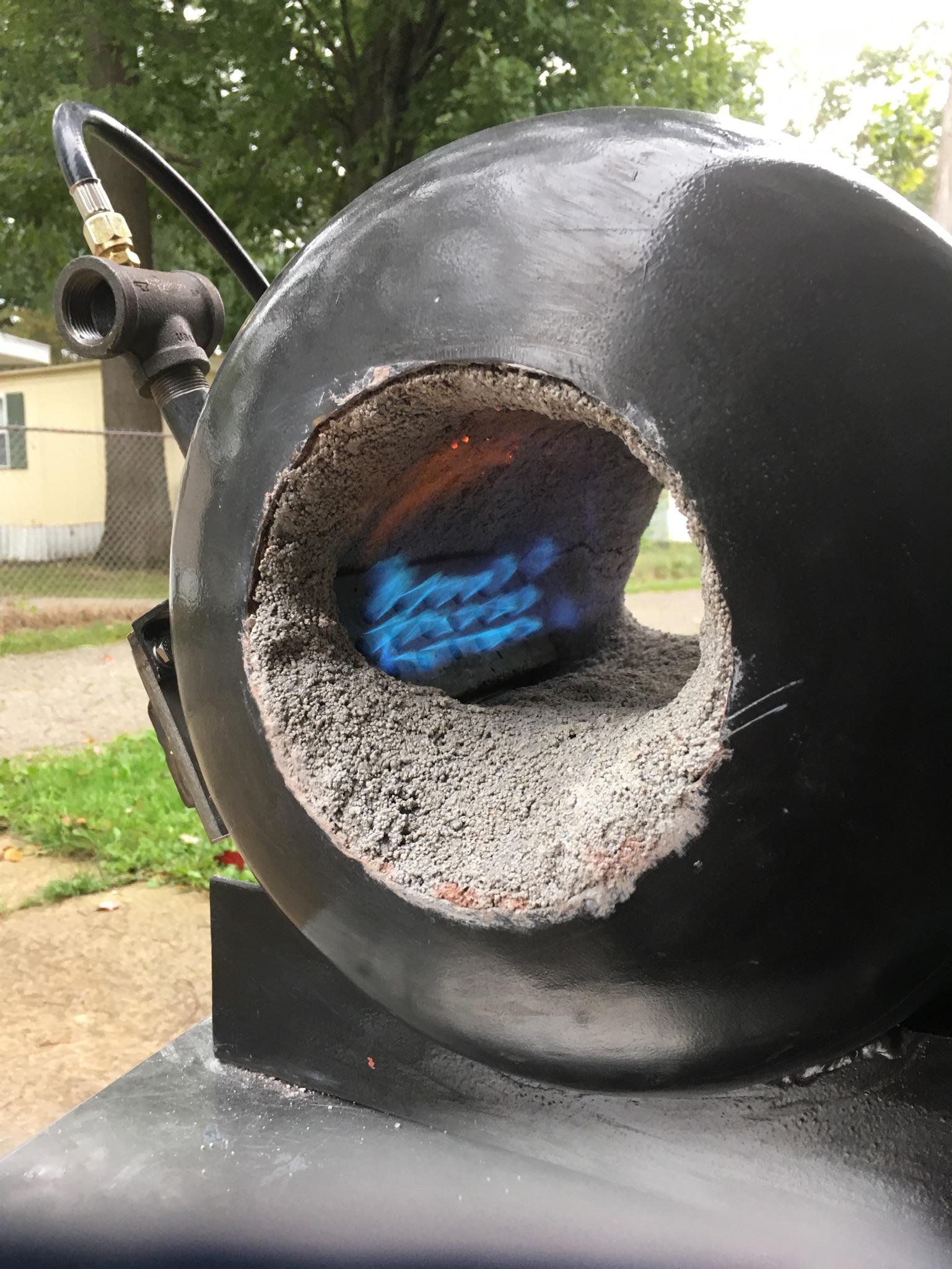

  7. Missou - yes. And as for annoying music, it would mask how quiet the ribbon burner, built pretty much to your specs, ran. To tell the truth, People I work with tell me I'm clever. I make a living as a Machine Maintenance Mechanic. You can read that as Jack of all trades, Master of none. But it is only because of the brain trust I found on this forum that I was able to accomplish the build. Many thanks to all contributors!!!

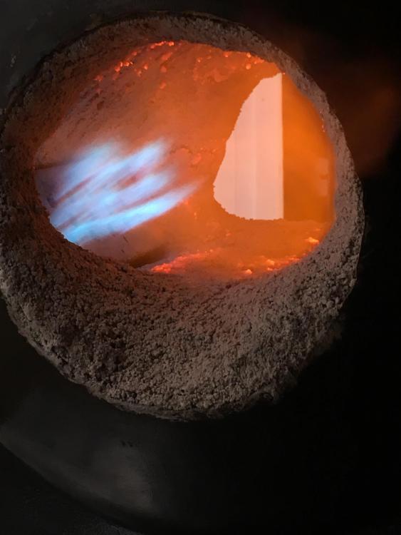

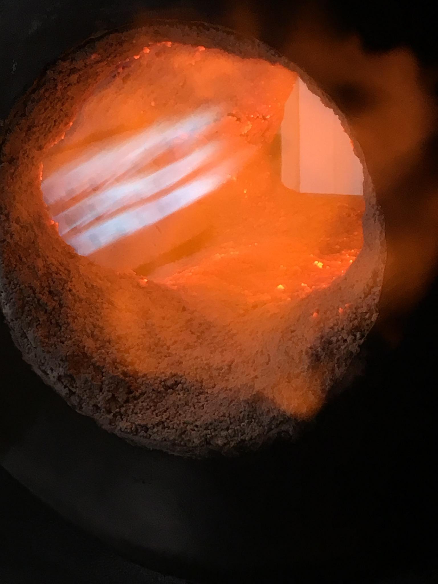

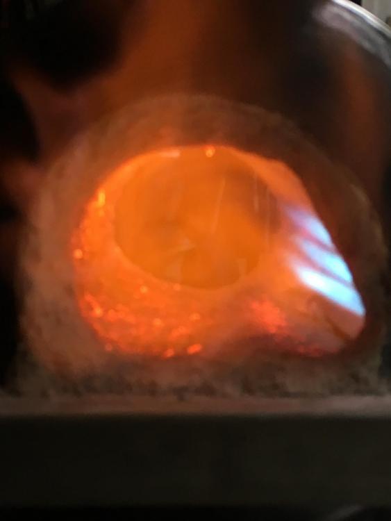

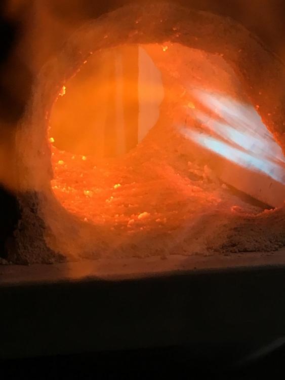

  8. I know youtube is not necessarily respected here, but I figured out I could post the video to youtube and link it here. Check out the link below and let me know what you think. I welcome ANY feedback. It's how we learn. Swirl
  9. Thanks, Buzzkill. it has an awesome "swirl". If there was some way to post a short video, I'd show one that I didn't know my phone would do. But I haven't figured out how. I hit "Slo-Mo" and it took a video that runs less than a minute. When I viewed it, it has about a second at either end of normal speed but the rest of it shows the burn in slow motion. I'm hoping someone who views this thread will give me a little help on posting a short vid.

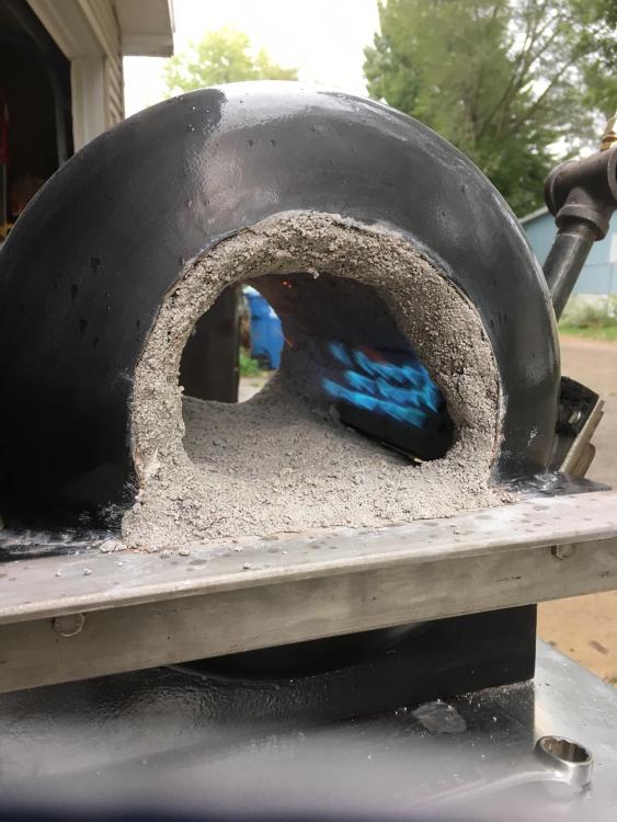

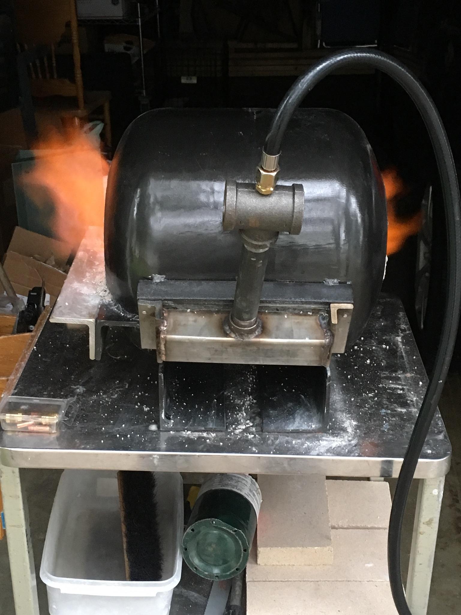

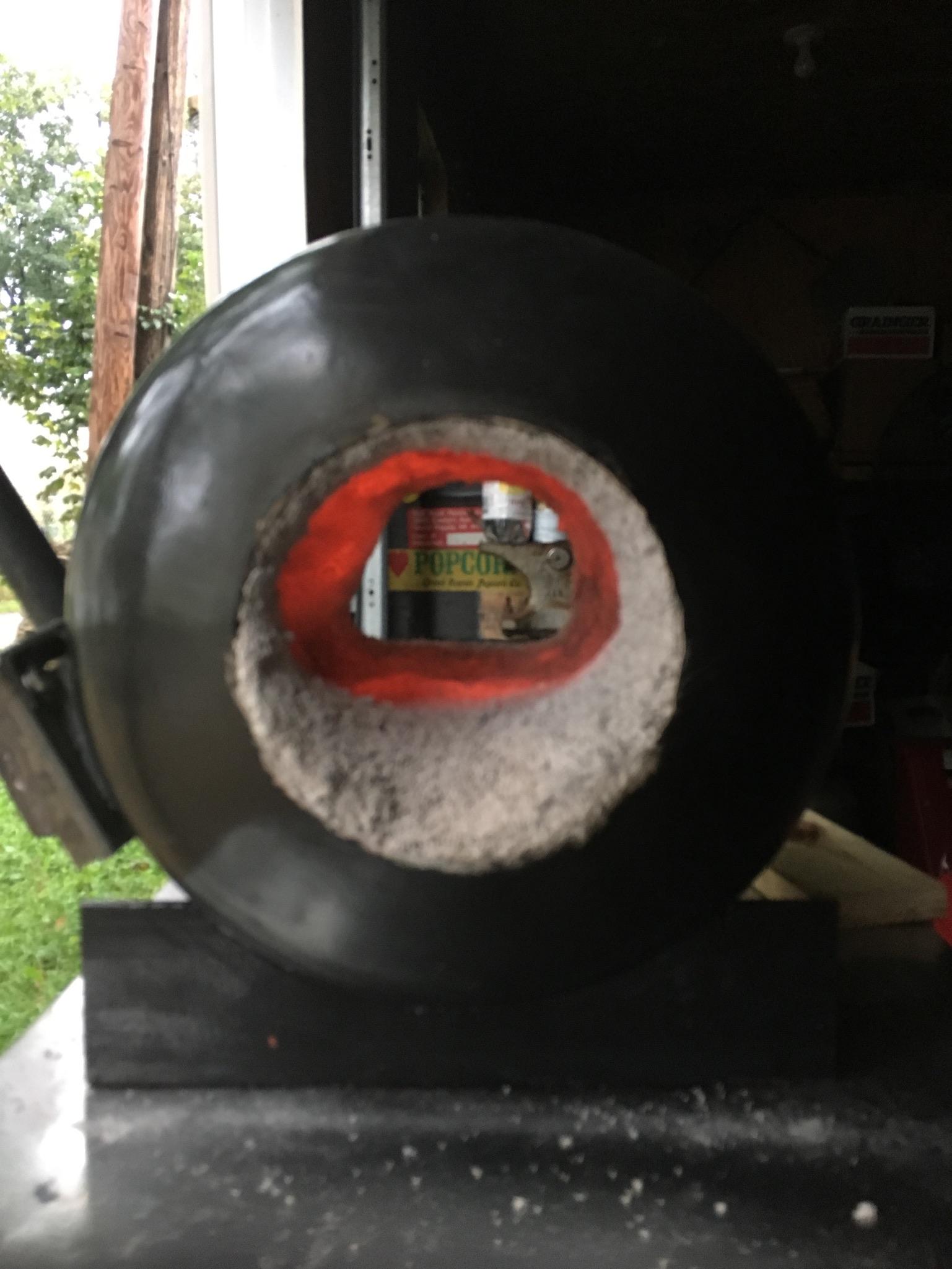

    I don’t want to add any personal pages to this already long thread, but ya’all are invited to check out my first forge: My First Build - completed 10-2018 A special shout-out of thanks to Frosty, Mikey, Wayne, and everyone for all the great advice. Truly could NOT have done it without you. THANKS

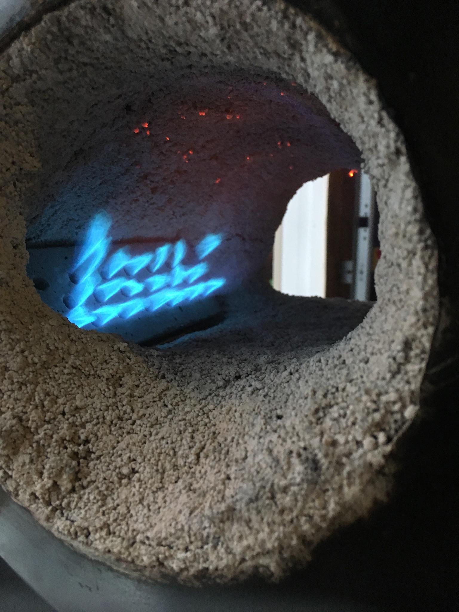

  11. And a few photos/videos of it all fired up I do have a few video clips of it running, but I can’t figure out how to attach video here. It has a very nice “swirl”, which is what I was after when I mounted the Narb where and in the orientation to the chamber that I did. Overall, I’m pretty happy with it. It seems, though, that forges are a lot like cigarettes. After you’ve been tempted to start your first one, if you’re not actually building one, you’re thinking of the next one. I’m already looking at a Freon tank that’s about 2/3 the size of this one and thinking about my leftover build supplies . .

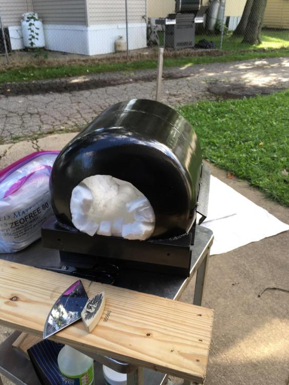

  12. I used Rustoleum black “hammered” finish paint, because it seemed fitting, but dang! It turned out looking good, too! As you’ll note in the background, I was properly su”pug”vised throughout the entire build

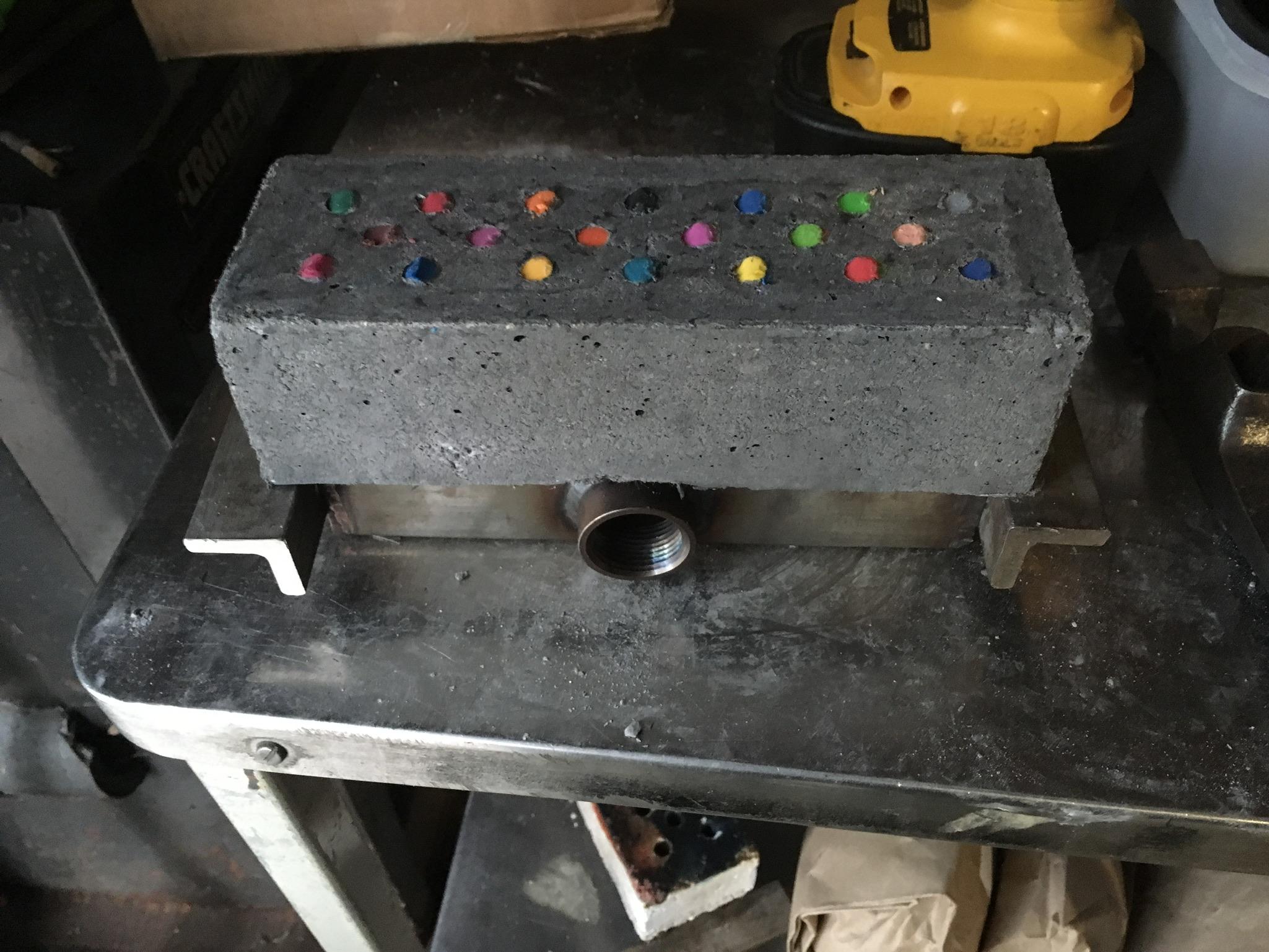

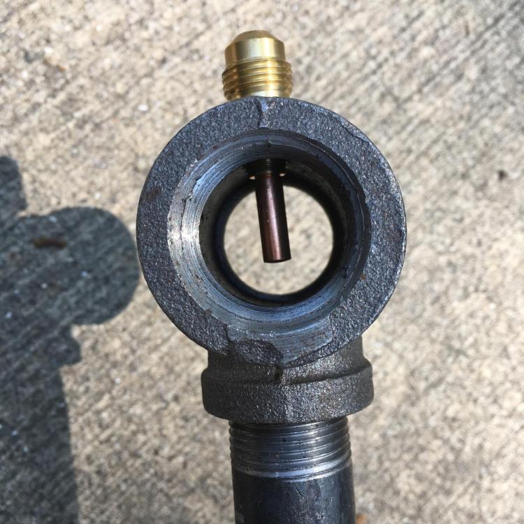

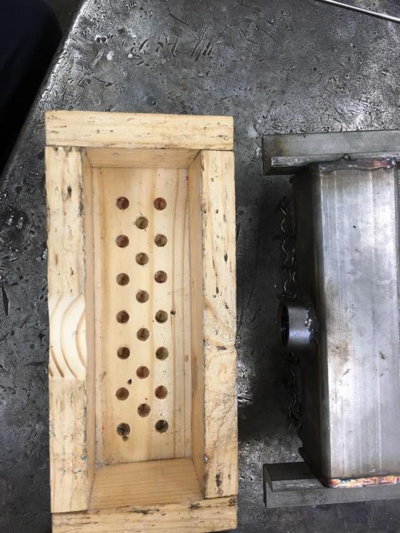

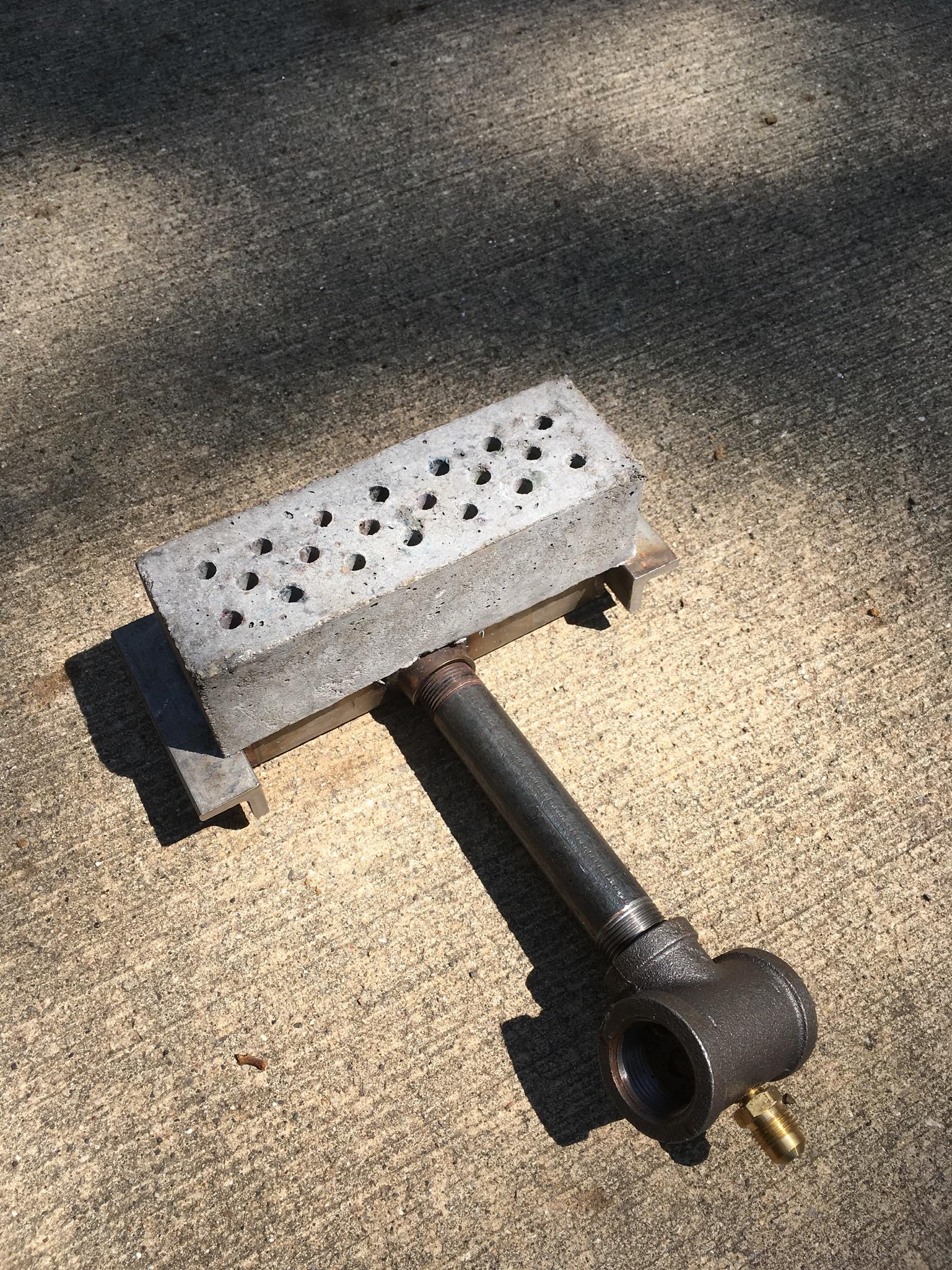

  13. It’s taken a while, but my forge build is finally complete bar the IR reflective coating. Many thanks to all who gave advice. I started by building a naturally Aspirated ribbon burner on a 3/4” Frosty T-burner mixer. I built the frame for the castable from scrap wood and put shipping tape, the type used to tape boxes shut, on what would become the interior of the form before assembling it, punching holes in each crayon socket and coating it with Crisco (butter flavored, for the curious) before inserting the crayons. This combination worked like a dream as a release agent. I highly recommend it. The mix chamber was built from 2X2 square tubing, 1-1/2 inch shorter than the length of the flat portion of the shell. I just used a couple of pieces of hardwood to vibrate the Mizzou I used for the port section, but that rocked quite well. I could only push the reinforcing wire about halfway down into it, but by vibrating (hitting) it with the sticks, it settled in nicely and when the form was removed, no voids. I had greased the crayons, and tried to pull them, but broke all but one or two . So I drilled them out with three progressively larger bits and pushed the last little bit out with the flat end of a bit one size smaller than the holes. The hardest part was getting the crayon residue out of the air mix chamber. next it was time to get the paint off the shell and attach legs. I used some warehouse rack angle iron that had been scrapped off of a rack that lost an argument with a Hilo at work (no casualties other than the one piece of steel), cutting a semicircle the size of the forges O.D. out of one side of angle on each “leg” and welding them to the shell. A similar method was used to attach a work support piece to the front and a straight piece of stainless angle was welded on for a burner mount and it was time to paint!

    I actually rigidized and cured both layers of Cerawool one at a time with Zeofree 80 as I laid them. I was kinda surprised that a 5 minute cure with a small propane torch (1 lb canister type) not only cured it but turned the wool back to white. the food coloring burnt right out.

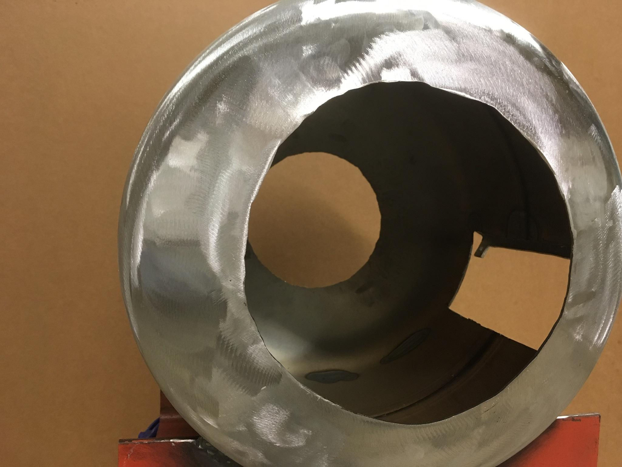

    OK, so time for a couple of "Show your ignorance" questions for the more experienced Forge Tipplers and Tricksters. I've built the shell (Turkey) and insulated it with Ceramic wool (Duck) of my Turducken forge and it's time to stuff in the refractory (Chicken). How in the heck do I line it with a cement-like substance 360 degrees against gravity? I thought maybe turn it on end (sitting on one of the openings) and just apply refractory from the bottom end up. Would this work? Or is it possible to coat the bottom 1/2 and let it dry, turn it over and do the other 1/2, and have a durable seal between them? Those are the first two ideas I came up with. Would either of them work? Or is there some other obvious technique I'm missing?

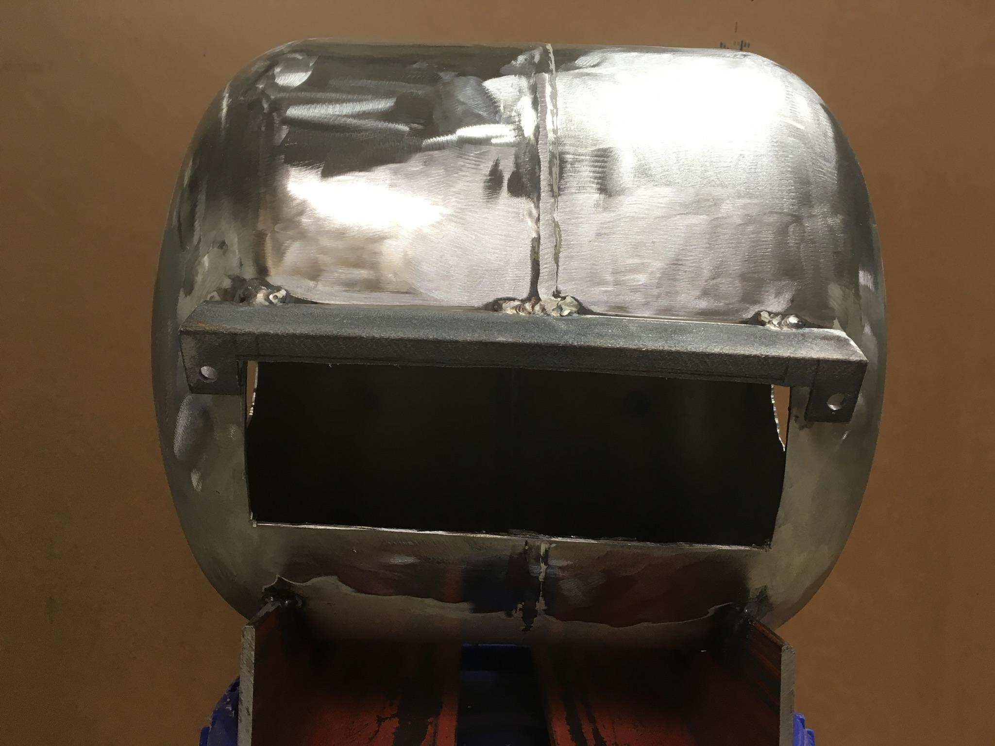

  19. So the Narb is complete and burning like a champ. I cut the burner port in the shell and just have to figure out how I want to attach it to the shell at the angle I want and Ill be ready to insulate, cast a lining , and start bragging. Pics as I proceed. Lots going on so the build has to be fit in around the edges, but I'm having a lot of fun and learning a lot..

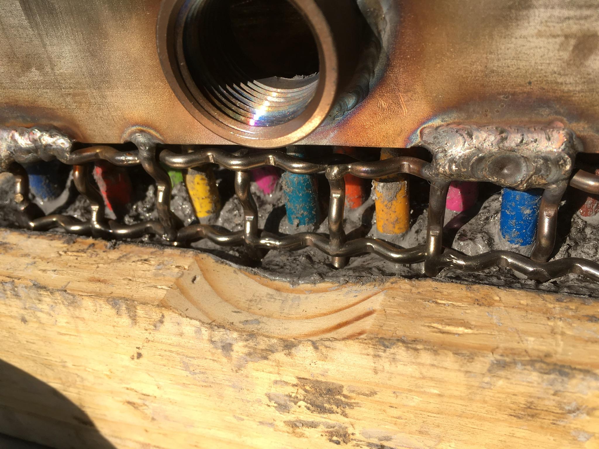

  23. Would you expect the same to hold true for Mizzou? It arrived this week and I have the next couple of days off, so if the missus doesn't have too many chores lined up, I may get around to casting the replacement soon. Daguy I actually went with an 1/8" woven stainless. after welding all the cross sections in place, I cut it and welded it in line with the plenum walls. I built my form so the finished burner would be about 1/4" larger all around than the plenum. Daguy
  24. Yeah, that's exactly what I did. I realized at the time it was a dicey move, but I just didn't have enough of the other castable to fill the mold, and I'd already used up what I had. I tried to poke the second material into the first to avoid a straight layering of different properties, but I suspect more disaster awaits this ribbon. SOLUTION: I have 20 lbs of Mizzou on it's way, and I'm building a new mix chamber with straight sides and expanded metalas per your original post, though I only have a smaller mesh expanded available in the scrap pile at work, but that should just provide more material and angles for the castable to grip. Thanks for the heads up on when to remove the crayons (or I might use small glue sticks if they're close to the same diameter). I'm a metal working guy, not into concrete, so it's a total Newb huge learning curve for the NARB. I'm actually totally geeked at how well the first one turned out. I decided to just make a new one from scratch and maybe keep this one as a wall hanger to remind me from whence I started. I'll also read a lot on the proper pouring and curing procedures for Mizzou Thanks for the input and I'll keep updating the thread with my progress. Daguy
  25. I also think I mixed the refractory a little dry because I was Hyper-Nervous about putting in too much water after reading the threads and the manufacturer's instructions on pretty much ALL refractories I read up on. So when I vibrated the mold it may not have settled well. I used a seven inch long 2X2 square tube for the mix chamber and didn't have enough of the refractory #2 to fill the mold, so the top 1/2 - 3/4 inch was made up by using some refractory #1, Which has more voids in it, and this was where the mix chamber met the refractory. That's another reason I'd like to buy the ribbon burner refractory by the 55lb bag rather than by the pint. I'd rather have too much than too little. Daguy
