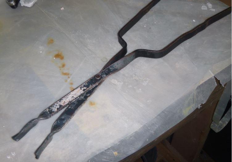

  3. KENR2600 posted a topic in Tongs
    So, I made a forge. Finally fired for the first time today to full heat. SO, now what? I need tongs. I had a pair of old fireplace tongs - scissor style with bad rivets - pretty chintzy. So, I separated the parts, flattened the ends out a bit, and rolled the noses over to get a bit of grab and bite. Voila!! 15 minutes later, a pair of serviceable tongs with a springy grip handle to them. Nothing pretty, nothing fancy, but perfectly useful.... kinda like me....

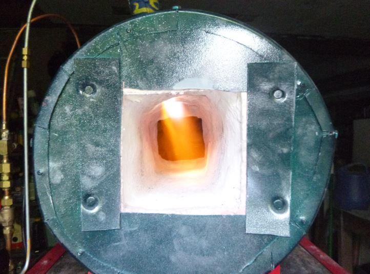

  4. I started tall. It seems more comfortable. But, I wasn't sure how I'd like it, so I went with tall. It'll be easier to shrink it, if desired, than to stretch it.
  5. I'd rather the flames hit the wall up higher, but my "hard coat" got too close on the entry ports, and restricts my ability to turn them up further.... still. not bad for a first shot - in my "newbie" opinion....
  6. … not sure what your coating is - looks to be a matrikote or some such painted right on a 2" blanket wrap. As it goes through heat cycles - it WILL shrink and expand a bit - a good chance through use- the blanket will stabilize, and successive recoats may hold without cracking out down the road. Be sure it is super dry - and then cure the finish coat at moderate heat for short bursts, and it may help. ANY moisture left in the coating or sucked into the insulation will make the problem worse... not that it appears actually problematic - yet... Everything needs time to settle itself into "normal" from cold to super hot cycles.

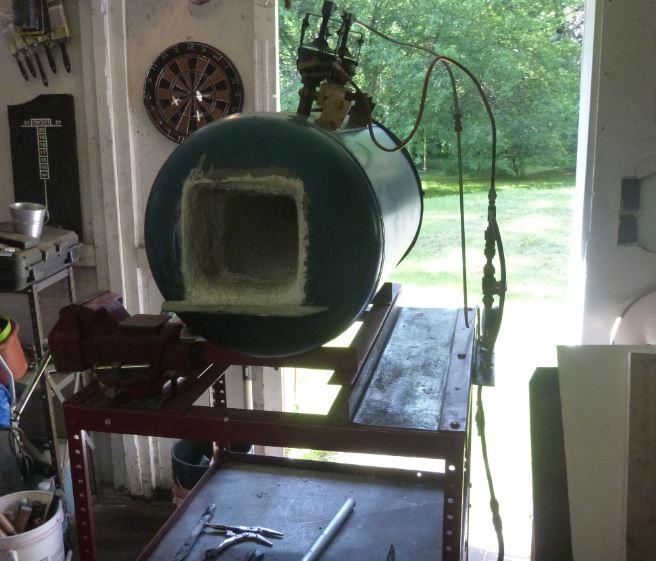

  7. After just over a year's layover - from health, wealth, and time issues - I finally got my insulations, liners, and the like. Finally, the forge gets to spit some fire. A bit of trouble with the primary burner spitting at low pressure - idle basically. Once it turns up 4-5 psi, it seems fine. A whiff of a breeze over the intake cup solves it. Everything else looks nice. Can't help but wonder if I have a small leak at the junction of the mig nozzle.... The photos show 8-10 psi - the shorter video is my "dragon's breath" with the pressure maxed up at about 25 psi, and the back hole blocked completely. The unit had been running about 5 minutes on the front burner 2-3 on the back. The finished space is about 5-1/2" wide by 14" deep. P1030221.avi P1030225.avi
  8. same as Mikey pointed out on your other set-up... the t should be a reducer type with larger intake ends than the output. From there, getting your jet size and distance will make the difference.
  9. ...having had a similar issue on a different design... I ground down the tops of my reducer intakes to an angle into the cup...instead of the flat tops. That alone , I went from barely enough air to more than I need, and need to choke it down. Having it draw air in from the very edge instead of across the flat surface and then down into the obstruction of your gas jets, it should greatly improve the draw past the jets. The smaller tip with a greater velocity of fuel should increase the suction and mix.....

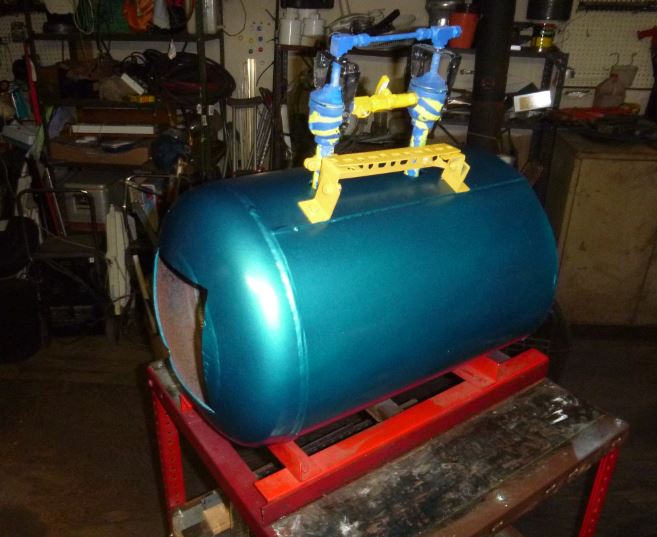

  13. So, forgive the color schemes..as all the parts (except propane valves). none of it is planned, and all stuff on hand. In fact, the shell is Honda - Tahitian green, mixed in a color match from 2004, a few years on the shelf - but paints just fine. The burner bracket - Dodge "prowler yellow" - also an old mix. some craft paints while building the burners just for fun.... So far, it has been an interesting build, but put on hold. I haven't come across a dime to invest in insulating, and found no one around with freebies - or mostly no clue what I'm talking about.... Plenty of tinkering to do yet anyhow, so - we will be patient and see what the universe brings...

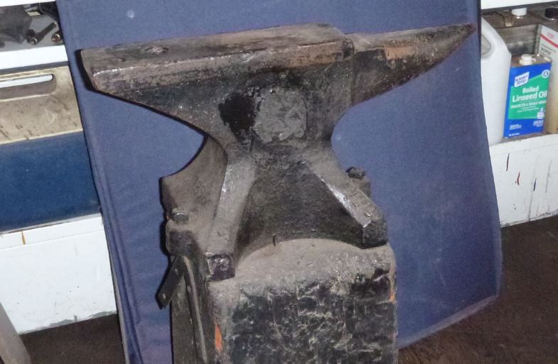

  14. found this one at a last chance shop before scrap-it. I figuring 130# don't know what the v3 is for - and not sure what that side casting is supposed to be.... 50 bucks... I'll take it. Actually, I had to get the wife to go get it , since they were kind enough to load it for her...
