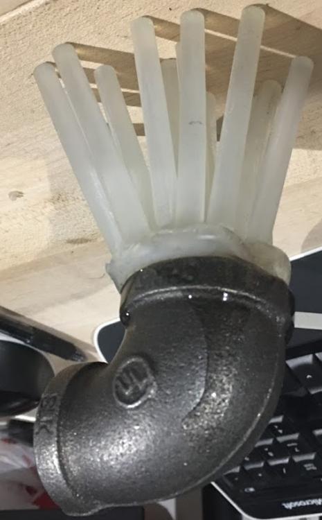

  4. I actually did a 1 1/4” elbow, and an adapter to 3/4” in one side. I prefer this, the tee makes it weaker. Edit: I put the whole elbow inside as it makes the casting easier, and is quite strong it seems. Edit 2: it was a 1 1/4" elbow used. I cast it inside so that I didn't have to worry about it separating into 2 pieces.

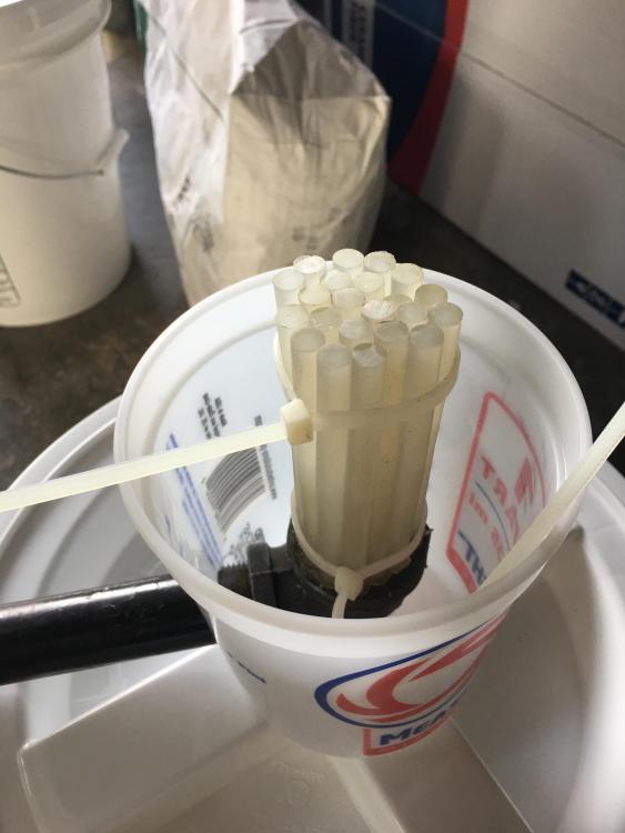

  19. Ok here’s take 2. This time I used the 1” run x 3/4” tee that is used for the frosty t burner, taping off one of the 1” sides and placing that on the bottom. The thought is that I’ll open that up to have a look at the interior after burn out and then plug it when used. This one also only has 19 glue sticks, which makes for a nicer bundle closer to the 1” size. When casting its important to stuff some in between each glue stick with your finger before filling the sides or else it’s very difficult to get them to maintain any space. I’m using the side of the blade on an oscillating tool to get it to flow some, but the main part is fingers to stuff it in he right spots.

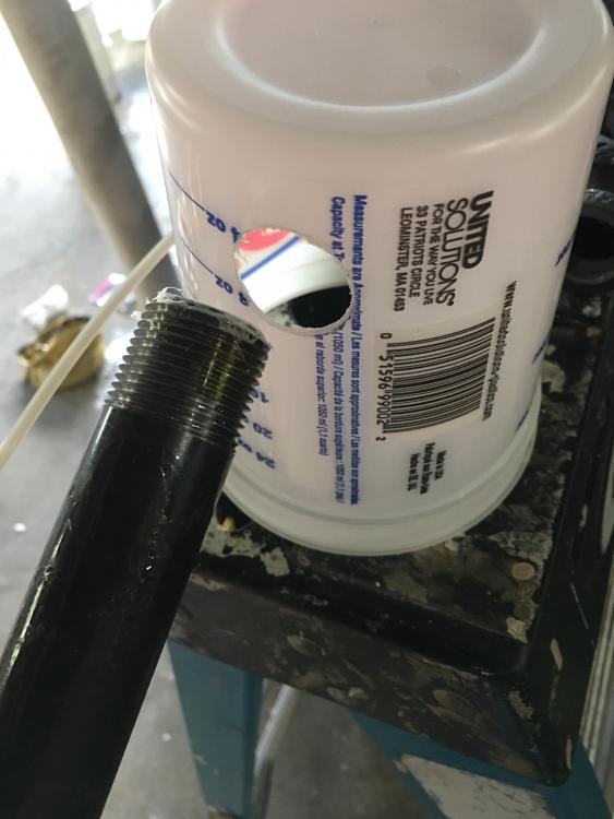

  20. That kastolite is some interesting stuff to mix. I just finished casting the first one and it turned out ok, I wanted to record the measurements for next time. To cast one of the quart mixing jars I needed about 36 oz of kastolite powder and about 12 oz of water. Both are by volume. I attached photos to this post, I hope they get reduced by the forum software or I’ll have to try to get that done in at the computer.

  22. Had a chance to play around a little in the shop (and office) tonight. The little hot glue sticks seem to melt at a very low temp, so I think it will be easy to burn them out. The smell coming from them when torching them doesn't seem too offensive either, just a typical hot glue gun smell except stronger. I am hoping I'll be able to pull some or all of them out after casting though and won't have a ton to melt out. Here's the process so far: (22) of the .28 diameter x 4" glue sticks zip tie on both ends in a tight bundle torch the top of the bundle, melting about 1/8" or so, just to join them all together (10-20 seconds depending on your torch). You could just use a glue gun I suppose 1" x 3/4" black steel elbow, place it on top of the bundle while the glue is melted For casting it, I'm thinking I'll cast it with all the glue sticks pointing up (attached photo that is upside-down for example). I'll also encase the elbow completely in the refractory - we will see if this makes it crack or not due to differential expansion. For the casting vessel, I'm thinking a quart mixing cup - make a hole in the side about an inch or two up for the 3/4" pipe, drop the elbow and glue sticks in, insert the pipe in the hole. I'll keep them bundled as I pack the refractory down around the elbow and start of the glue sticks, then remove them and keep filling with refractory until I'm happy. Adjust each nozzlet / glue stick, thump it to remove bubbles, adjust again, etc. This will let me give them a little room around the ends of the nozzlet too for a taper effect.
