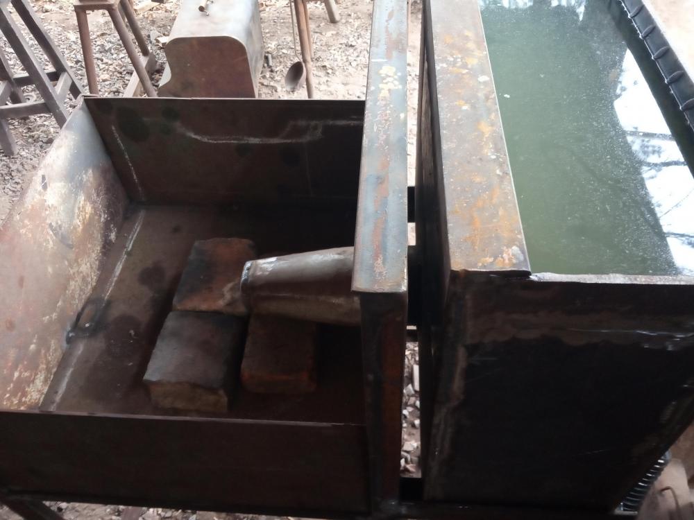

  1. Thanks for the comments! today i'm Will make the first test whith sand filling and an electric blower
  2. Hi, I'm in the process of making a side blast forge and i want to share whith you. The design is based on Mark Aspery notes, the Main body is almost complete and now i'm working on the Hand Crank blower, inspired in a antique Buffalo flyweel design. Eveverything is Made of scrap ir recycled parts and materials. My idea is to use this coque forge whithout electricity, it will depend on the eficiency of the blower design, but whit the 60cm cast iron wheel driving a 2cm diámeter blower pulley plus the Crank relation of two turns of the flyweel per Crank i think it Will work.The main air tube is made big for this propouse from a 9cm Pipe narrowed at 2,6cm at the tip of the nozzle. What do you think? This post bring me back ti the forum since a long time, i will apressiate your suggestions and coments, i will go posting the progresess. I read in some other post about filling the botom of the forge whith different materials, i have on hand two: masonry sand or black soil (not a clay type) what did you recomend as a best option? Thanks and have a good forging day every body!

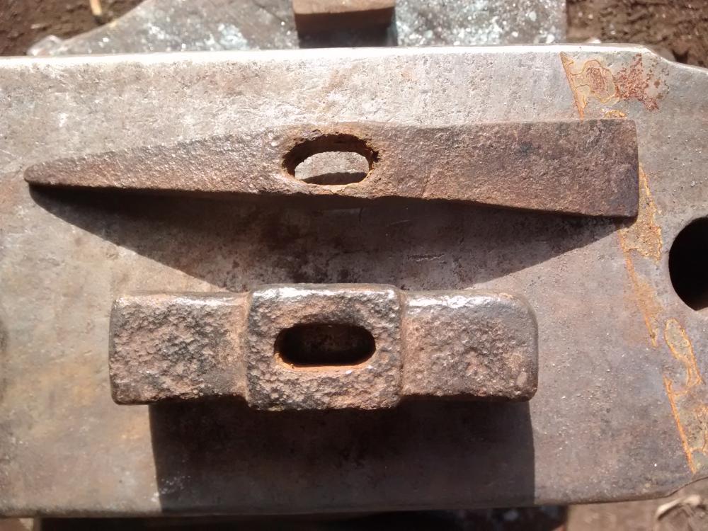

  7. I found this very old two hammers today , some idea for his potential use? I think one is a little set hammer and the other could be a leafing one .

  10. I think doesn't matter if the eye is rectangular or oval, the handle fit well in both, I guess it's a design tradition What matter is the hammer shape and the way is used.
