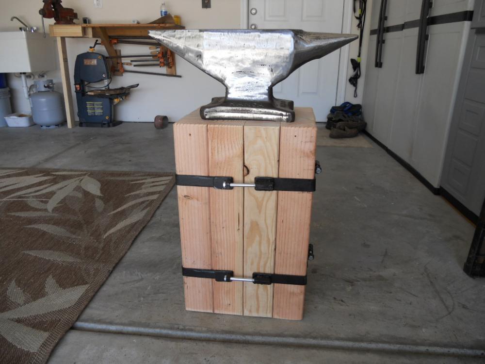

  8. After 6 months of trying to locate a decent anvil near me I gave up and bought new. It's a 110 lb. Kanca and I'm happy with it. I wanted larger but the wife insists her car goes in the garage at night and at my age moving 110lbs.is still possible any larger ... not so much.

  12. 68 years old, needing a new hobby and thought I'd try my hand at smacking steel. I had limited welding experience many years back but never forged a thing. After 6 months of trying to find a decent used anvil I bit the bullet and bought new, pricey but worth it ... at least in my humble opinion. Built a base for it and made 3 pairs of tongs. The first 2 pairs are not very pretty but serviceable the third is a little better. I gave a try at creating a touchmark and it came ok, when I gain more experience and the work gets better I may even get to use it.
