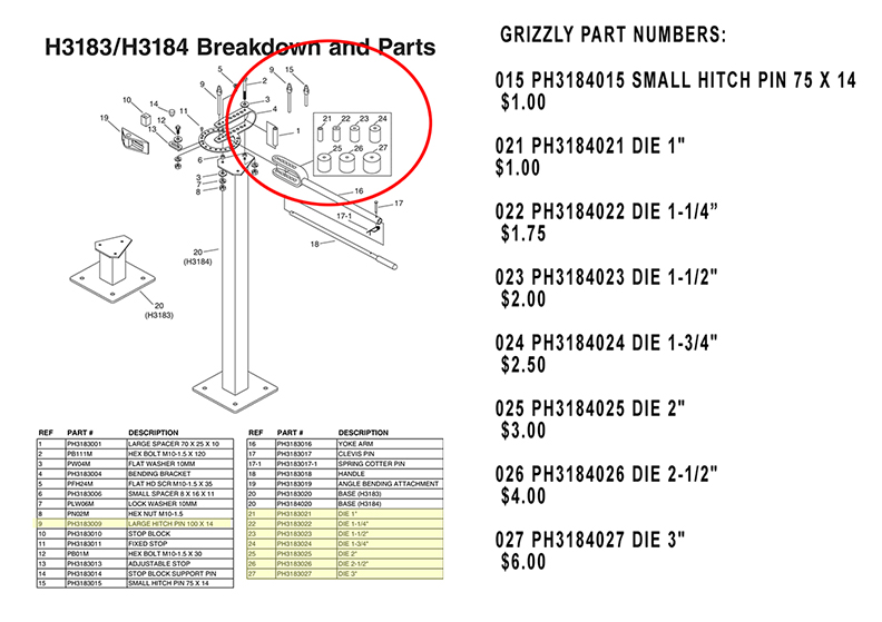

  7. That is really cool Das! I will make one for dedicated radius bends for sure! I made the sliding angle iron style one for bending various thickness of steel a couple years ago using bender dies from a Grizzly Bender. Works great! I bought the roll dies cheaper than my brother could have bought the stock and machined them for me! I didn't have a picture handy of the set up but here is a sketch and part numbers and prices:
  8. Das, John, I am truly inspired I now have a great use for that Jackhammer bit John gave me!

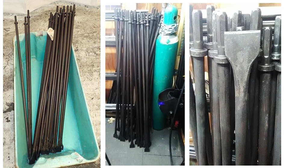

  21. I scored another load of new hammer bits. Stopped in at my local industrial surplus place and found these babies. 48" long, 3/4" shafts new old stock. I got them pretty cheap. My spring time stock of new chisels and punches! Probably summer, fall and winter for the next two years...... Stop in and get some JHCC!

  24. Hi John, Please tell me you made two sets and have an extra set up just laying there waiting for some needy local smith. Ha!
