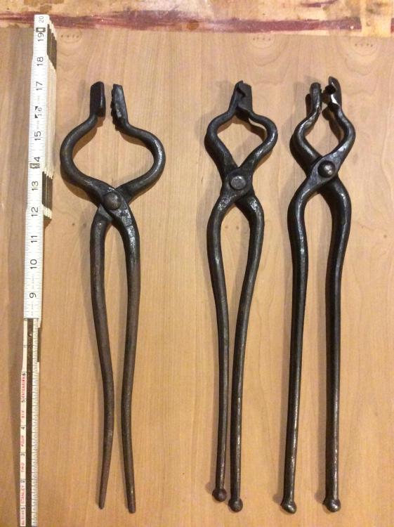

  3. Here’s where I ended up when I posed myself the same question. I am no blacksmith, and have never purchased tongs, or used commercial tongs, so have nothing to compare them to. I find that this pair can hold to 3/16 to 1/2 inch stock without having to stretch my grip I don't believe the serrations do anything, though the in line groove on the small jaw helps stabilize smaller stock when held straight out the jaws. I find these tongs agreeable for making hooks and other small items that the stock changes in dimension and shape , good grip without having to switch tongs , and plenty of room for things to hang out the side. I had posted my first pair of these and was advised to put the cross slot on the larger jaw. Advice taken and utilized, with good results.

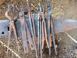

  4. Good afternoon from North Thetford ,Vermont. It all started with the brother in law wanting to make knives. I never knew what a little air and charcoal could do to a file. He left the craft before even starting. I unfortunately got hooked. No knives mind you, I witnessed all the frustration. I floundered and bled and burned myself and read a book or two. Then I realized that the best information I found web surfing was usually at IFI. Then I set to absorbing as much as I could here. I did hit my first hammer in last fall at Ben’s Mill in Vermont and plan to make the New England Blacksmiths spring meet. A couple pictures of my whomping coop. The coop for the chickens that I was only to use one winter to cover my tools(four years ago). The chickens ended up with a different coop, although they do visit. Thank You to all who share on this site . Sid
  5. Thank you. I have many pairs of ugly tongs. I didn’t know tongs aren’t for beginners until I found IFI. I had to stop and do some skill building for a while. Now I use tongs for skill building. These are retired for safety reasons.

  7. Loosely inspired by Brazeal ultimate tongs. I find they grip a wider range of stock sizes and shapes without adjustment. They grip well as the stock changes size and around bumps and curves. All mild steel, 1/2 & 5/8 round. Slowly but surely the forging improves.

  9. I've been following the tong section lately. This is my attempt to put this newly gathered info and skills practice together. The blanks were 5/8 round. The first thing they got after the picture is another trip to the fire to bring the inner jaw up and in at the nose to fit 3/16 round. Very grippy. Very versatile.

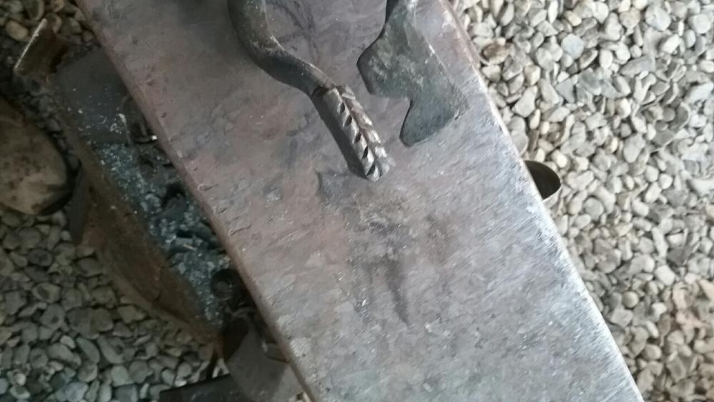

  13. May I suggest the Abana Curriculum. Controlled Hand Forging. It certainly helped me after thrashing about for Eighteen months.
