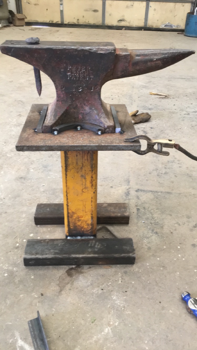

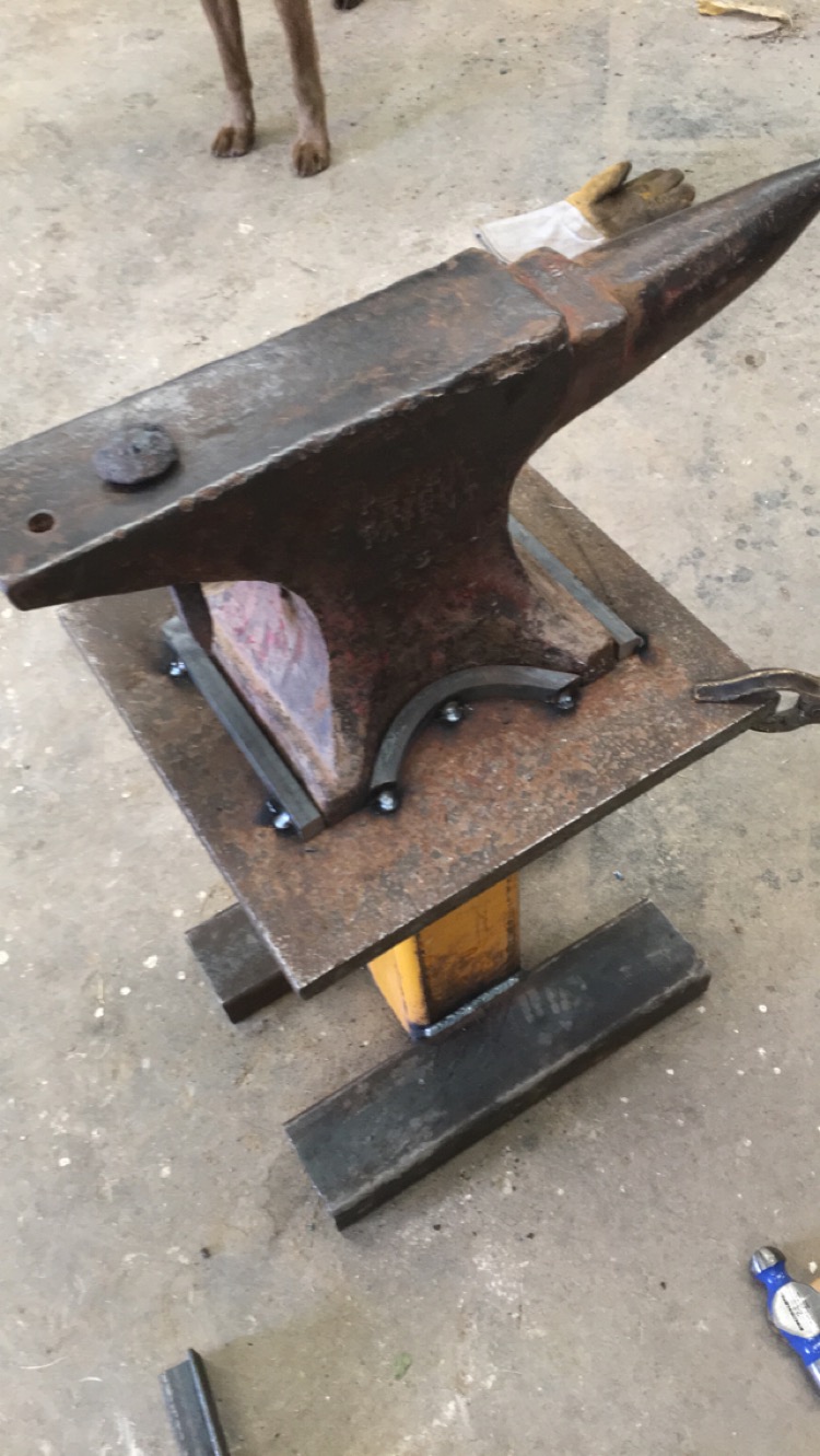

  9. well, the upright is 5"x 1/2" wall and the feet are 2x3x1/4" I did fill them with about 45lbs of sand and capped them off. Its still somewhat loud. i have some baler belting here that ive been thinking of putting under the anvil. I still havent decided on how to clamp it down. (to busy bashing things with hammers haha).

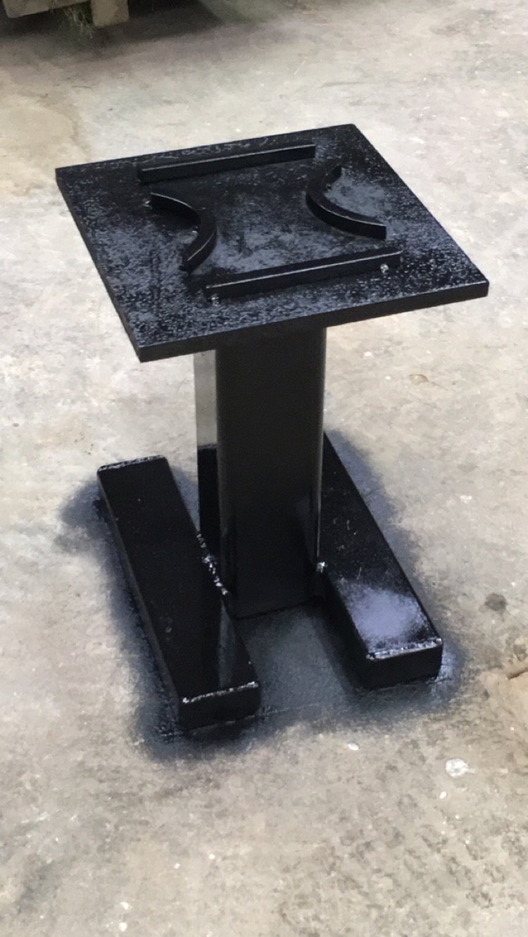

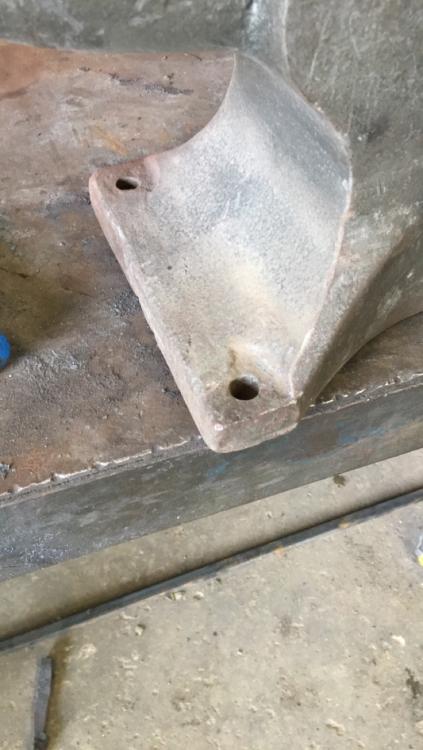

  10. Thank you Glenn, I did decide to go with the half moon shapes. Only tacked onto place right now. I will use it for a bit, and see how I like it. Thanks for the insight. I never thought about using the "whole anvil" as you said. Great info! sam
  11. hello, This past Sunday i purchased my first anvil, brought it home, and began building my stand. I decided to build the stand out of metal instead of wood for the simple fact that id rather cut, weld, and grind than start up my chainsaw. Anyway, my question is on mounting the anvil. Is it necessary to fasten down a light anvil (94# PW)? or can i just build up around the outside base? Ive been all over the forums looking for someone asking a similar question, if i missed it i wouldn't be surprised, because of the amazing amount of information on this site. My original idea was just to build up around the base, but i'm concerned the anvil isn't heavy enough and will bounce around too much. Just thought id get some opinions while i sit and have a cold brew. thanks! sam tried to upload some pictures, but for some reason this electronic thing isn't cooperating with me.

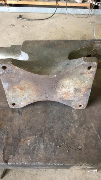

  15. okay, so i did the spark test. im thinking its definitely cast iron. it does however throw quite a bit more sparks than another peice of cast i had laying around. did some research and i think its because it is "white cast". not 100% on this. there is a pretty dead thunk in the center of the face, however the horn and heel have a much more crisp sound. not a ringing, but very sharp.
  16. only way i know how to to that would be the spark test. not sure if hitting it with a grinder is a good idea. haha.
  17. seems to have decent rebound, 50-60% maybe, but its very quiet no ringing at all.
  18. I really have no clue. im a true beginner but ive used this anvil at work for different fab work off and on for the last 5 years and i was just curios. however i just did a google search for trenton, and all the ones im seeing have solid feet, this one has holes in it..?
