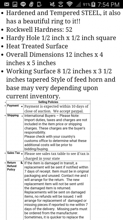

  11. 10-4. That's what I needed to know. I knew $50 was too good to be worth it. Thanks
  12. I found this online and would like some feedback before I send some money. Would this be a good starter anvil?
