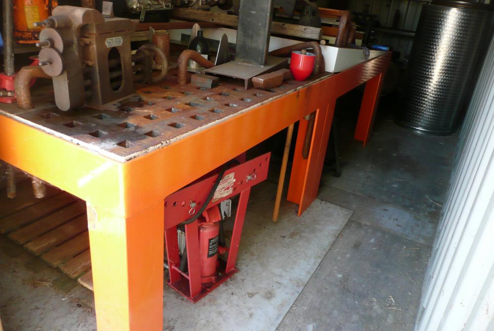

So here is my fab table I would like to put the blue vise on, what is the best way to support the leg? The cute little vise just showed up today along with the pile of tong looking things and a couple of other goodies. The three smaller vises are going to go, does anybody here need them?

Here in the next week or so I plan to get my big acorn type table out of storage and put it where I can use it again, I think I will mount the 7 inch post to that and give it a try. Is there a preferred method to support the leg? It has about a 7/8 diameter x 1 inch long peenie sticking out at the bottom that needs something substantial to go into I gather from what I am seeing here. I will try and get a couple of pics of the table later but it is basically 2 five foot square acorn tables about 7 inches thick in a single frame made of 1/2 x 6 angle with 6 legs of the same. I have shaped metal a lot of different ways but this is heading off in a bit of a tangent. I used to work for an old guy that liked to say " consider it a day lost that you didn't learn something worthwhile". and " you can't make a living working with junk tools" Thanks guys for the insights

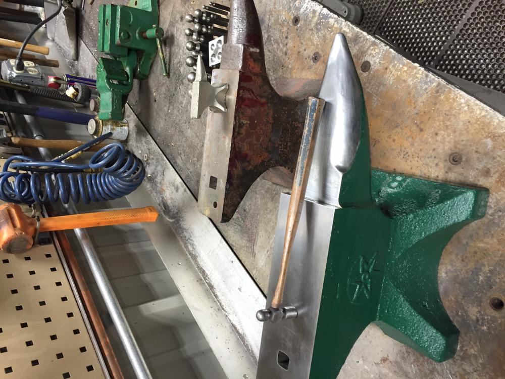

Show me your anvil
The green star has a job it does very well however it has to be dead flat and smooth to do it. the one behind it had been used to make a buffalo drill press table closer to the spindle and was drilled full of holes and looked like it had been attacked by an ax murderer when I found it, so a bit of welding and milling and I was able to use it some. Just like anything else though, once you find one another comes along, a bit bigger or better right up the New old stock 200 lb fisher i just picked up.

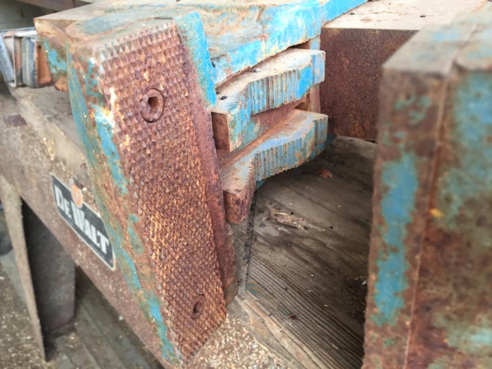

What is the attraction of the post/leg vise?
In my weekends acquisitions there were 5 vises, 3- Colombian post vises, a 7 inch a 5 inch and a 4 inch as I recall, a Yost 34c nos and some goofy vise anvil bench grinder thing. Anyhow I am thinking the post vises interesting but what is the advantage to a bench vise such as the Yost?
