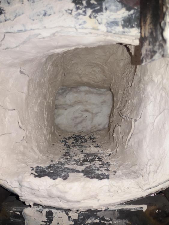

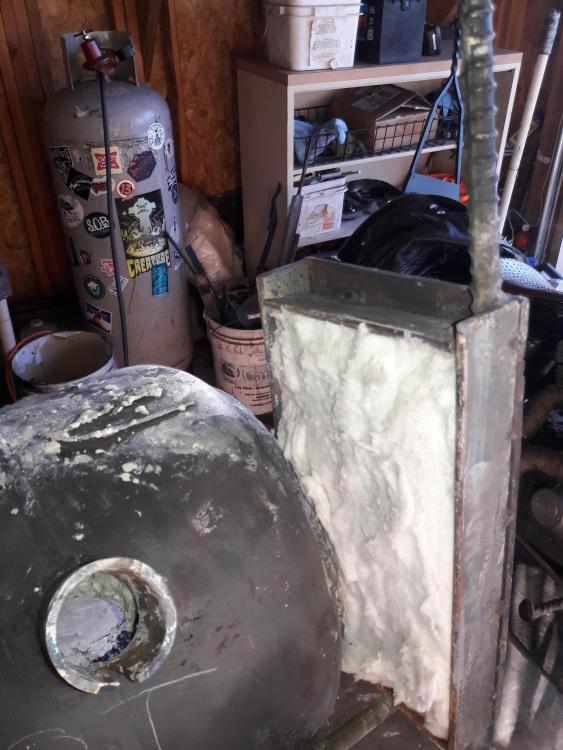

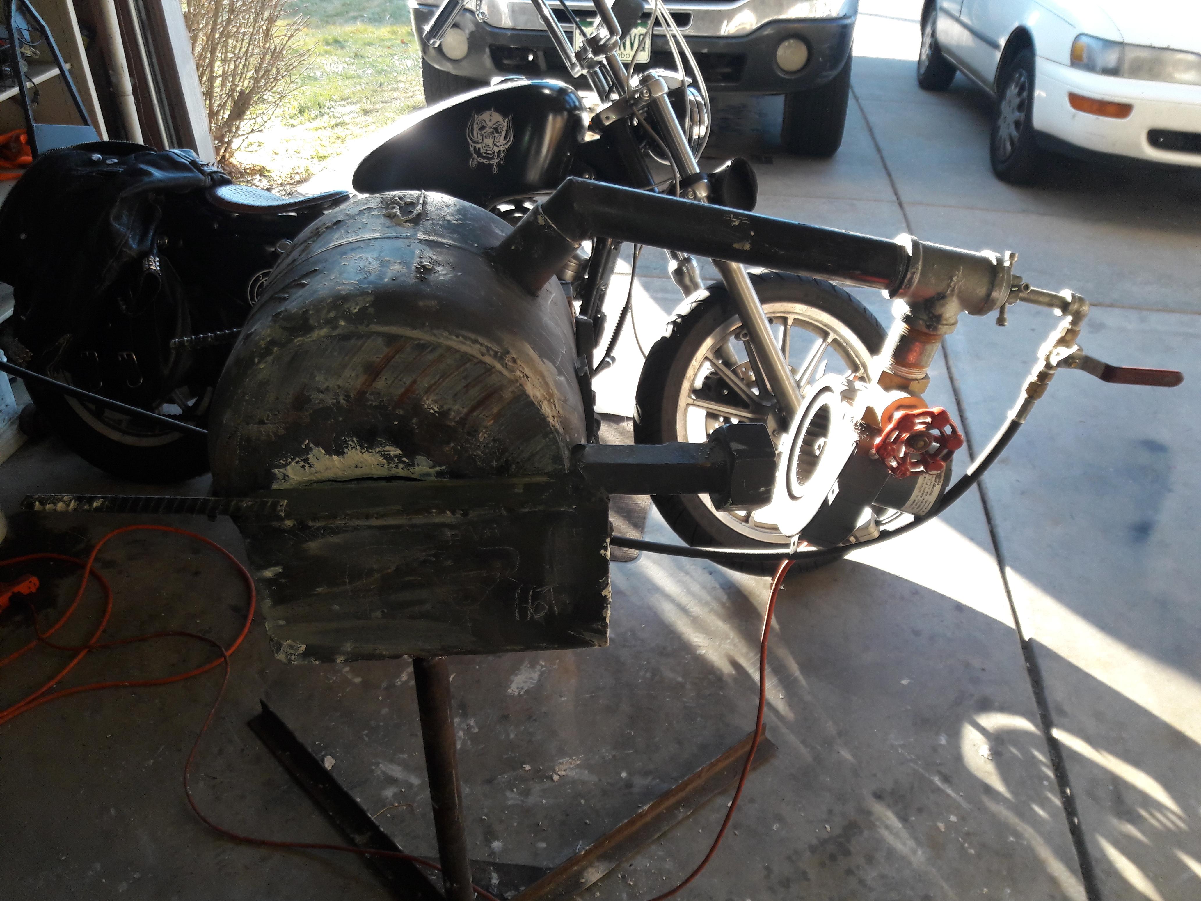

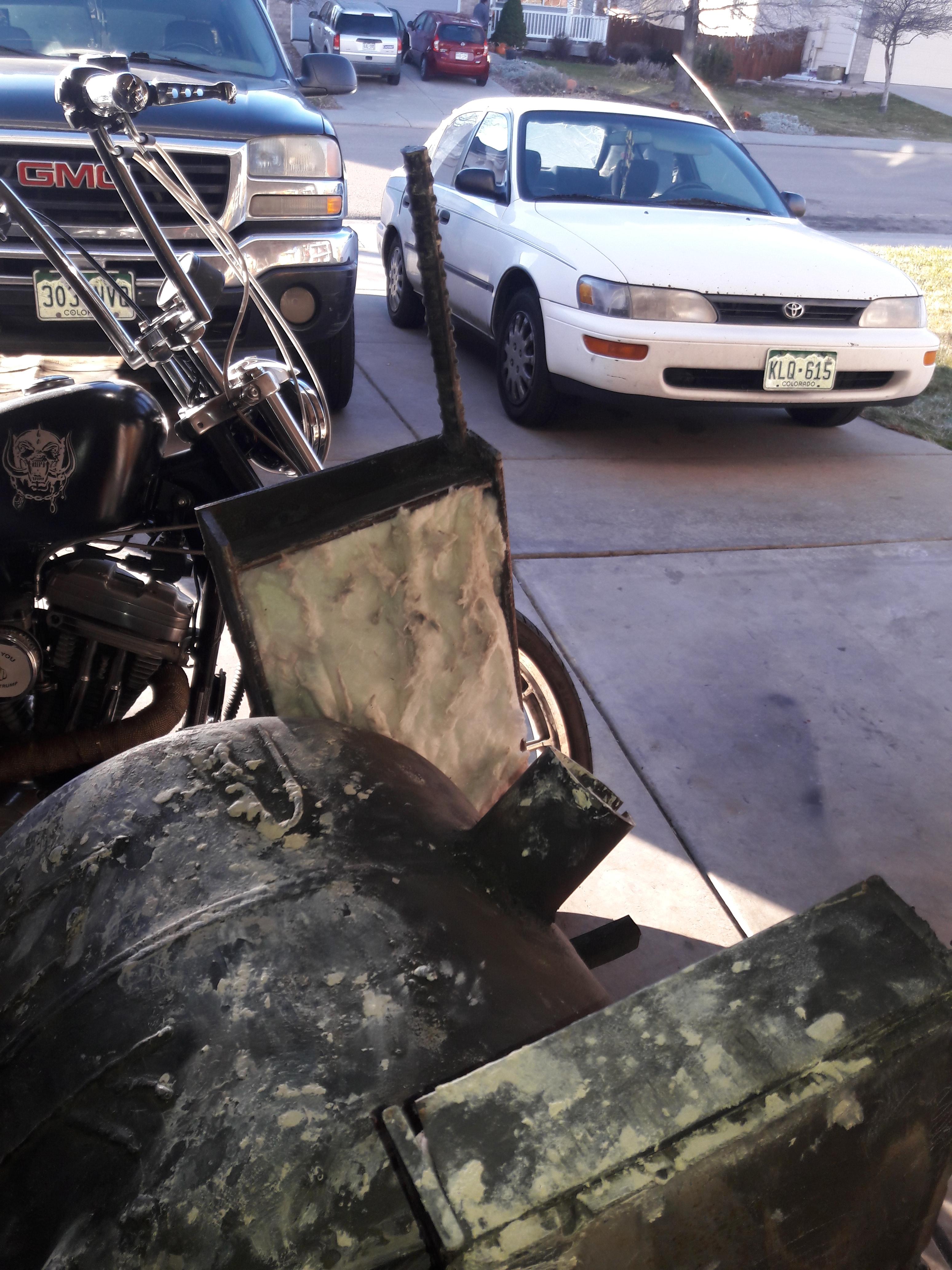

  5. Thanks Mikey, I actually bought the plans for the forge and burner 10 years ago and i know it's a good design as a lot of smiths have used it and still do. I just don't know if the mods that I've done have made it not do as well. I'm not familiar with baffled walls, although the flame is kinda hard to see, I do know what it's supposed to look like and it is a good crisp blue flame. I thought i was using the proper castable refractory. It fires real well and does withstand the heat very well. It does not burn, melt or deform at all. I've used stuff that didn't withstand that kind of heat but this stuff that I ordered does and it hardens very well. I just don't like the cracking. If you have a suggestions on something better then please, I'm all ears.

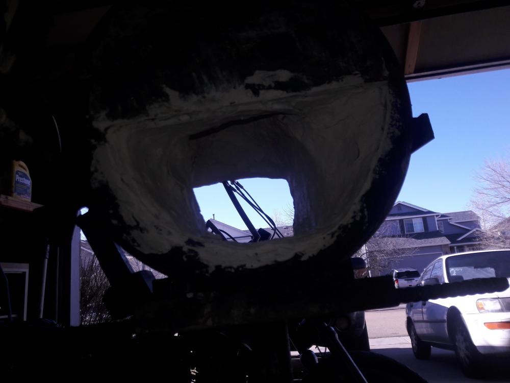

  6. By the way, the doors have 1.5" of kaowool lining as well. The space as of right now is about 10" deep X 6" high. I don't know how to get the cubic inches but that's the space I'm heating. I guess the other question I have is, is that too much area for one burner with forced air. I live in Colorado so I can't do atmospheric. Please and thank you again for any help. Chris

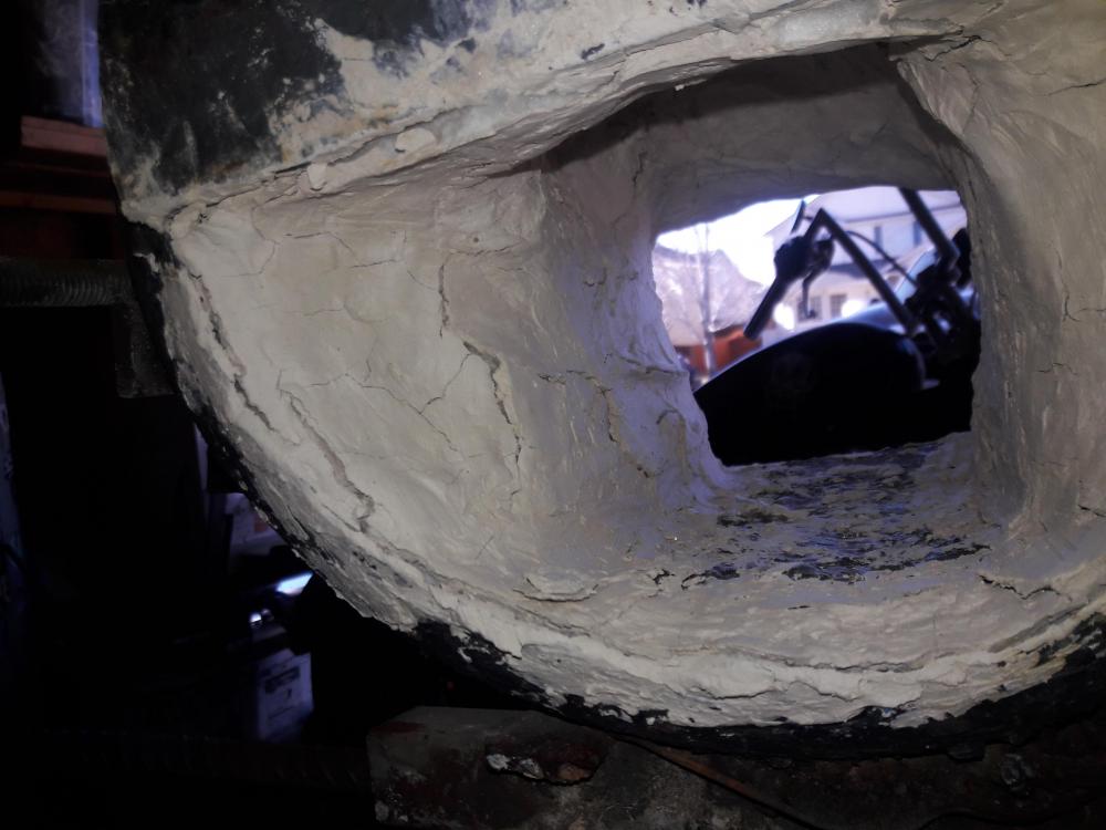

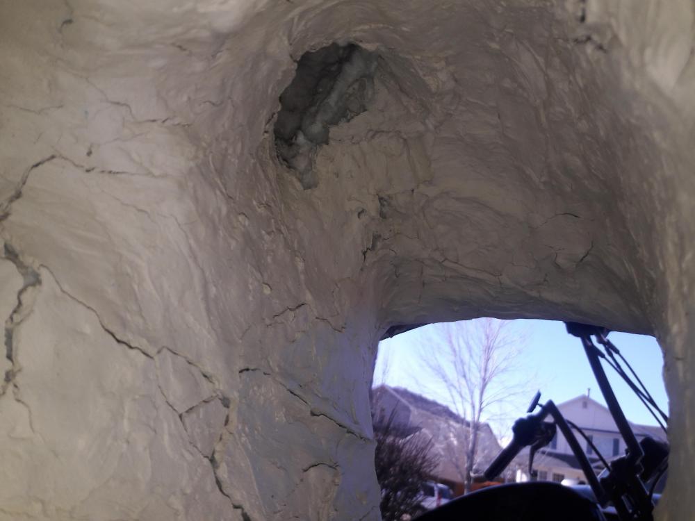

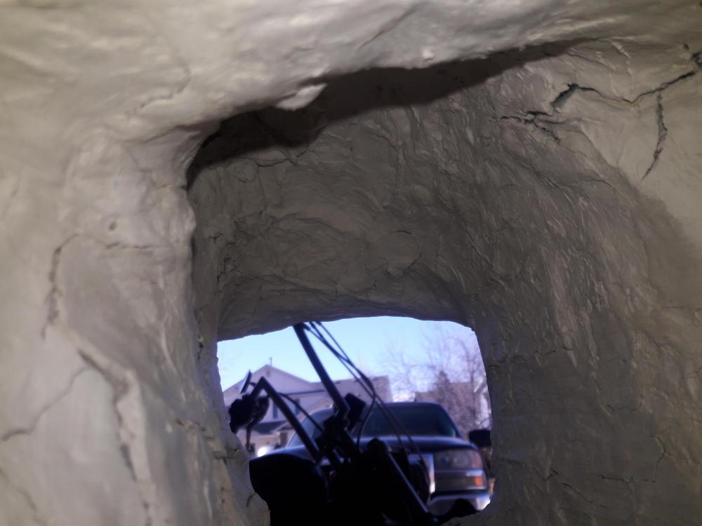

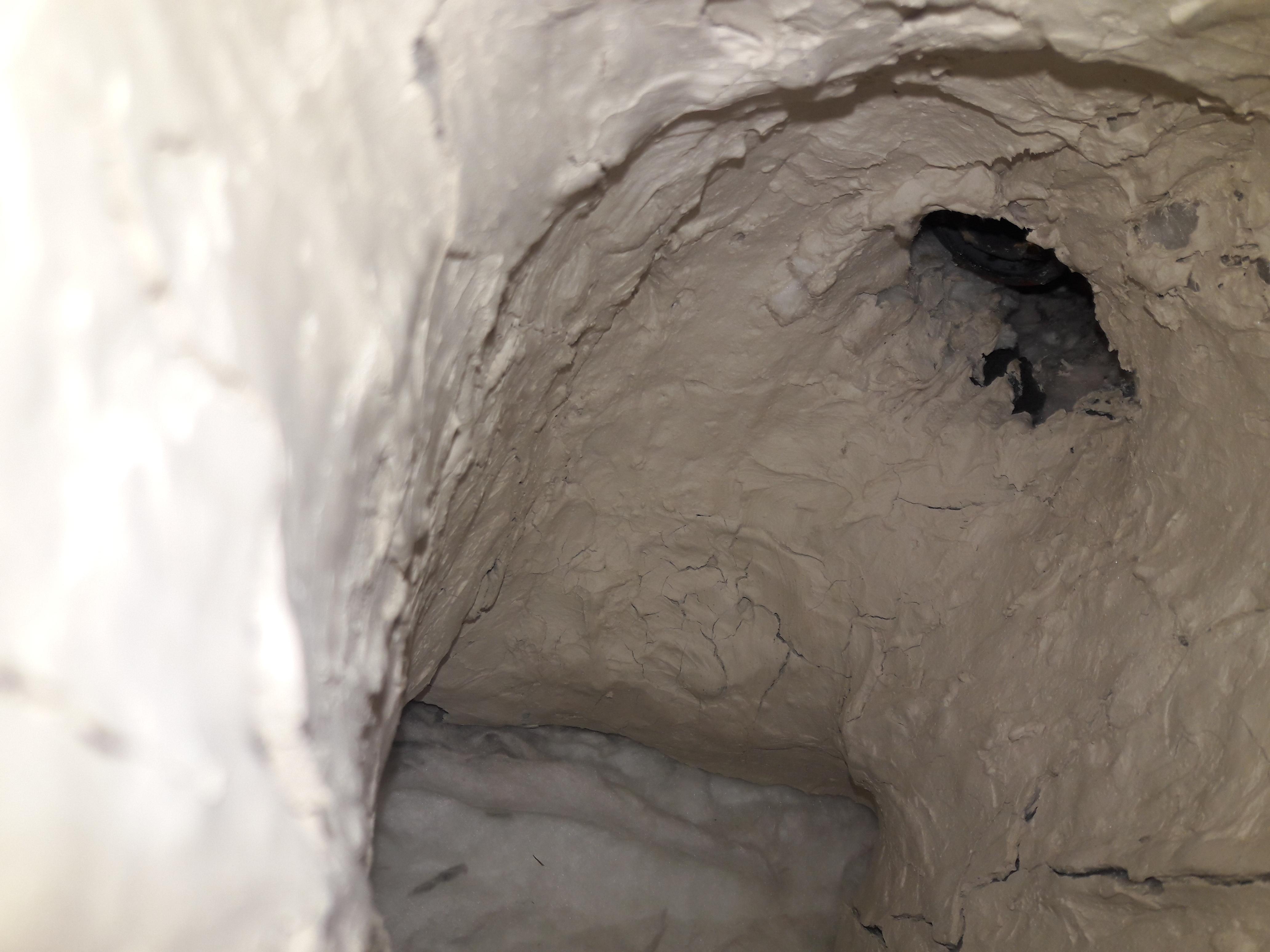

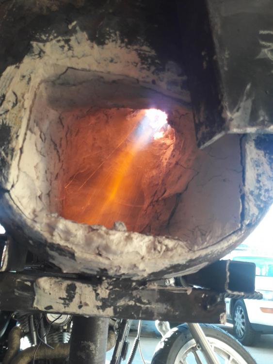

  7. This is not the first time i have applied refractory cement to my forge. In fact I've done it several times. I've been having a hard time getting my forge up to welding temp and staying there long enough to weld at a efficient rate. I doubled up the kaowool hoping that reducing the space would help. I only have one burner in my propane bottle forge. I applied a coat of refractory then filled in the cracks that weren't actually too bad. When That cured the cracks were much worse. I let it cure for 48 hours both times. I want to fire it but don't want any cracks as the goal is to not let any heat escape to behind the refractory lining. I was wondering if anyone else has had this problem and how they took care of it. I could fill in the cracks again but it seems that they would just come back through. I also was wondering if I should fill in the cracks then fire it on low heat. then obviously increase to complete the firing process. Thanks, Chris

  19. thanks for the reply. so, is a humpback stick welder gonna do as good as a job as a decent mig? i know the cheep flux core migs are cheep and don't do the job but iv'e always heard that stick welders are just better.
