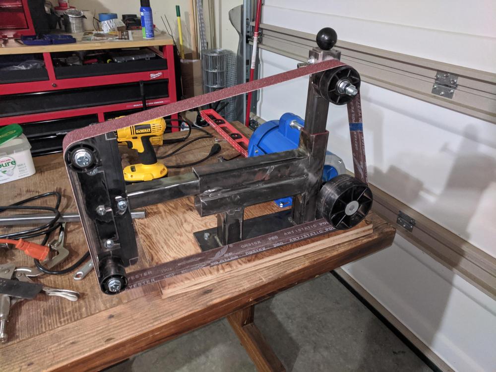

  5. Alright update video. I think I'm good now, first off @ThomasPowers your advice was the best! I contacted Dan C. he was super helpful gave me a lot of things to try. @Kozzy I think you're right, having the two crowned wheels (tracking and drive) do make things more complicated, it took me a while to get things situated so that the tracking wasn't "touchy" and I'm pretty sure it has to due with both the drive wheel and the tracking wheel being crowned. @John in Oly, WA Your advice on the D-Plate was spot on: the thinner plate was definitely flexing, and on top of that the thinner plate made it that much harder to get the idlers aligned with the tracking wheel. Besides taking some of the suggestions here and the ones Dan gave I also welded 1/8th inch bar to the top of the tool arm and the "front" of the tracking arm, then ground these down for a tight fit in the frame. One problem with using this tube steel is there's a lot of "play" in the arms that reeks havoc on getting things well aligned, if I were to do this over I think I'd use tube steel for the arms but figure out a different way to build the frame so that the arms fit with 0 play into it.
  6. Yeah I'm definitely going to change that since I have thicker plate laying around, and its not helping with the alignment issues.
  7. I mean that makes sense I'd just never heard it before and lots of these things look like they have crowning on both. I've actually got the thing running smooth on 3 rollers: But you can see its still hanging off the drive and idlers by a good half inch. That's what makes me think the biggest issue right now is the alignment, and specifically that of the tracking wheel, its like it needs to move back towards the motor a bit. For getting an uncrowned tracking wheel do you have any suggestions on where to buy? I can't fabricate one / modify the one I have, I don't have a lathe.
  8. Aren't most crowned? All the DIYs for this kind of grinder recommend a crowned tracking wheel, including the one I linked. Seems to be a common enough recommendation. Considering I "eyeballed" the alignment of the pulleys, that's probably where I should start. going to do alignments with the straight edge.
  9. No actually, I'll probably hit them up too. I think this is a pretty popular design and figured there are tips for general alignment issues. Just putting out feelers everywhere.
  10. Built a 2x72 Grinder based on some designs found here . Right now I'm having a lot of issues with tracking that I think are due to alignment problems. A lot of stuff I'm reading mentions using straight edges to fix alignment issues, wondering if there are any other tips, or even better, possibly designs that are easier to build for those who are less experience with welding and overall precision. I've attached some images below with what Im working with. So I've had this running and have used it but in the first image you can clearly see the belt is riding all the way over to the tracking hinge and rubbing there, clearly no good. It definitely has to be my alignment is awful just not sure how to adjust it. Another question I had is how "tight" should the belt be, right now I try to get a pretty good amount of tension, but the sticky post in this forum seems to say that's not great. I wish the image links on that post weren't missing.
