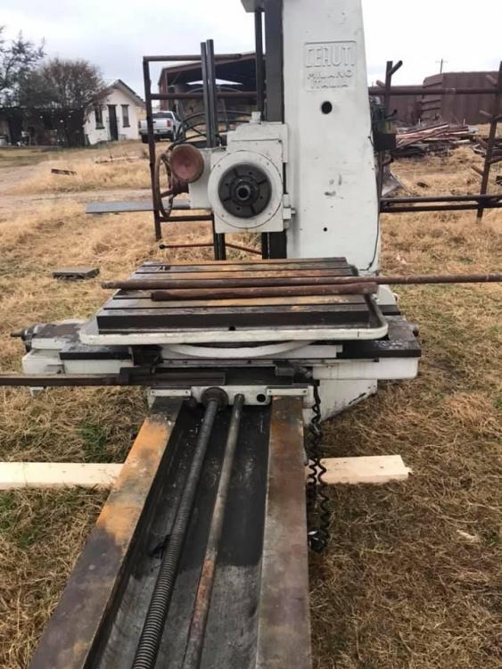

  6. I picked up this horizontal boring mill in a online auction out east along with some other things. It will be a nice audition for any repair I have or the ranch I live has once I get tooled up. Planning on using it to build a press or two with it as well. About 10' long by 4' wide with MT 5# taper spindle.
