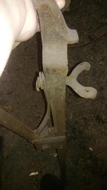

the more i look at this vise, the older it gets! i notice now that the front jaw is forge welded on and the hinge area of it has been doubled back and welded to add mass, plus the bevel forging of the shank between hinge and eye is not even, its about 10degrees off of being right, though it is square in cross section. also there appear to be fullering marks on the front hinge jaw pivot but im not sure their reason. As well the post side definitely has the "cheeks" of the hinge forge welded on and it has some deep fullering marks inbetween on the plates, i presume to mame sure the cheeks made good contact with the post. The hinge hole in one side of the cheeks has a small "key" i it which ive seen once or twice on other vises before to keep the bolt in position and prevent rotation , though the bolt is certainly not original. im intrested to see what electrolysis reveals when the rust is gone.

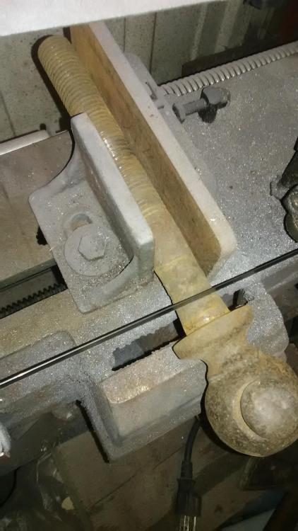

no, the pivot is square bolt but its not as old as the rest, and yes the leg hole has definitely been punched and drifted to a taper approximately .5 inches square and wider on the "back". As for the thread, thats exactly how i intend to make the female thread later when i go over this properly (after finding/making the male thread first of course) as well as a more accurate thread box. right now its more of a "get by". after getting things in a workable state i am going to throw it in my electrolysis barrel for derusting to see more of the details as well. Something else that makes me wonder about its age other than the mounting system is the way the ring is pretty obviously welded around the foot.
found this at a yard sale for about 10 bucks, and it has set in the corner for a few years now so i figured itd be as good of a time as any to give it a once over. the screw is the most obvious problem. someone has "repaired " it in the past by lopping it off and welding on a 1" bolt in its place and discarding the thread box in lieu of a torche cut square nut. I currently dont have an adequate replacement piece of acme thread and dont really feel like making a square thread on the lathe right now, so i decided to keep the bolt because its a small light duty vise. Another thing showing its light purpose is the way the mounting bracket is attached. it appears that it was a tapered square with threads at the very end but i dont know if that is original as it all seems very light. But regardless i will replace the cludged in bent nail with an extension and a slot for a wedge but will likely replace the whole shebang with a more substantial bracket later. i also will leave provisions for replacing the screw and box later. Now onto the progress pics!

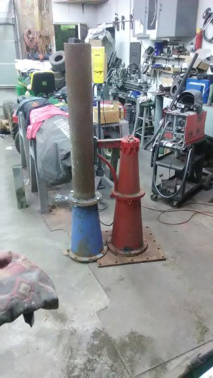

finally got this finished, added a cheap x/y table till i can make a better version, belt guard, paint, z axis, and built a cabinet with the surface plate in the top pull out drawer, plus everything else as far as basic accessories go. I know this isnt really a machining heavy forum but someone may find interest in seeing how a blacksmith builds a milling machine! final product with pretty much finished cabinet -

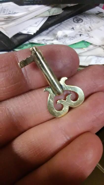

My dad made my sister an oak jewelry box last Christmas and needed a latch/lock for it, so i made this one from brass plate and bar stock.

The title says it all, had this project in the works for a while now and it's finally gotten to the point that it looks like something so i figured now it's the time to post some pics and details. It's built pretty much entirely from scrap, save for fasteners. The column is 8" well casing, capped with an 8" square of 1/2" plate, then the head is blocked 6" higher for the head mount on 4" pipe. The head itself is a 1 1/4" pipe with a heavily machined T on the end for the spindle. The spindle is mounted in tapered roller bearings, threaded at the nose 1" x 10 tpi for fittings like boring heads and fly cutters. More details to follow. The drive is going to be 4 step step pulley primary reduction, then a 2" to 6" final reduction to the spindle, which should make the bottom end speed with the 1725 rpm motor, about 200 rpm. The angle iron brackets that hold the head are bored to fit the horizontal pipe. They'll be split and fasteners added to clamp the head (it'll look like main bearing caps). Then the angle of the head can be turned left or right and clamped if needed. When the drive and the head is complete I'll add guards over the spindle pulley then it's on to the slide ways!

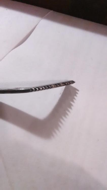

Actually The transition was formed by angling the metal over the rounded edge of the anvil an setting it down kind of like a shoulder Its actually pretty good practice for learning some good hammer control and anvil edge usage. (That being said. though I've done maybe ten of this kind of transition and this is the first one that came out so perfectly! ) I imagine you could do the same thing with a set hammer though probably -
Excuse the less than fantastic picture quality, my camera isn't working at the moment so i took the pics from my phone I had made a fully forged spatula a while back from scraps and that made me want to take it a step further and go all out on another! That's how this one came about The handle started out as a piece of 1/4 x 3/4 mild steel and the blade was a scrap of old lawnmower blade i think, forged out thin on the power hammer. Its about 19" overall and the whole front face is filed bright and the necking has a bit of filework for an accent. There's also some accent lines across the handle but i don't know if the pictures make it visible or not. was really a pleasure to do something bright and shiny for a change!

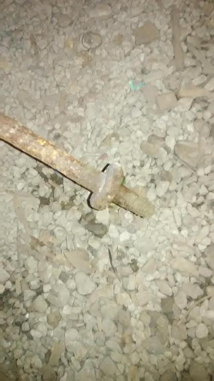

oh! I forgot to mention that, the bolt was later replaced, as you said, by threading one ear and tapping threads on just the end of the new pivot pin as for the center round, that was just a bit of careful work with a fine file, it was fairly simple really because it was at the top of a convex surface and here's a pic of the side profile that i forgot to add initially -
