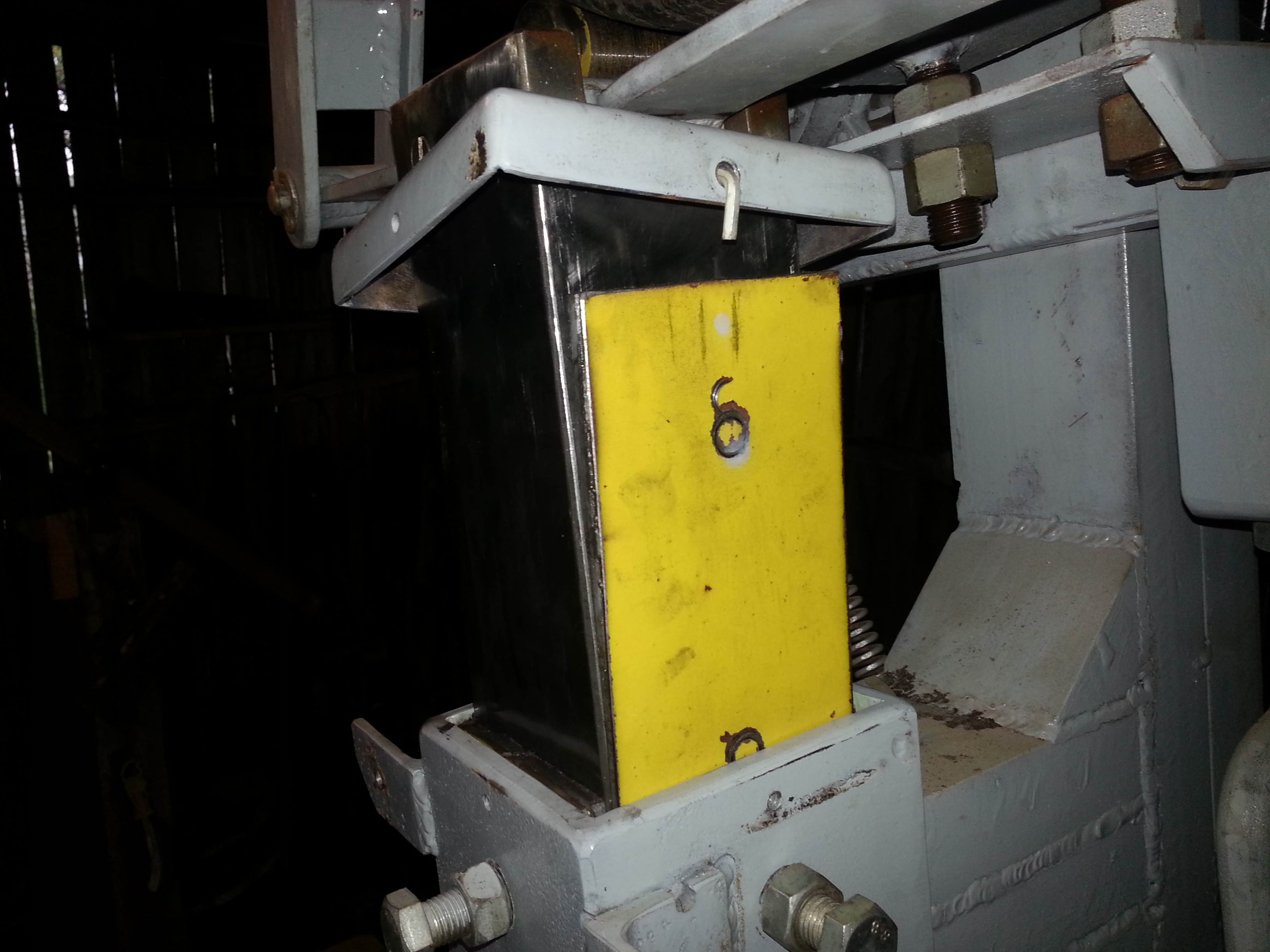

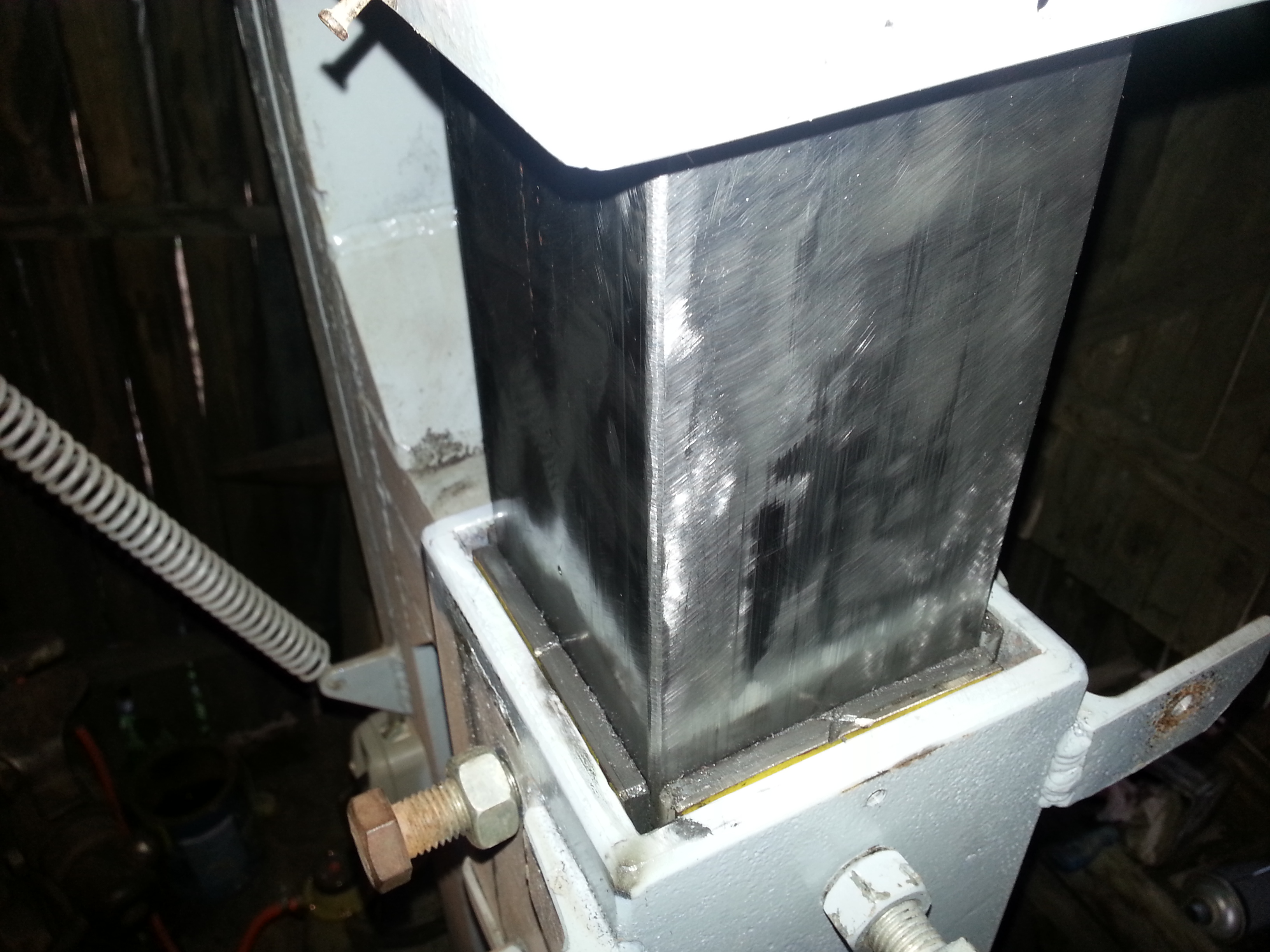

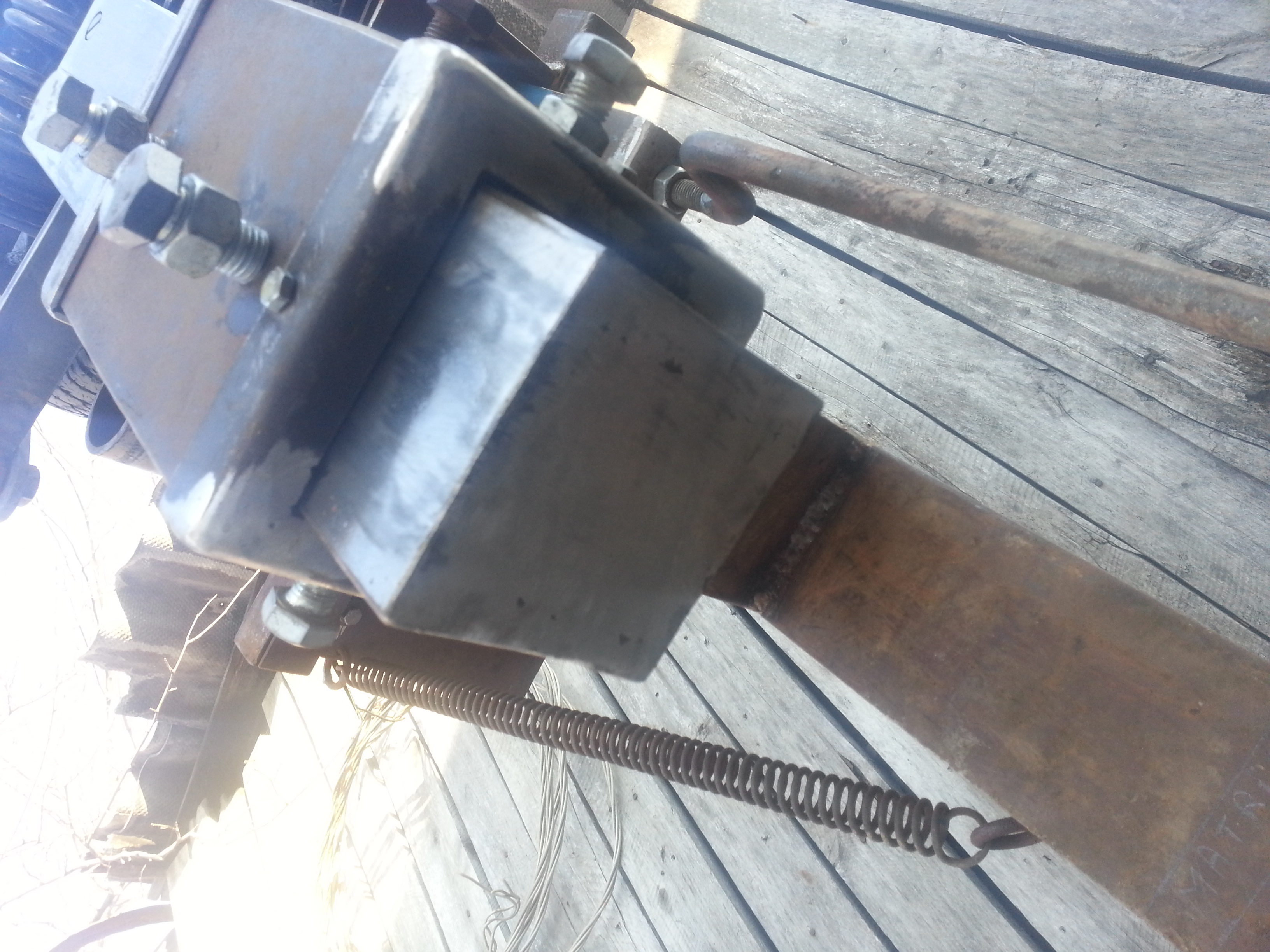

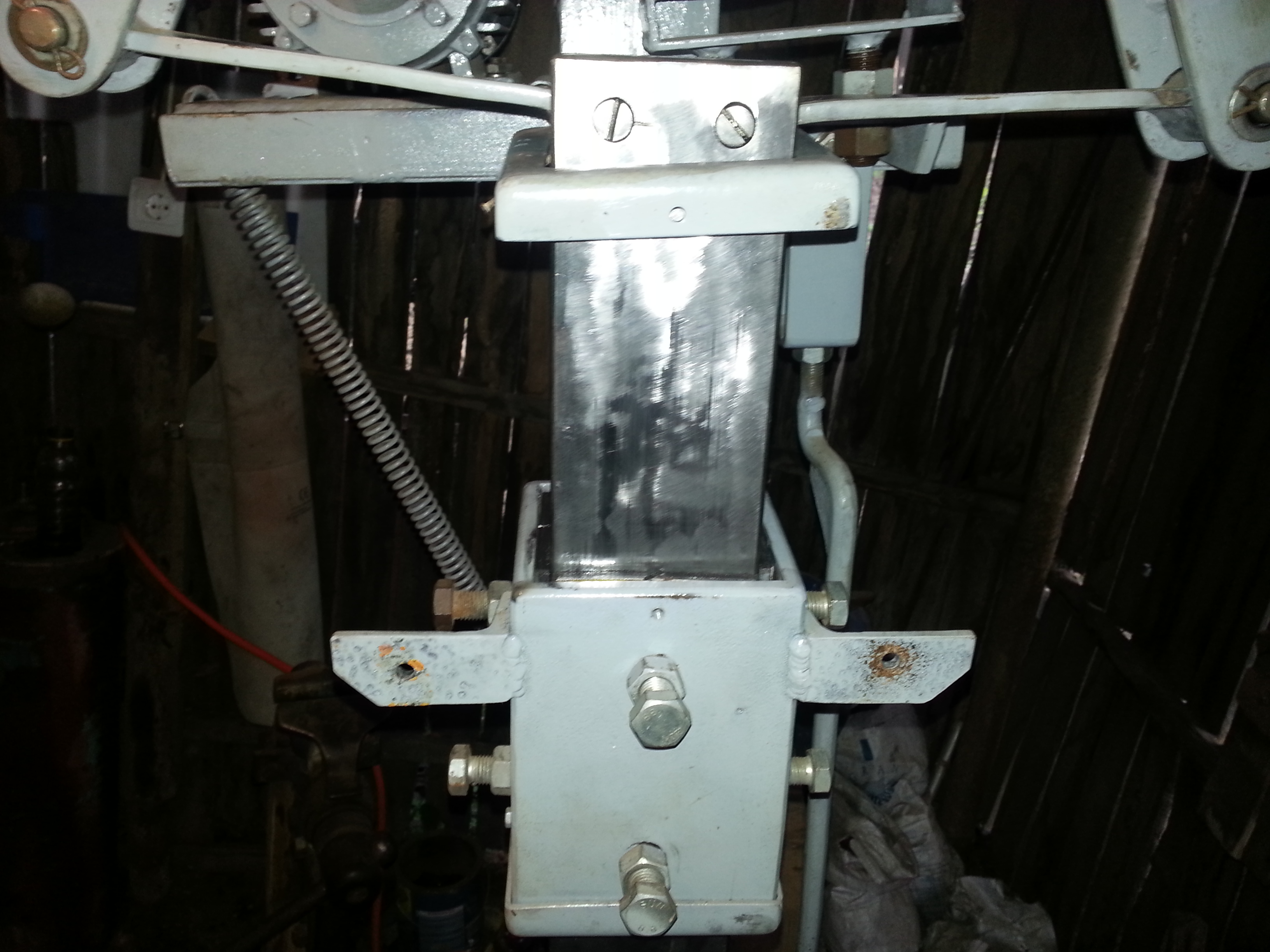

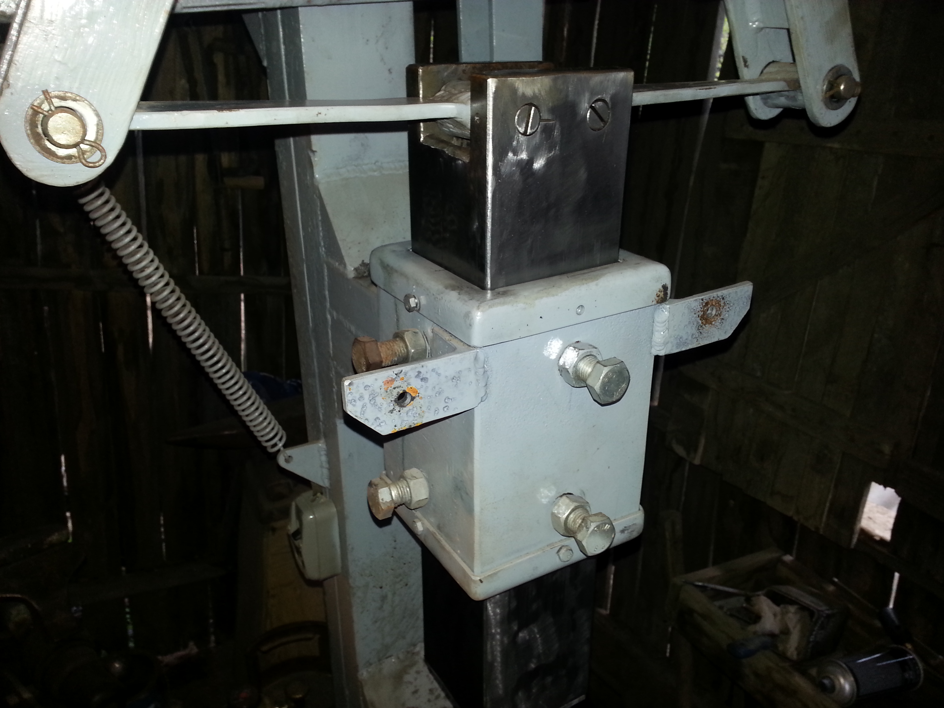

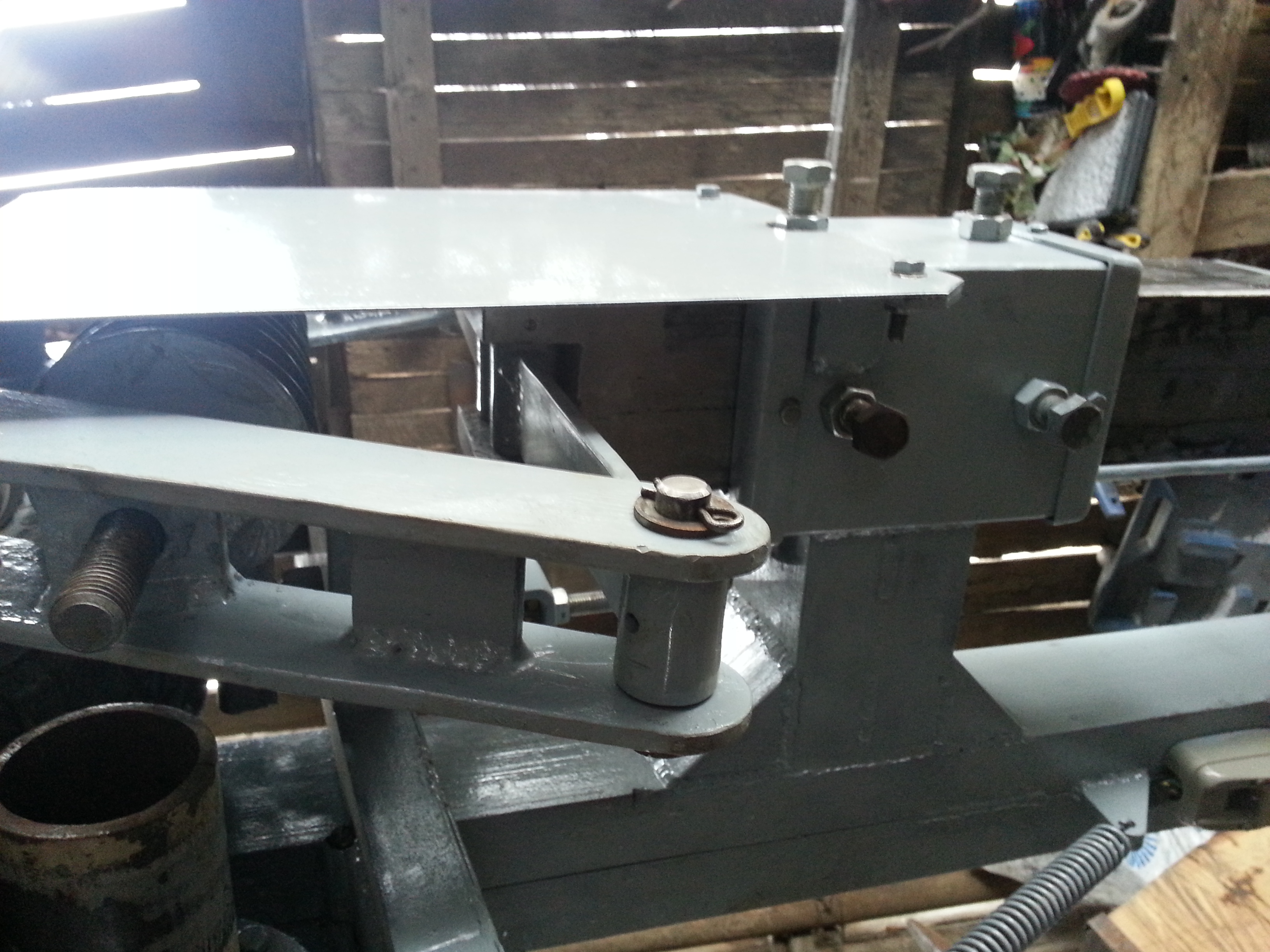

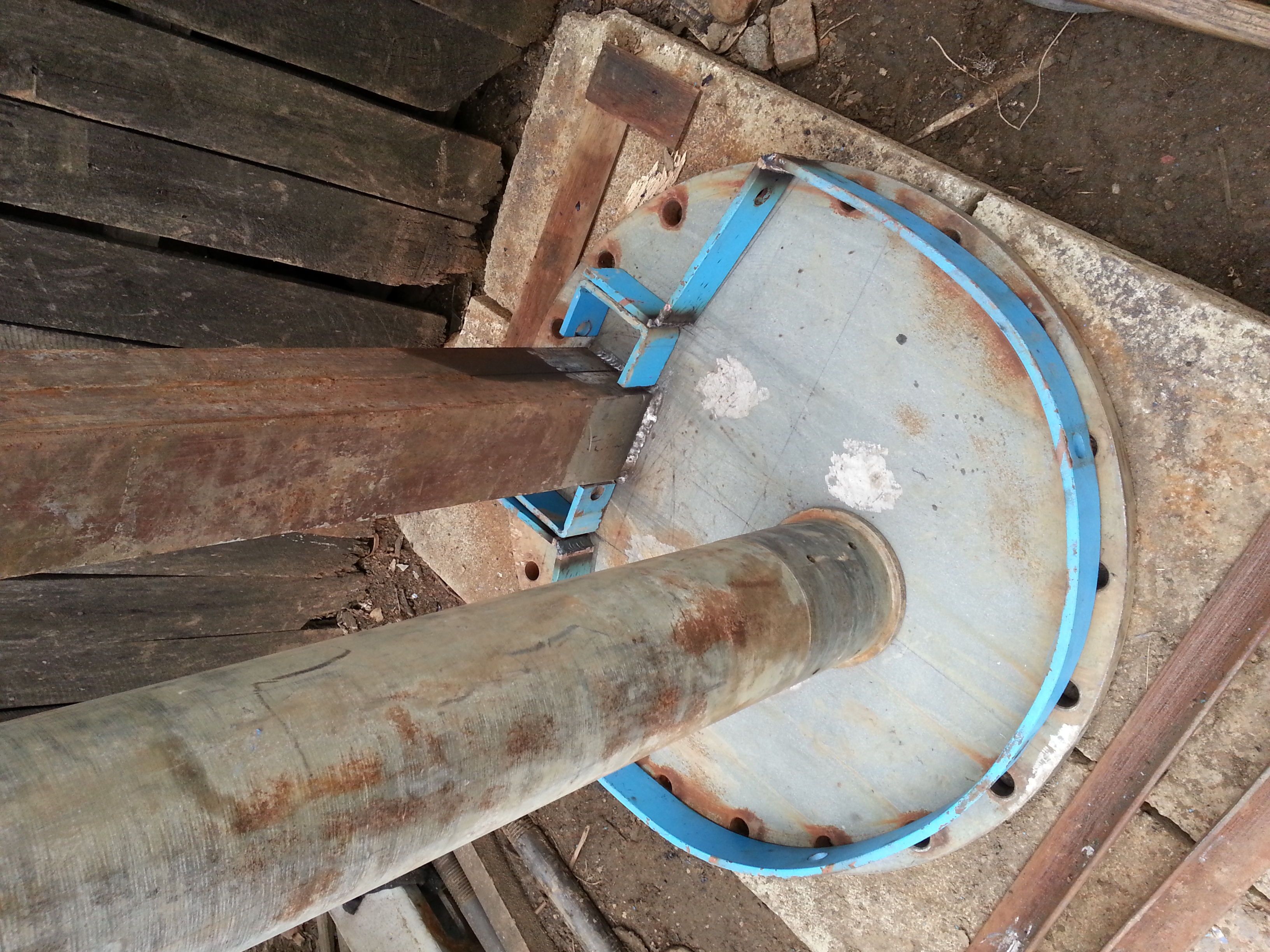

In my case the plates are 4 inches wide,8 inches tall and 5 mm thick poliamide plus 2 mm thick steel plate epoxied on the back,the ram is 4 by 20 inches square tubing but to give it its final weight I forged a piece of steel to fit snugly inside the ram.Than drilled some 1/2 inch holes on all 4 sides of the ram,fitted the piece of steel inside and filled the holes by welding them and also welded all around the lower edge where the two pieces meet but the beauty of building a tire hammer is that if you understand the basic principle of how it works you can adjust the build to the materials you have available.Here is how the wear plates are fitted.Good luck with your build!!! -

Havoc91 replied to Havoc91's topic in Power Hammers, Treadle Hammers, Olivers
Thanks Johan,I made the plates myself,I only bought large enough piece of 5 mm thick poliamide so i can cut 4 wear plates out of it,if it helps i can take some closeup pictures on the wear plates and the way they are mounted. -

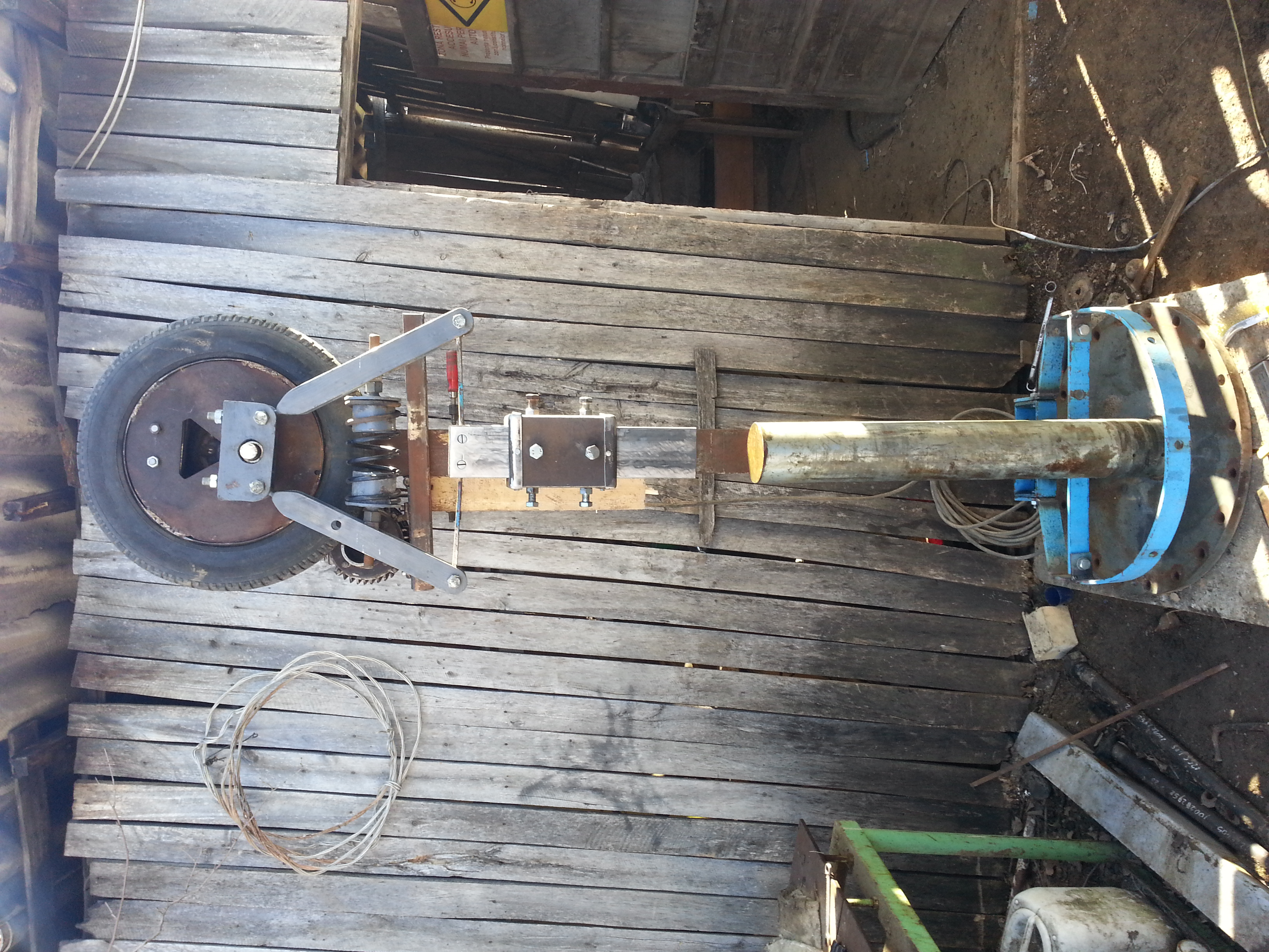

Tire hammer finished at last
Thanks guys!!! It took me about three months but I was only working on my spare time,that would be about two or three days a week and besides the actual building process it took me some time to figure out the system and size ratios as I did not have any plans to work from. -

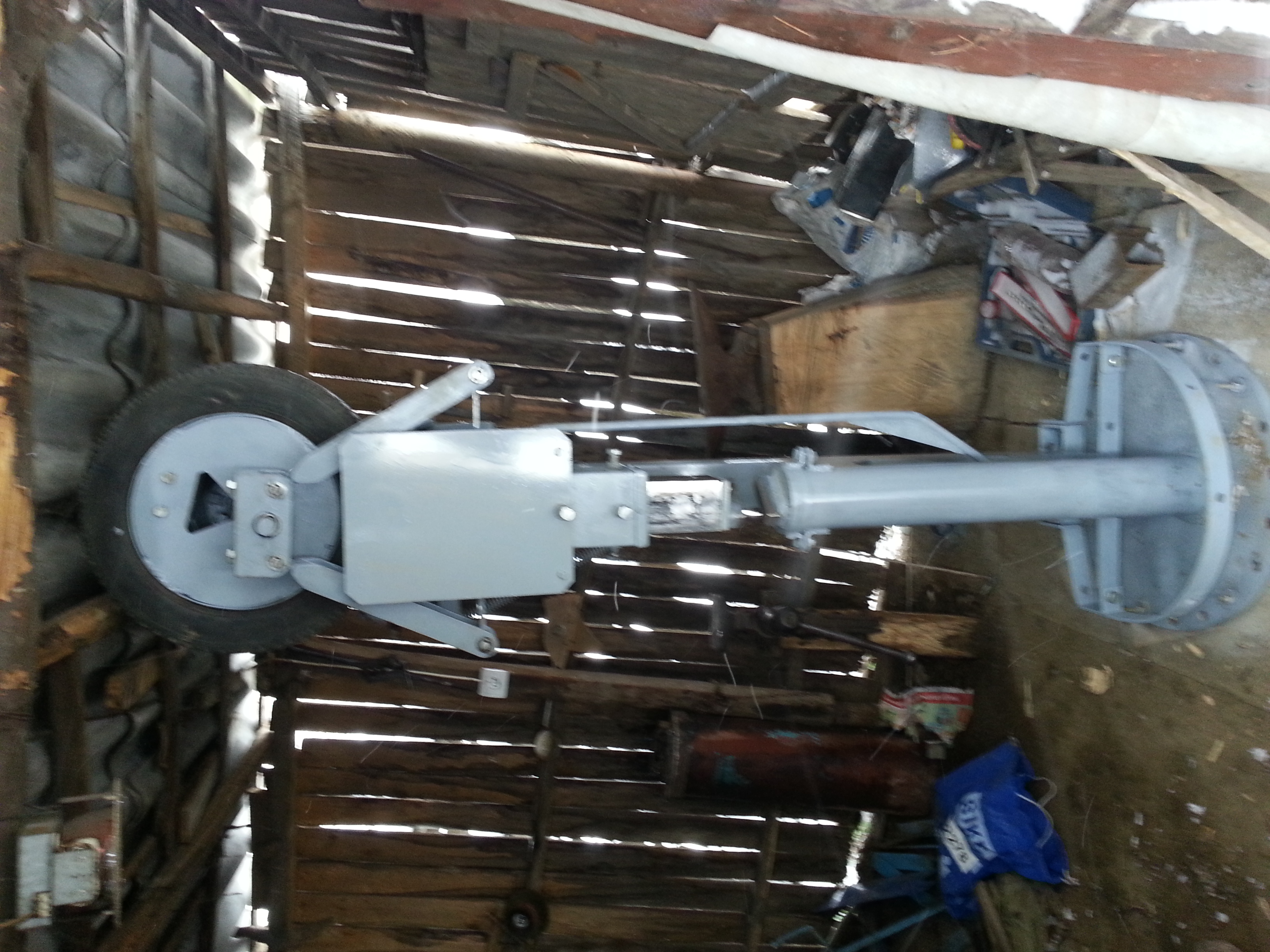

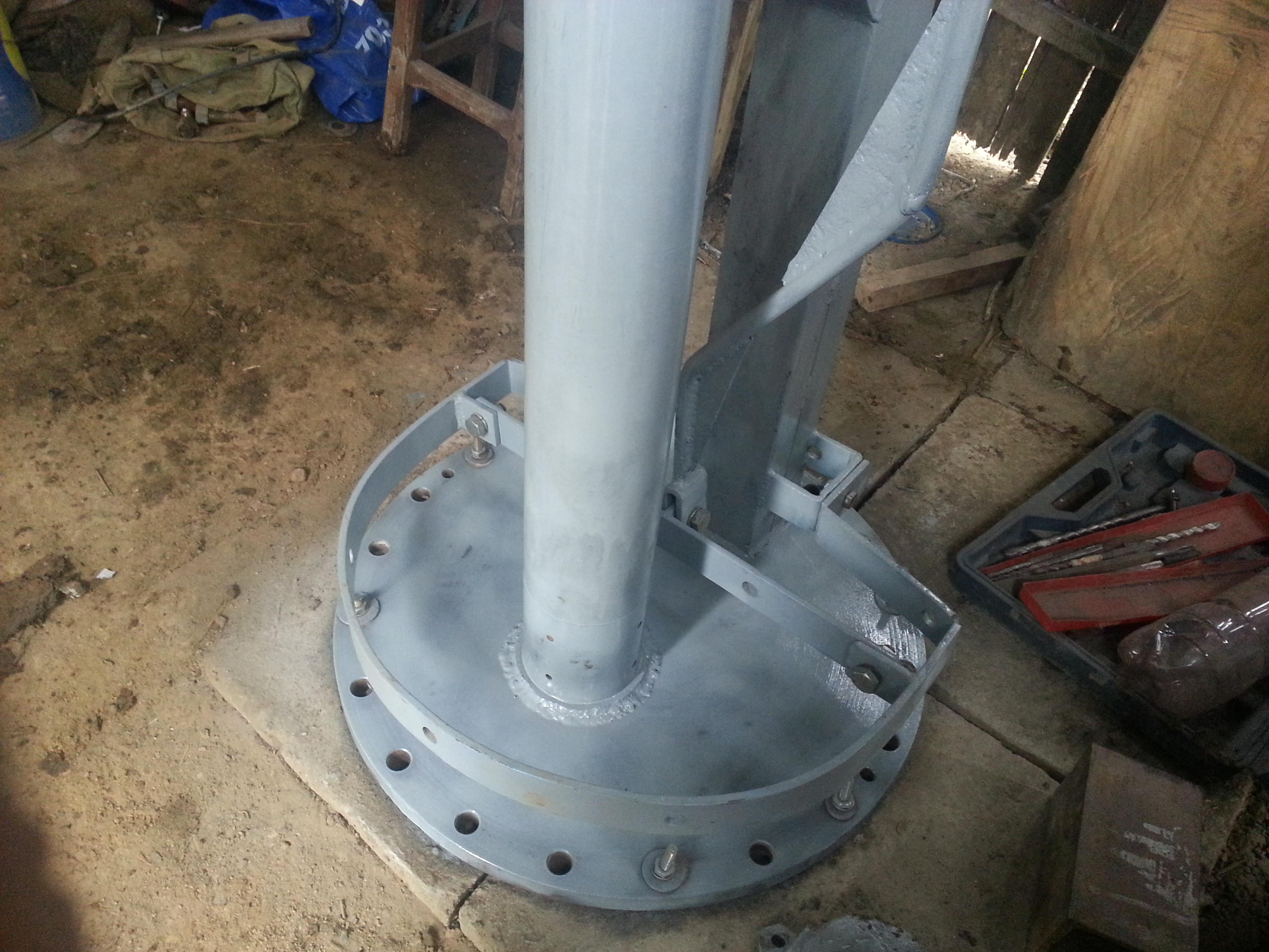

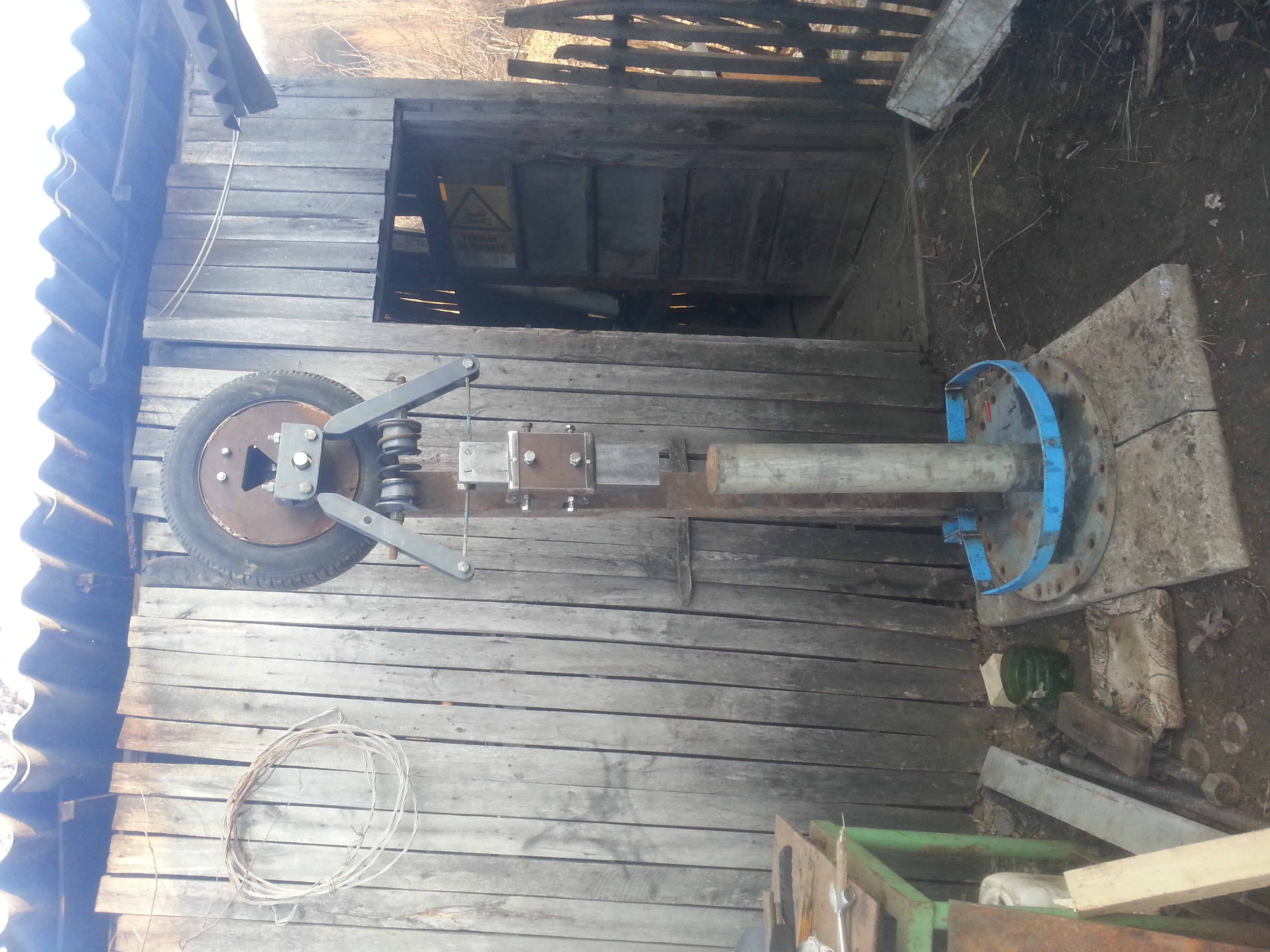

I am really pleased with how she works, the hammer weight is 17 kg without the dies,in the future I will have to pour a concrete foundation and bolt it down better because now it is only bolted do some 10 cm thick concrete slabs and has a lite bit of play in it. -

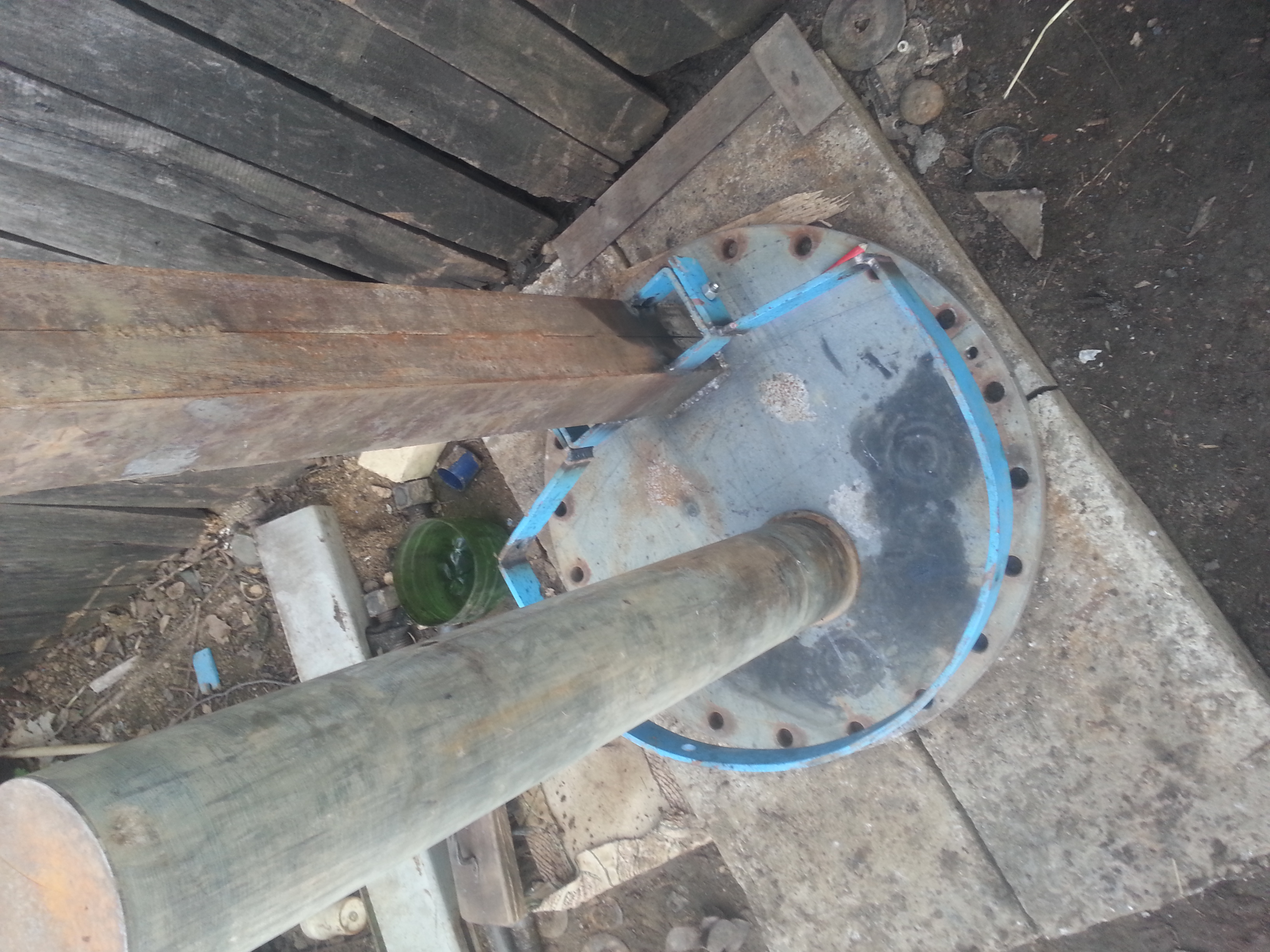

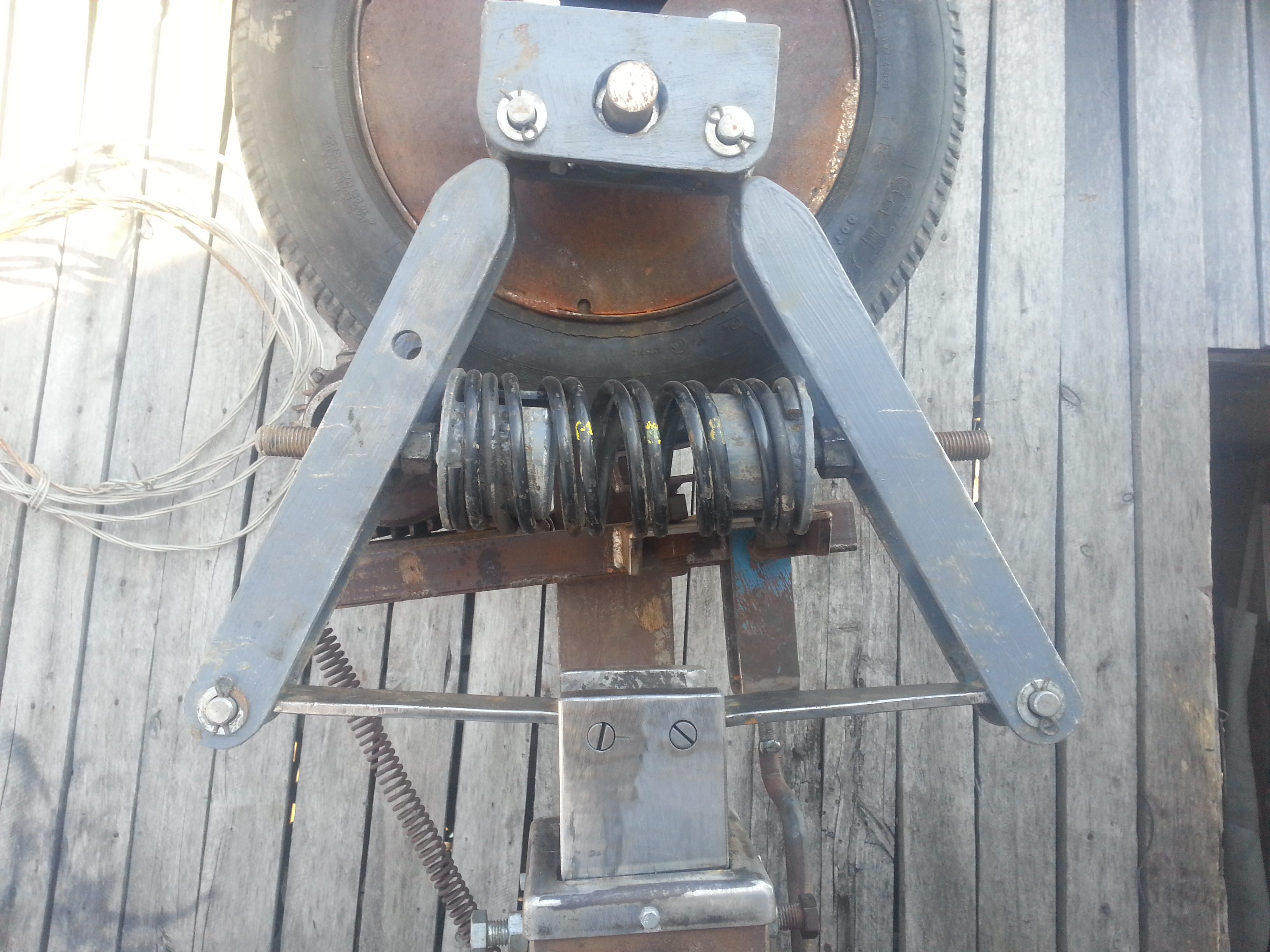

This is my take on the tire hammer! I built it without any plans or precise specifications,I just downloded every picture of a tire hammer that I could find and did a lot if reading on the tire hammer topics.The rest I figured out by myself.I built it only from scrap iron that I had collected for this project in about two years time,the only parts that I had to buy is a bearing and the polyamide wear plates.I also have to go to a machine shop and make a new motor pulley,the one that I have is not machined and has some play in it. This summer I will have to build a new bigger shop, I had to put the hammer inside the old temporay shop to cover it from snow and rain. Here are a few pictures, not very good quality but will give you a idea.

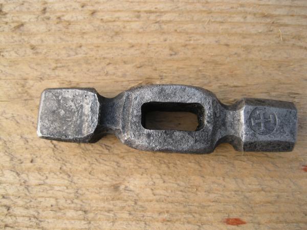

I started with a 8 cm long and 2 cm thick round piece of W-1 tool steel ,the weight of the heads is aprox 200 grams a piece and for the slitting I used the hot set from the other post ,here are a few pics of the tools I used.

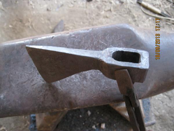

Here are some pics with the handle on it. -

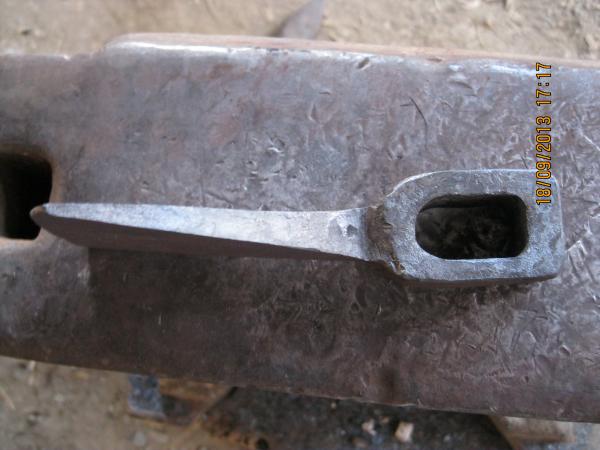

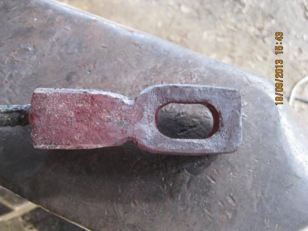

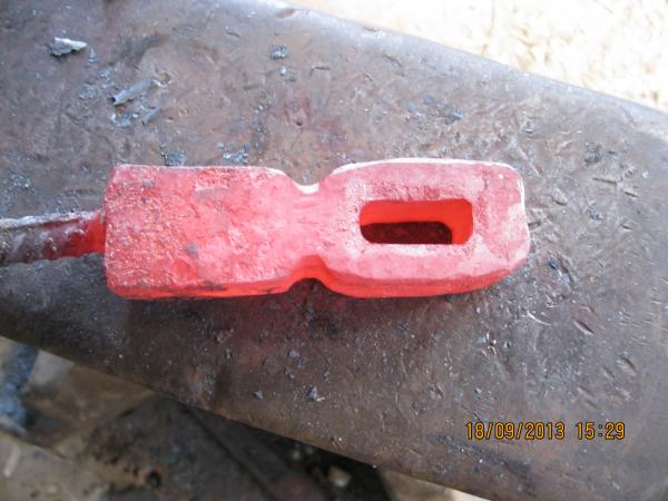

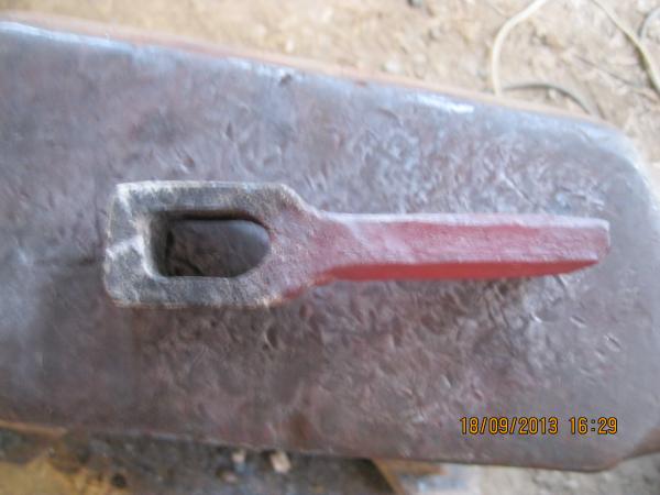

It is forged out of spring steel,no power tools used in the forging process.I started on a round bar,forged on an octogonal shape then i used the slit and drift method for the handle socket and after that I drawn out the chisel point.
