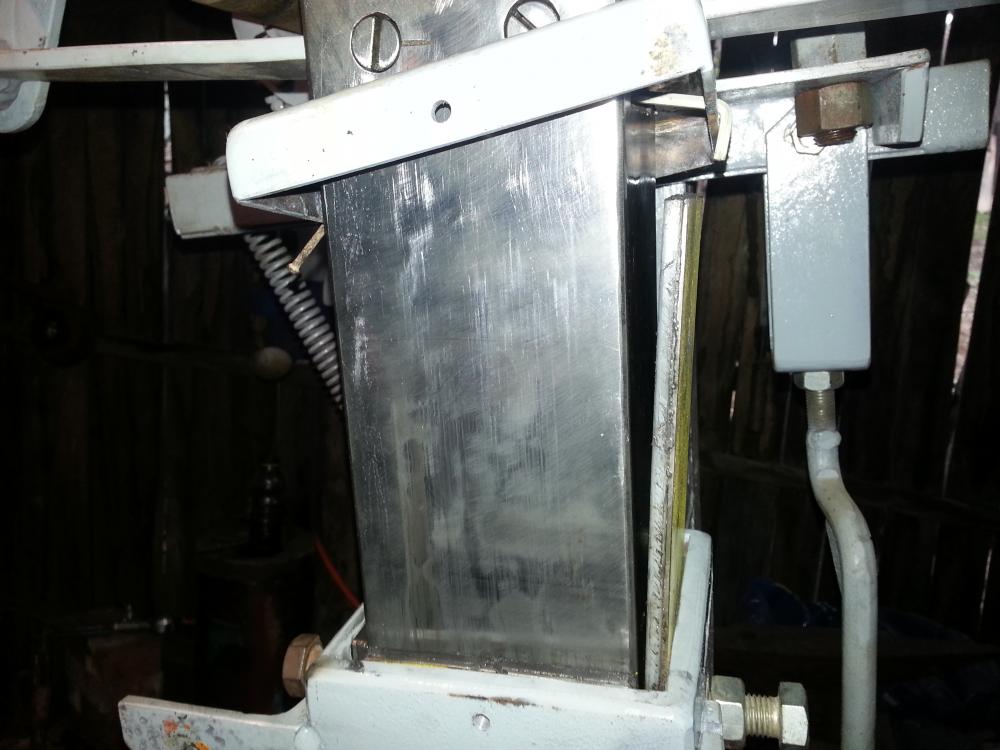

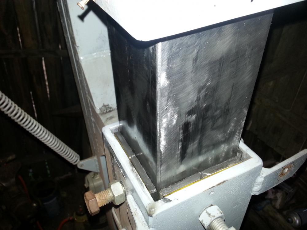

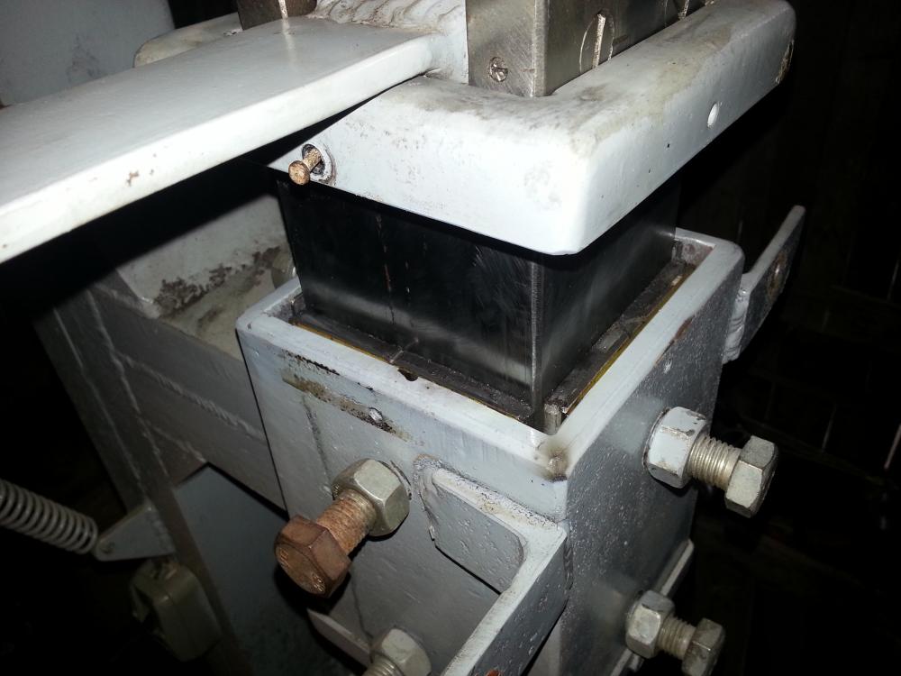

  1. In my case the plates are 4 inches wide,8 inches tall and 5 mm thick poliamide plus 2 mm thick steel plate epoxied on the back,the ram is 4 by 20 inches square tubing but to give it its final weight I forged a piece of steel to fit snugly inside the ram.Than drilled some 1/2 inch holes on all 4 sides of the ram,fitted the piece of steel inside and filled the holes by welding them and also welded all around the lower edge where the two pieces meet but the beauty of building a tire hammer is that if you understand the basic principle of how it works you can adjust the build to the materials you have available.Here is how the wear plates are fitted.Good luck with your build!!!
  2. Thanks Johan,I made the plates myself,I only bought large enough piece of 5 mm thick poliamide so i can cut 4 wear plates out of it,if it helps i can take some closeup pictures on the wear plates and the way they are mounted.

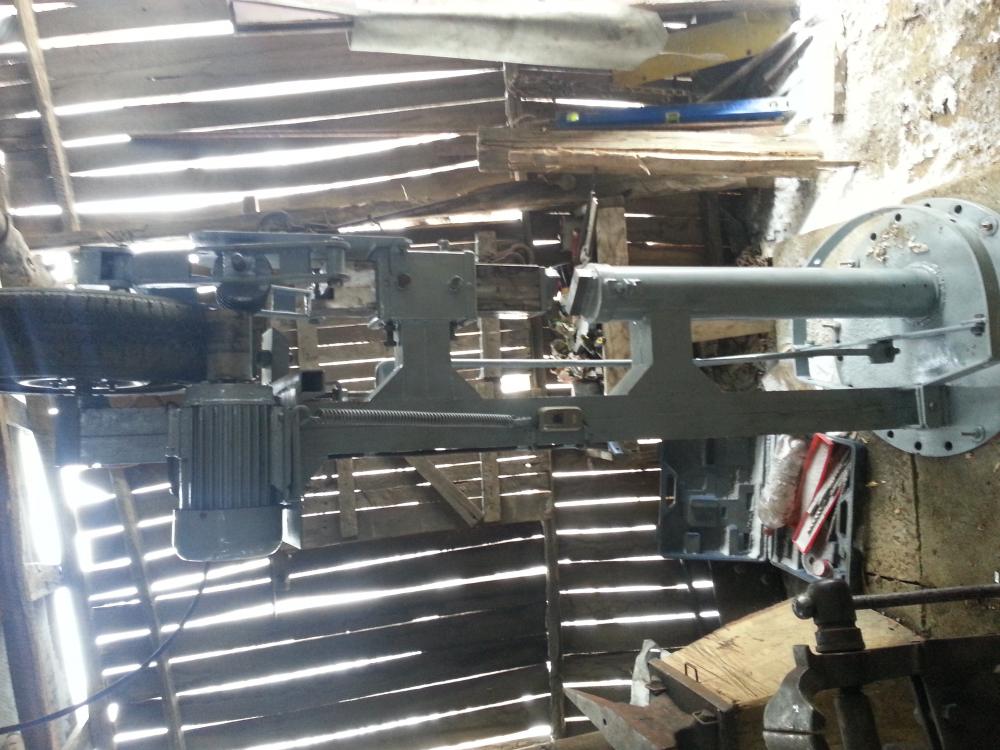

  5. www.youtube.com/watch?v=KzmreOgNkdU Sorry for the delay but I could not reply anymore from my laptop and today I had the idea of tryng from my phone. The quality of the video is not too great but you get the basic idea of how it runs, the bar that I forge is 3,5 cm thick tool steel.

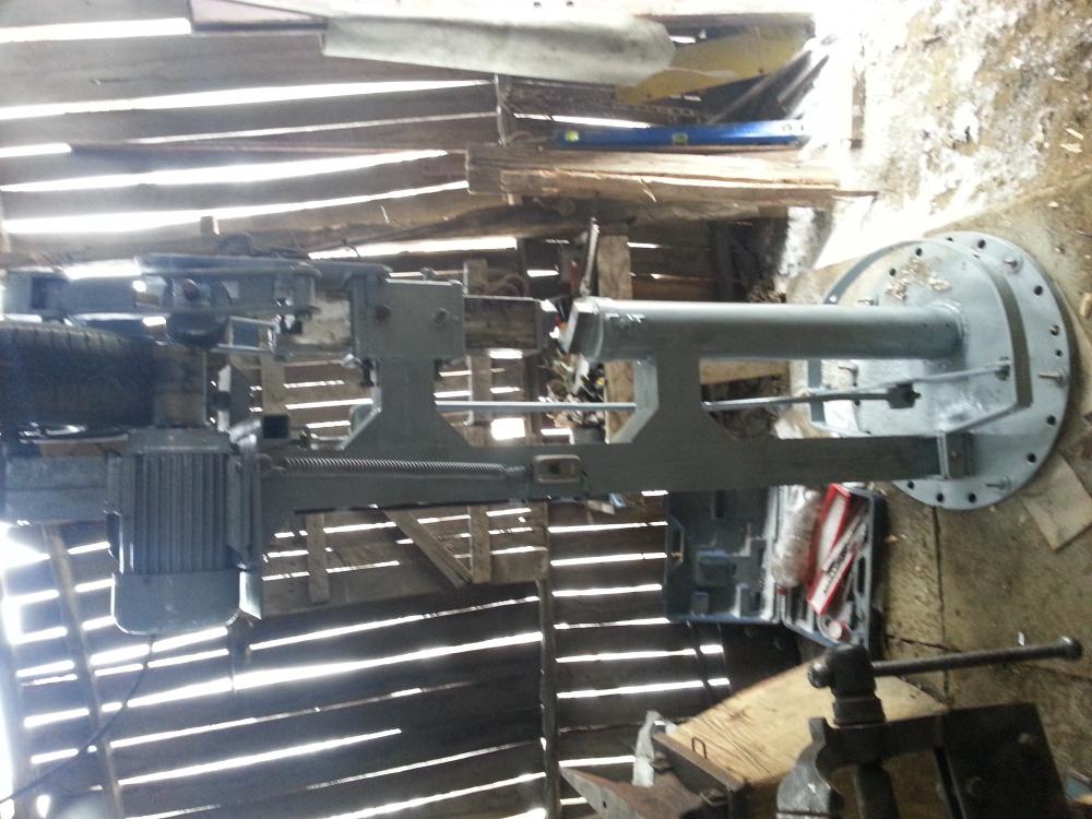

  6. I am really pleased with how she works, the hammer weight is 17 kg without the dies,in the future I will have to pour a concrete foundation and bolt it down better because now it is only bolted do some 10 cm thick concrete slabs and has a lite bit of play in it.

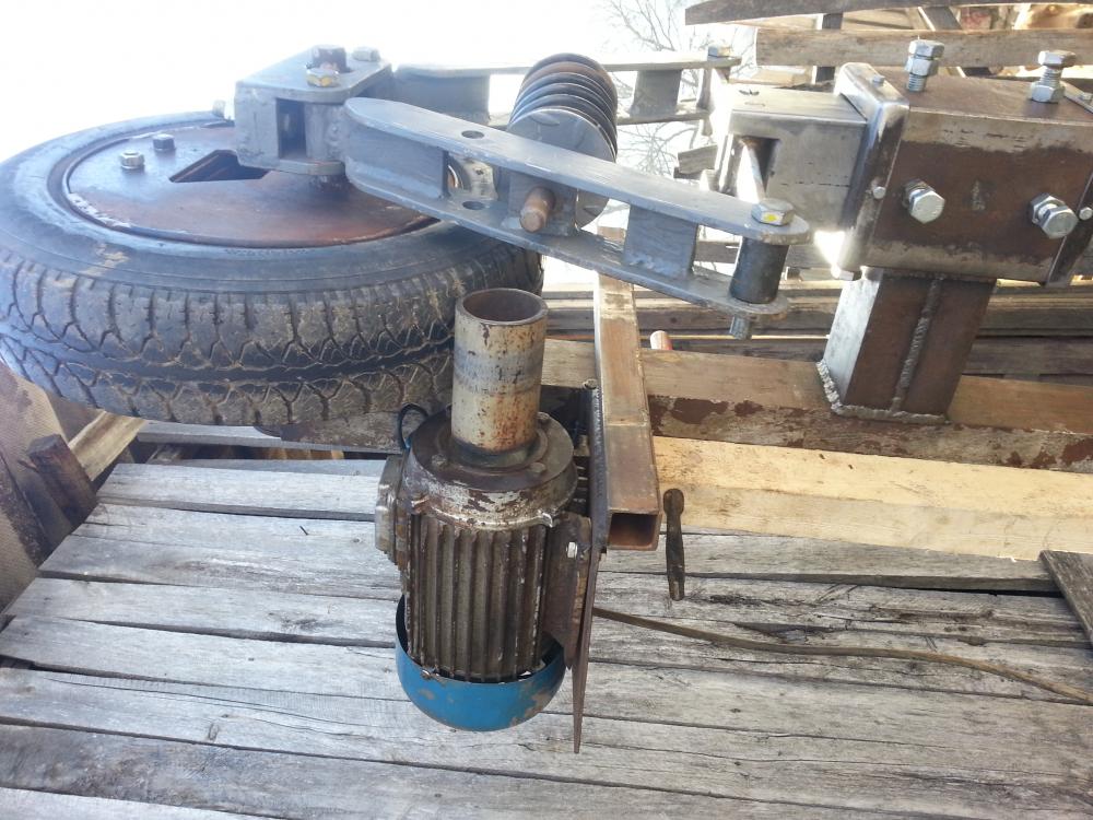

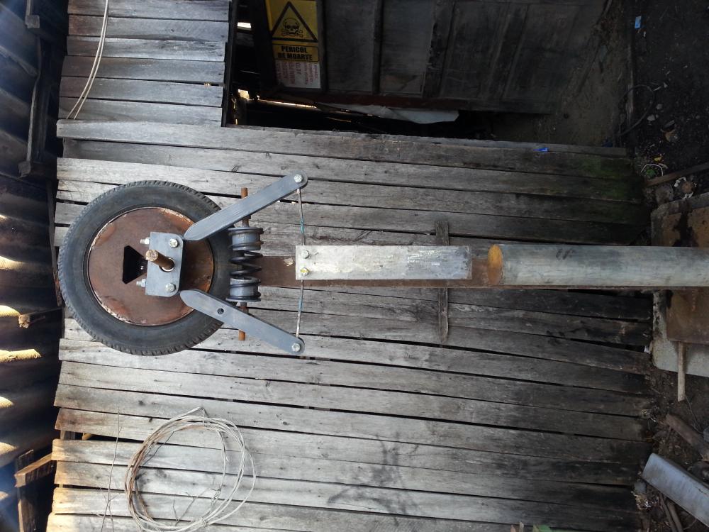

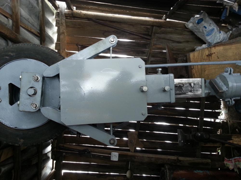

  7. This is my take on the tire hammer! I built it without any plans or precise specifications,I just downloded every picture of a tire hammer that I could find and did a lot if reading on the tire hammer topics.The rest I figured out by myself.I built it only from scrap iron that I had collected for this project in about two years time,the only parts that I had to buy is a bearing and the polyamide wear plates.I also have to go to a machine shop and make a new motor pulley,the one that I have is not machined and has some play in it. This summer I will have to build a new bigger shop, I had to put the hammer inside the old temporay shop to cover it from snow and rain. Here are a few pictures, not very good quality but will give you a idea.
