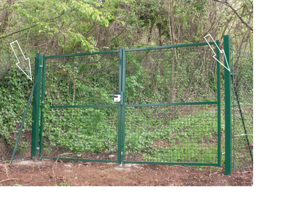

hello I should make a gate to close the passage in an agricultural land. for economic reasons of transport I should make it modular like Meccano or instead of welding the doors I should bolt them and then screw them into the ground, they will transport it with a small jeep the land is in an impervious terrain any ideas to make it removable without welding thanks.cancellosentieropodere.thumb.png.0d2134ad37dc2f4c0631f2af48465f92.png
The one in the picture should do what you want just fine whether you buy one of make a copy.
I'd maybe put angle braces on both sides of the gate posts but that might be over doing it.
If you want it sturdier spiking the angle braces and gate posts to the ground will make a big difference and if you move it you can pull the stakes with a pry bar.
