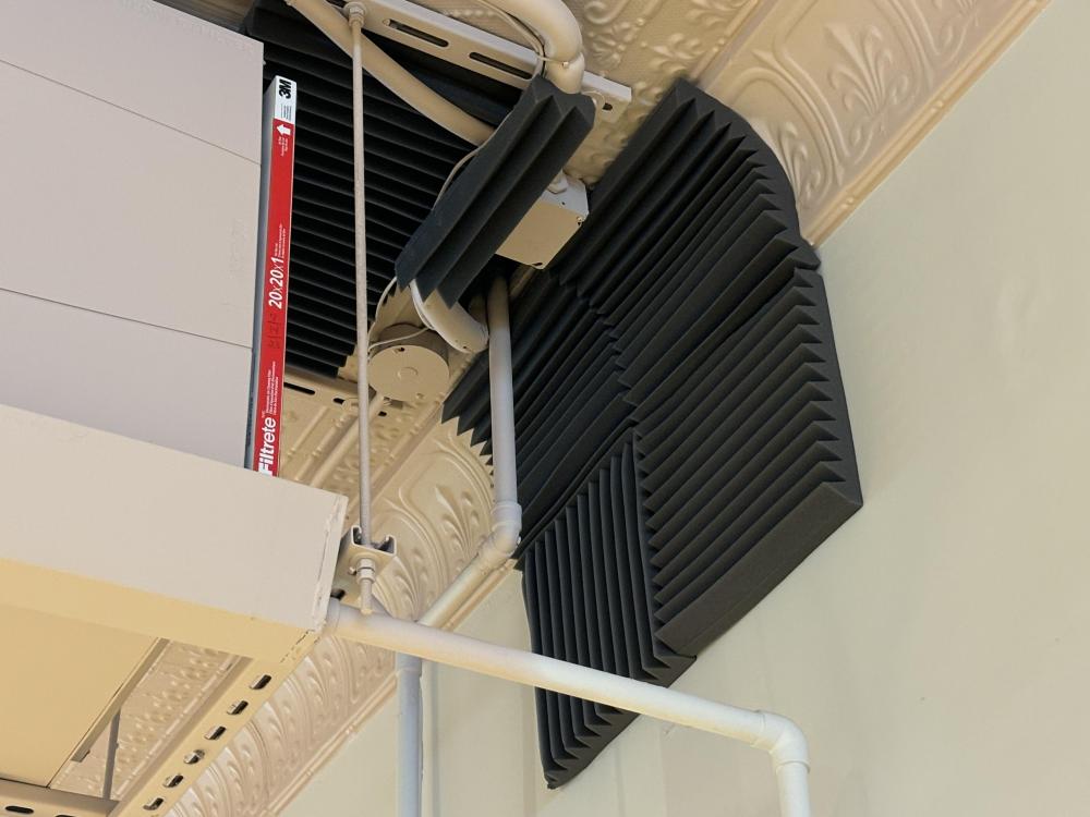

Need Help with Sound Reduction
Jon,
If you can get me a copy of the Test and Balance report and  a link to the IOM manual, I should be able to walk you through changing the fan speed.  Should be well within your capabilities, but i understand if you don't want to potentially make yourself liable for any unit failures.
I can ask the landlady.
On 8/18/2024 at 12:41 PM, BillyBones said:
JHCC, have you any info on who did the installation? There maybe some kind of service agreement with the unit that they will come out and look at it for free.
I had a chat with the landlady today, who says (A) that she won't do any more business with the company that did the installation, but (B) that I am welcome to open it up and make adjustments.
I'll see how things go with the addition of sound-absorbing material, and if there's further reduction needed, we can explore the option of changing the settings.
The sound absorbing foam panels have arrived and are awaiting installation.
They come vacuum-packed, so you have to let them expand overnight before installation. More to come....
First panels are up. Hard to tell from the decibel meter, but there's already some noticeable improvement (which is to say, people can have a normal conversation nearby even when the AC is running).
We’ll see how things go with the addition of the “floor” to the open space. Looks like the filter could use replacing as well.
They might be fun to paint if it didn't un-damp the sound.
A clean filter should reduce the work the blower has to do and reduce noise proportionally.
The plywood I plan to use for the "floor" is already painted the same color as the wall, and the "wood wool" panels I want to use for baffles on the sides will be hiding most of the foam from view.
That's not what I meant John. I was thinking of painting each fin thingy, a contrasting color on opposite sides. That way the overall color(s?) would change when you move. Oooh, it could look REALLY cool if they vibrate or shiver when the AC is running.

Only using plywood for the floor, and its inside/top surface will be covered with the same foam panels as shown on the wall and ceiling.
stupid question, and just point out the obvious I think.  But how recently was the filter changed? The date written on the side looks like 2023?

Cut out the plywood, bolted it in place, and added its sound absorbing foam, filling in a couple of bits on the wall as well. Also changed the filter.
Result: TOTAL SUCCESS. Significant difference to the ear, and a 10 dB drop on the meter. I may not even bother with the side baffles, except perhaps for cosmetic reasons.
10 dB drop is a huge improvement.  Might be another career in this for you if you aren't careful....
