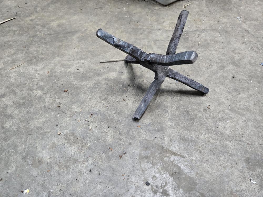

Today's forging. From a challenge from Peter Braspennix.  Tough to do in general, and harder in a gas forge20240810_184244.thumb.jpg.718fe9708f4bcc931af504d59080e102.jpg
Looks like a challenge, how many welds?
Two.  Would have been better executed in a coal forge, but mine isn't setup yet.

You are on the right track.  Starting stock is 4" of 1" square bar.  There are more than one solutions.

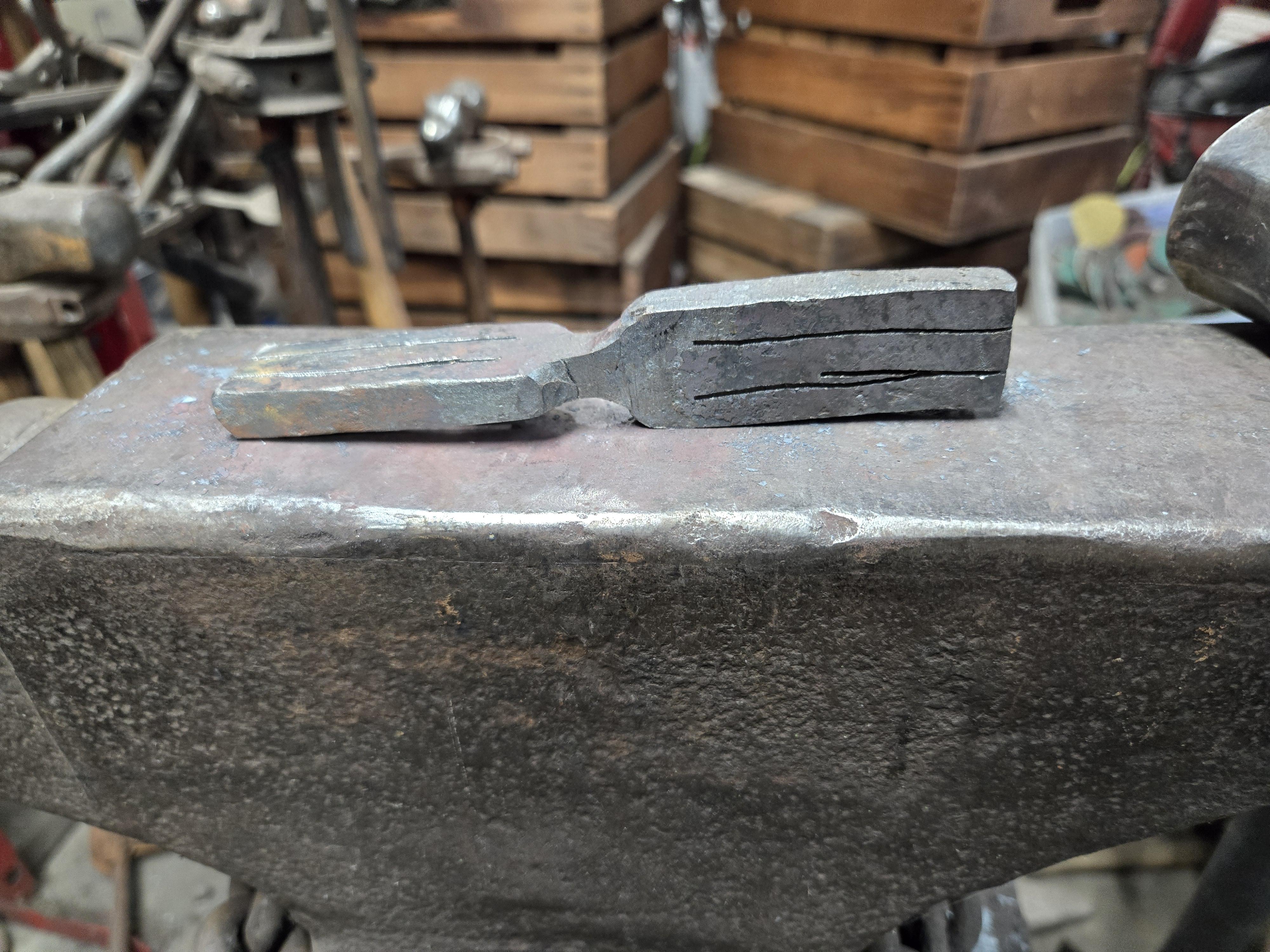

I'm thinking you take the bar and forge half the bar to half in. thick one way, turn a quarter and forge the other half to half in. thick the other way overlapping the center to make it half in. square. Then make the two cuts in each half. Spread it open and forge out the tines then fold the outers to the opposing ends and forge weld the ends.

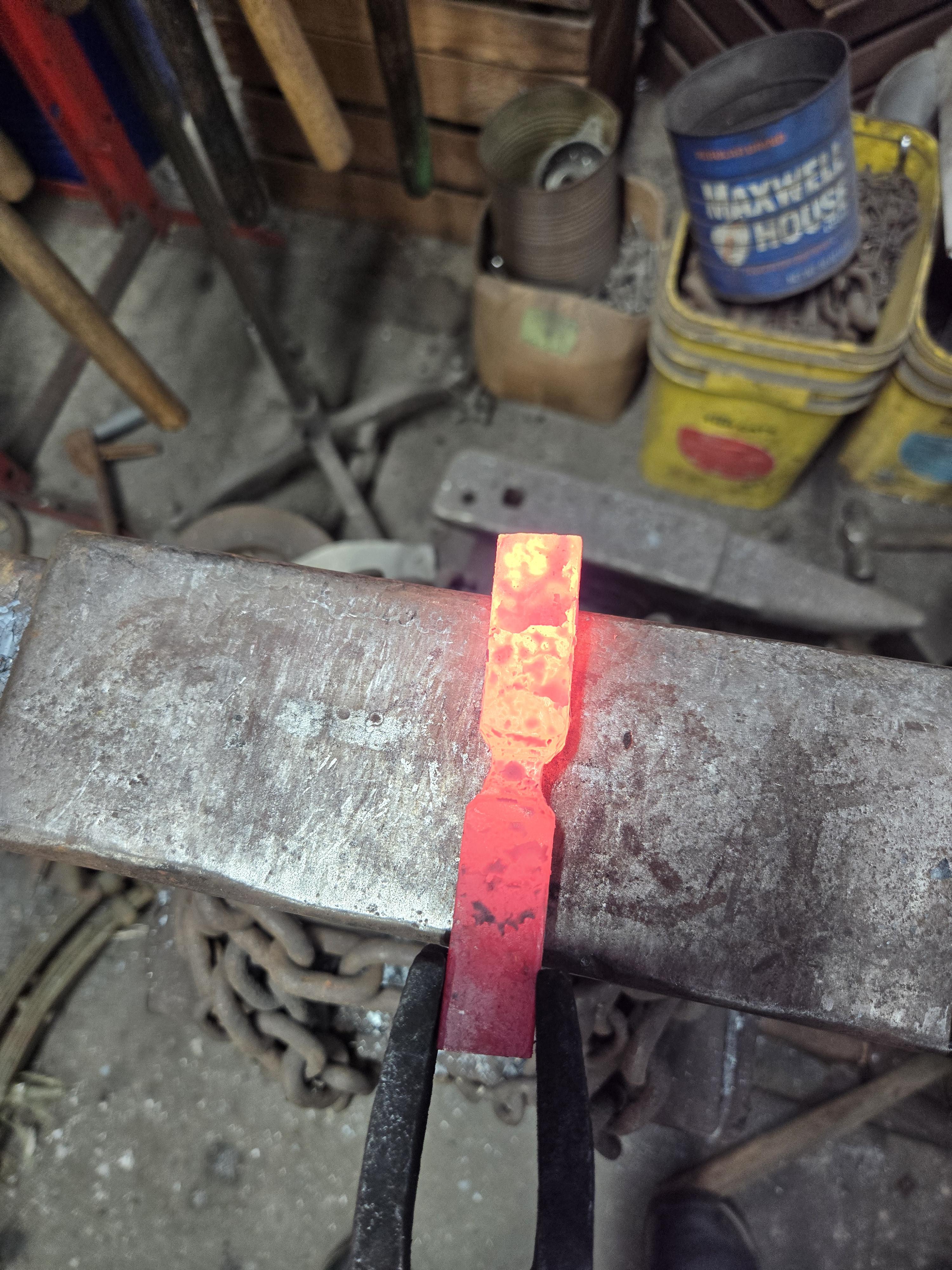

I have changed my opinion to thinking the center of the bar is fullered before other work. Soon as the kids get to bed I might get a chance to try it.

Sounds, and looks, like Aric is all over it! With the correct dimensions in my head, I would have approached it the way he has (although I admit I would not have thought to fuller the centre in first. That's insightful.)

By golly Aric, I believe you've got it!
I have to say I kind of like the demented caltrop preform almost as much as the finished example.

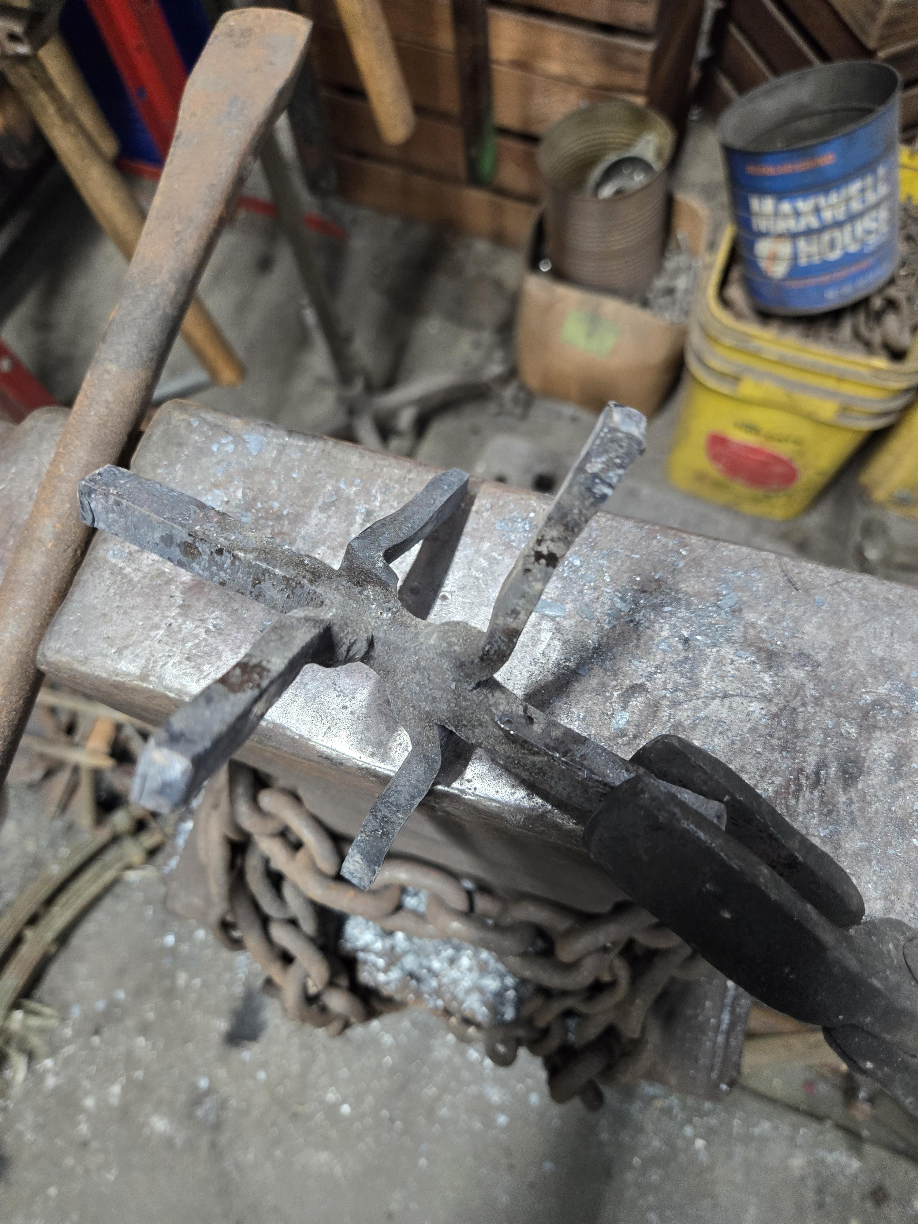

Yes, that is basically the way I did it.  Of course part of the difficulty was getting it in and out of my 4" square forge opening once the "legs" were drawn out and keeping everything clean and symmetrical.
The technique I use when spreading segments of a forging interfere with getting it in and out of the forge is to spread only one thing enough to work on at a time.
For example on this piece, after cutting the sections I'd work one swoopy arm on one end by spreading them like your fingers bend exposing the center piece rather than to a 90 from it.  After forging the other swoopy arm draw the center point out. Bend everything back in plane and repeat on the other end. Once everything is forged in the preform bend the arms around and forge weld them to the center points.
Otherwise the only good way I can think of to heat the piece like you did it is with a brick pile forge and take the forge off rather than put it in and take it out.
A solid fuel forge would make things a lot easier but I use propane and solve problems from that point of view.
Frosty,
I could (and probably should) have used "convenience" bends to allow me to put the different legs into the forge opening more easily, but there were certain conveniences involved in having the opposing arms in line to allow clean drawing out.  I jiggered it around to heat sections, but it would have been so much easier with a solid fuel forge.  I definitely did the enhanced caltrops style like Alric, but put a lot of effort into radiuses and transitions to keep things proportional and relatively symmetrical.  Was very satisfying once I got it all bent up and could get it back into my forge further for the forge weld.

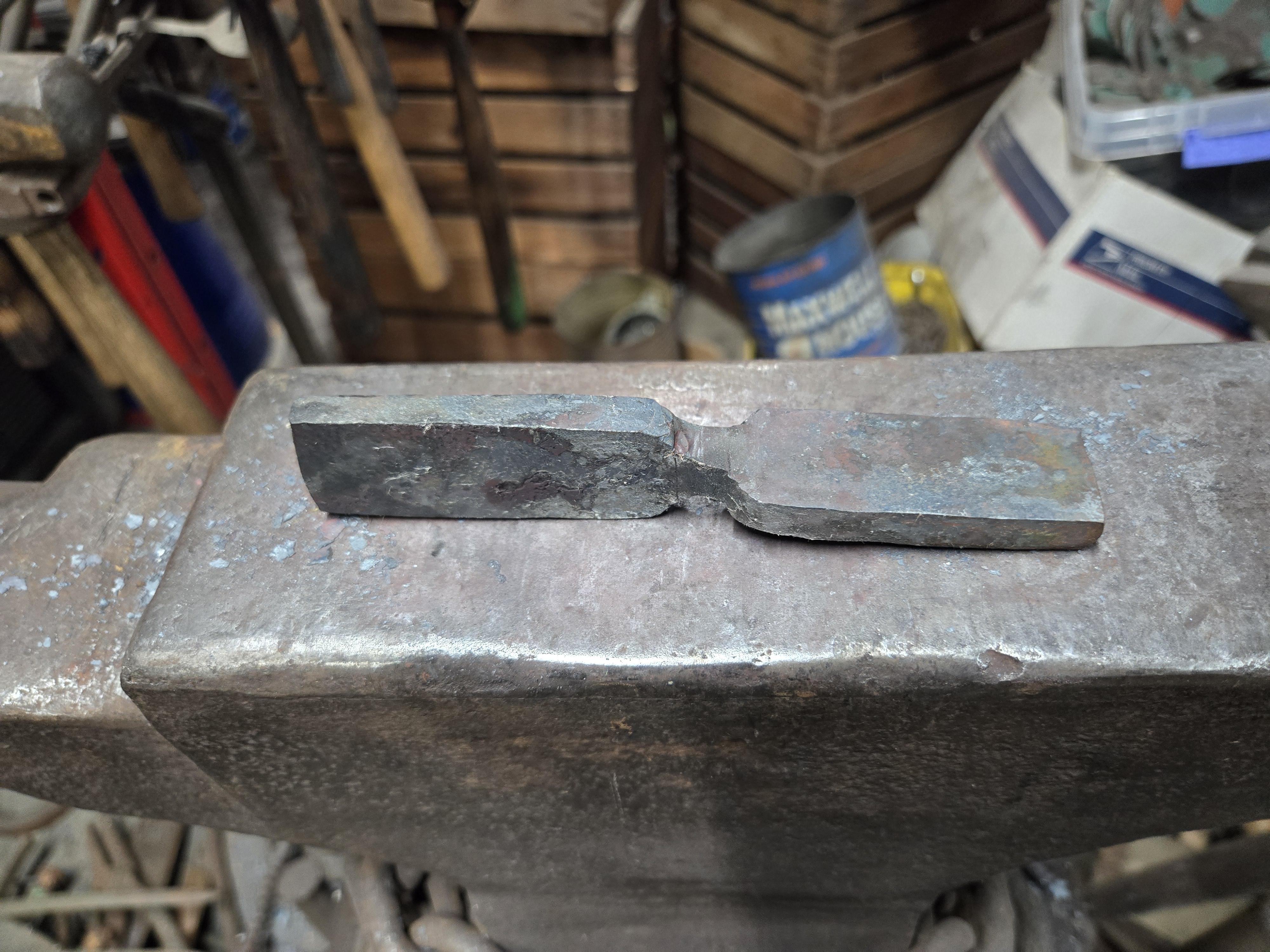

It was a tired attempt lol. The branch joints need tidied up. Also I used 3/4" as that's what I had handy without digging around. I was beat tired from the day so that is all the further I got. It isn't a clean attempt but I'm glad to have got it out of my head lol. Not sure when I will finish this but I'd like to figure a way to refine the joints of the arms. A couple things come to mind. It certainly is an awkward piece to maneuver.
Latticino, I have a new appreciation for how clean your forging of this is. The only reason I see for a gas forge not being better for this is it's size and shape. Other than that it is also a bit of a challenge in my coal forge but I see the hardship of fitting it in a gas forge.
Larry, I think it is more of getting the 3 ends lined up on each end and welding them together at one time. So sort of, but it would be 2 forge welds since each end would be forge welded at one time.
