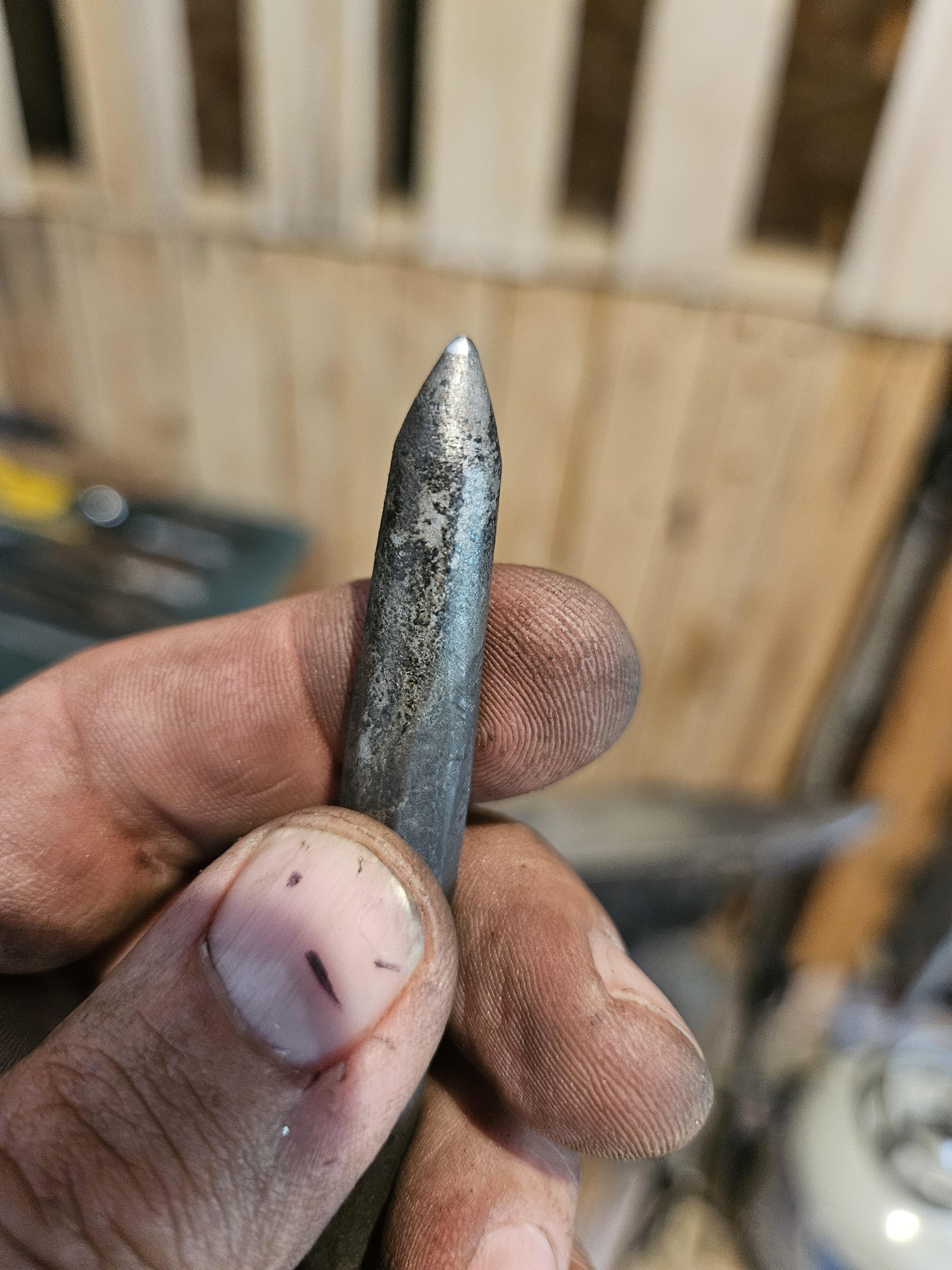

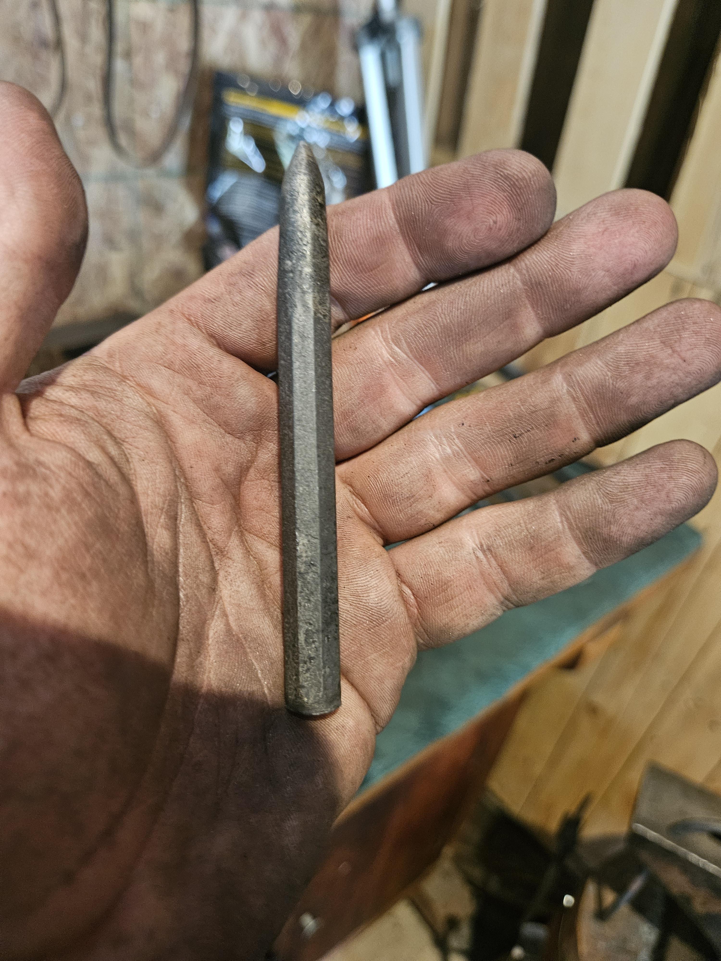

I successfully heat-treated a center punch!  This punch was inherited from my Grandfather, one of many tools that I could not do any of this hobby without him.

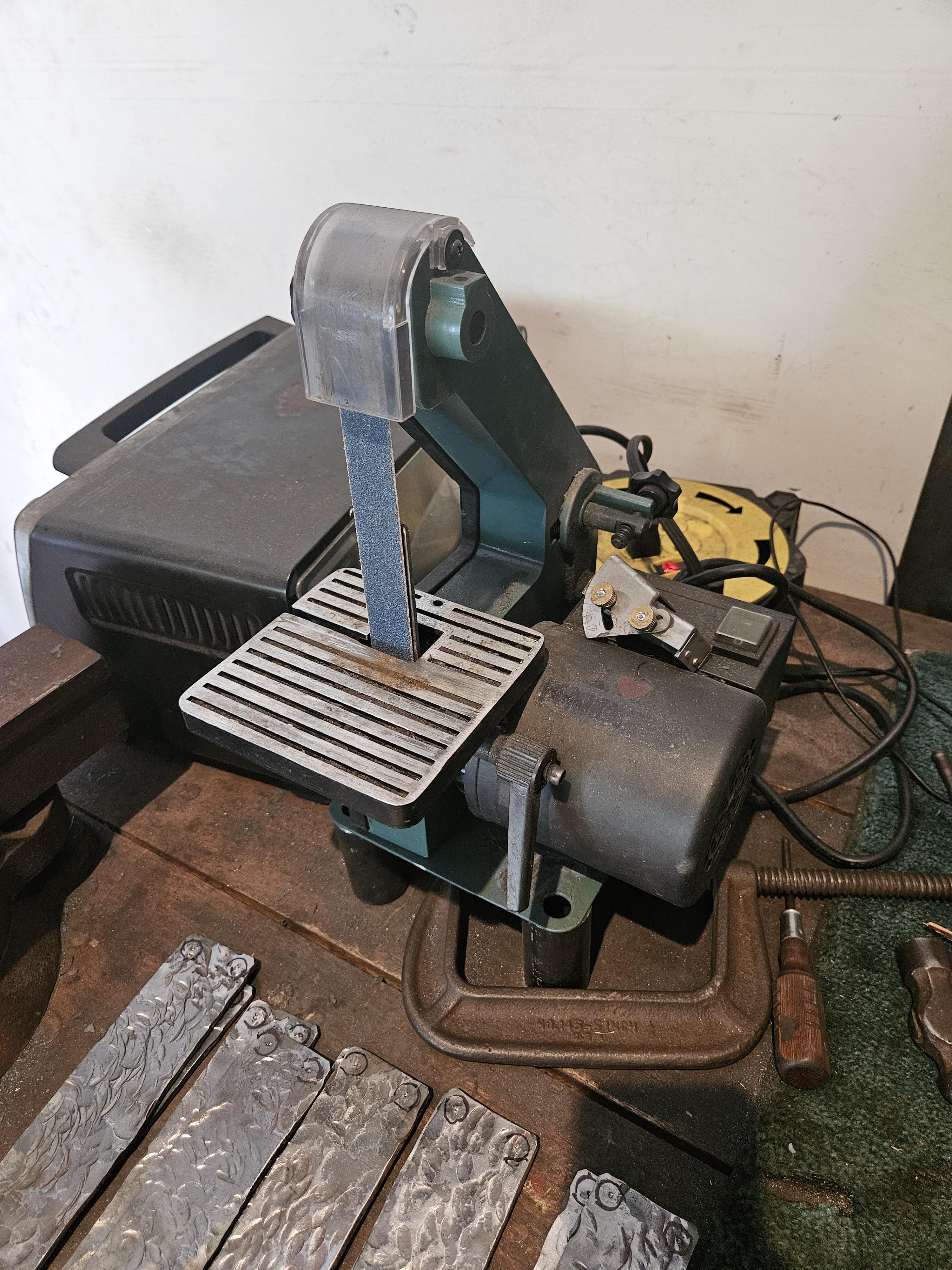

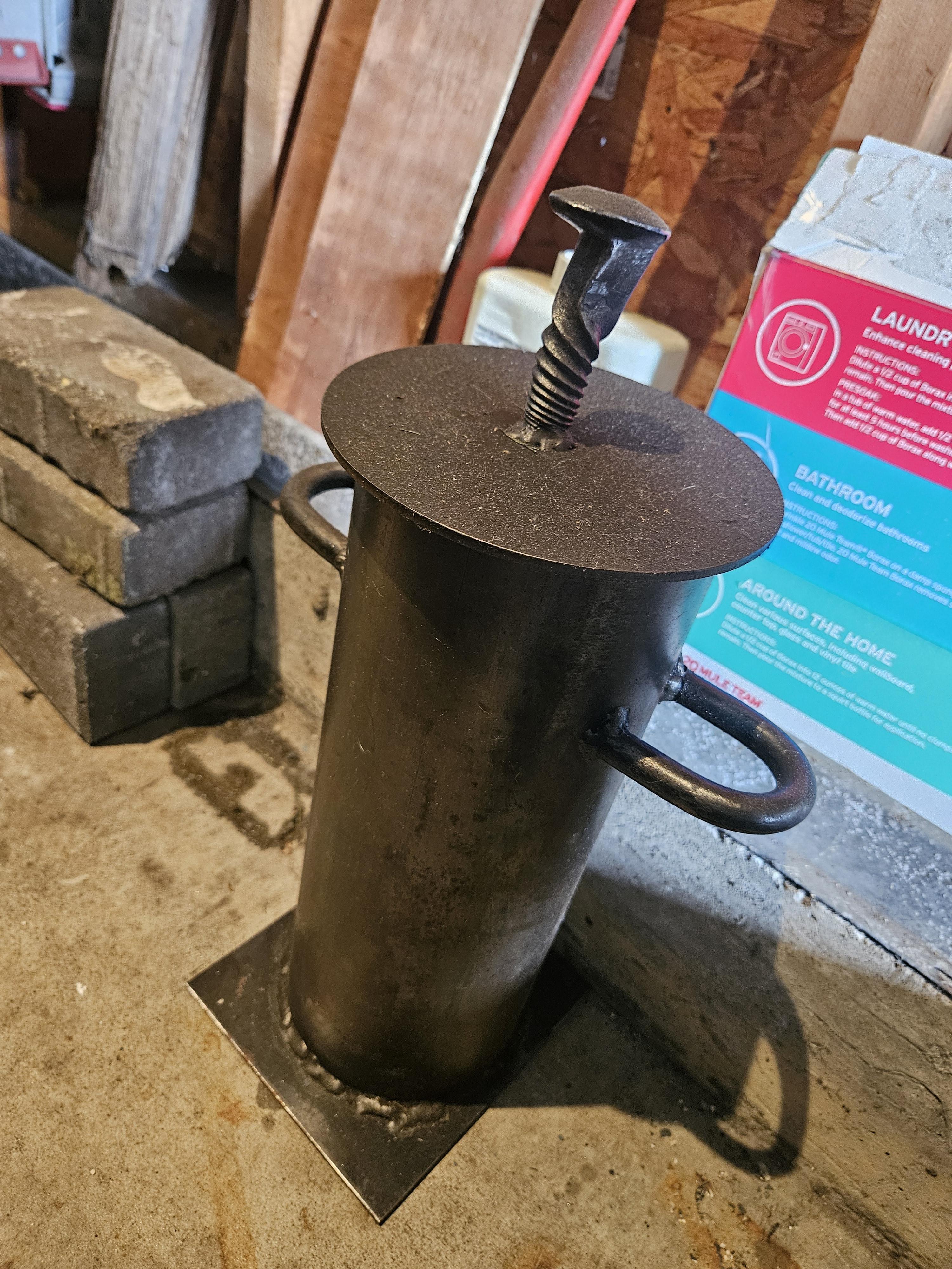

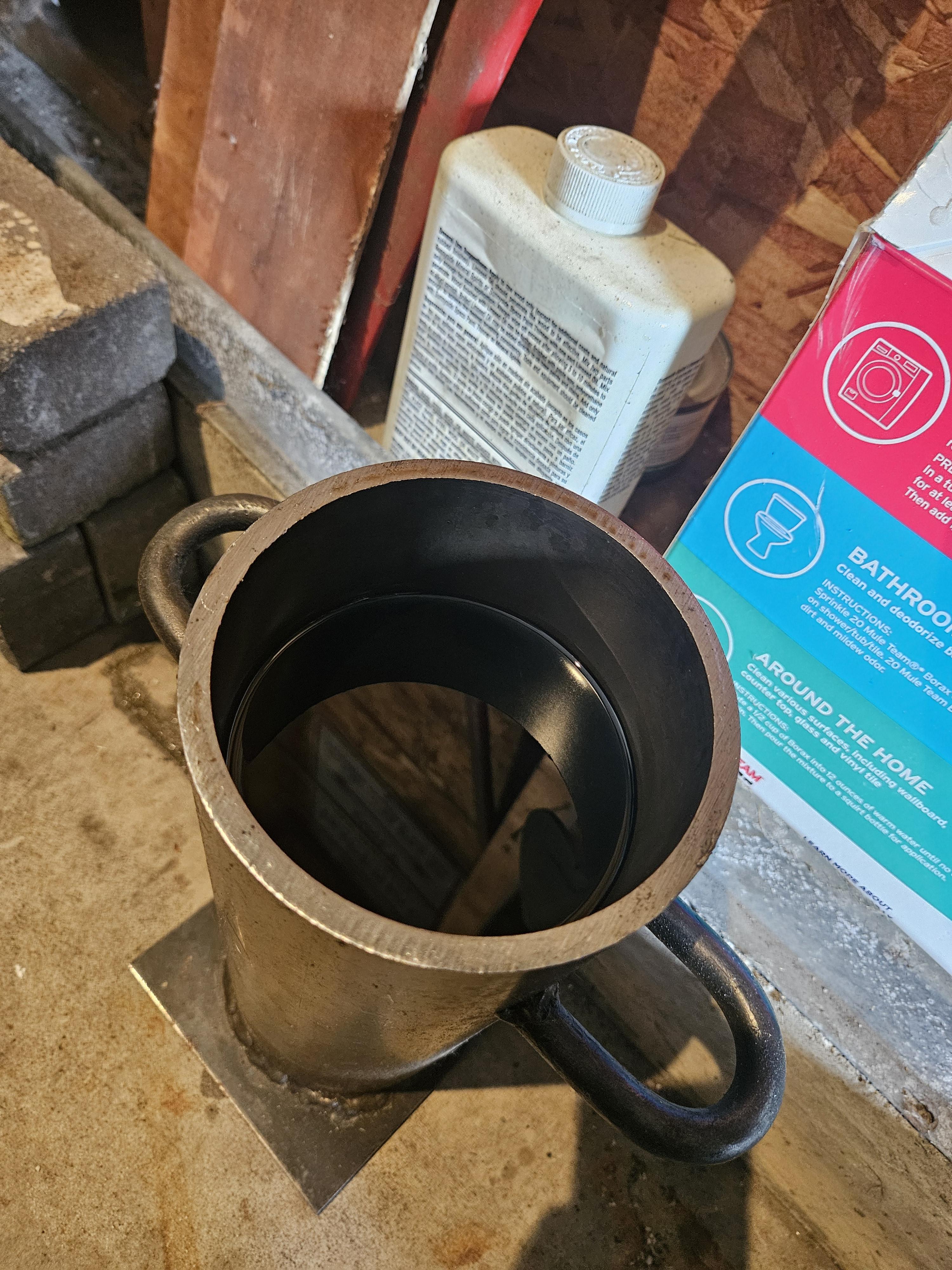

This punch had lost its tip definition after light use, very flattened out, requiring a re-grind on my belt sander to a tip once again.  On my Mr. Volcano forge, once up to operating temps, I had the punch on the forge for about 8 minutes at a orange/yellow heat.  The punch went into the Fusion 10 quench oil immediately, gave it about 30 seconds in the oil, moving it around.

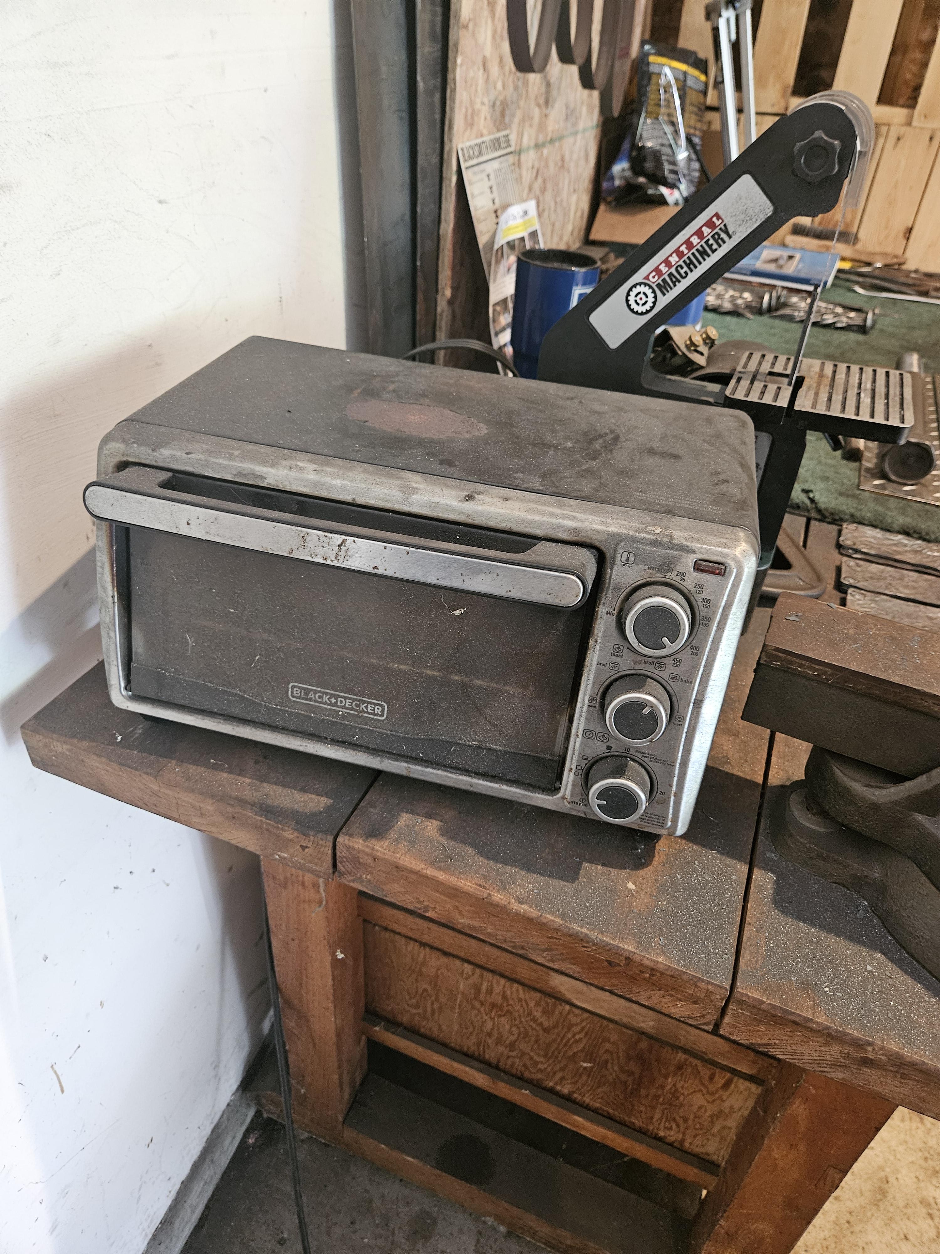

After a couple of minutes on a cooling rack, I wiped the excess oil off of it and placed it into my repurposed kitchen toaster over for 2 hours at 425° for a temper.

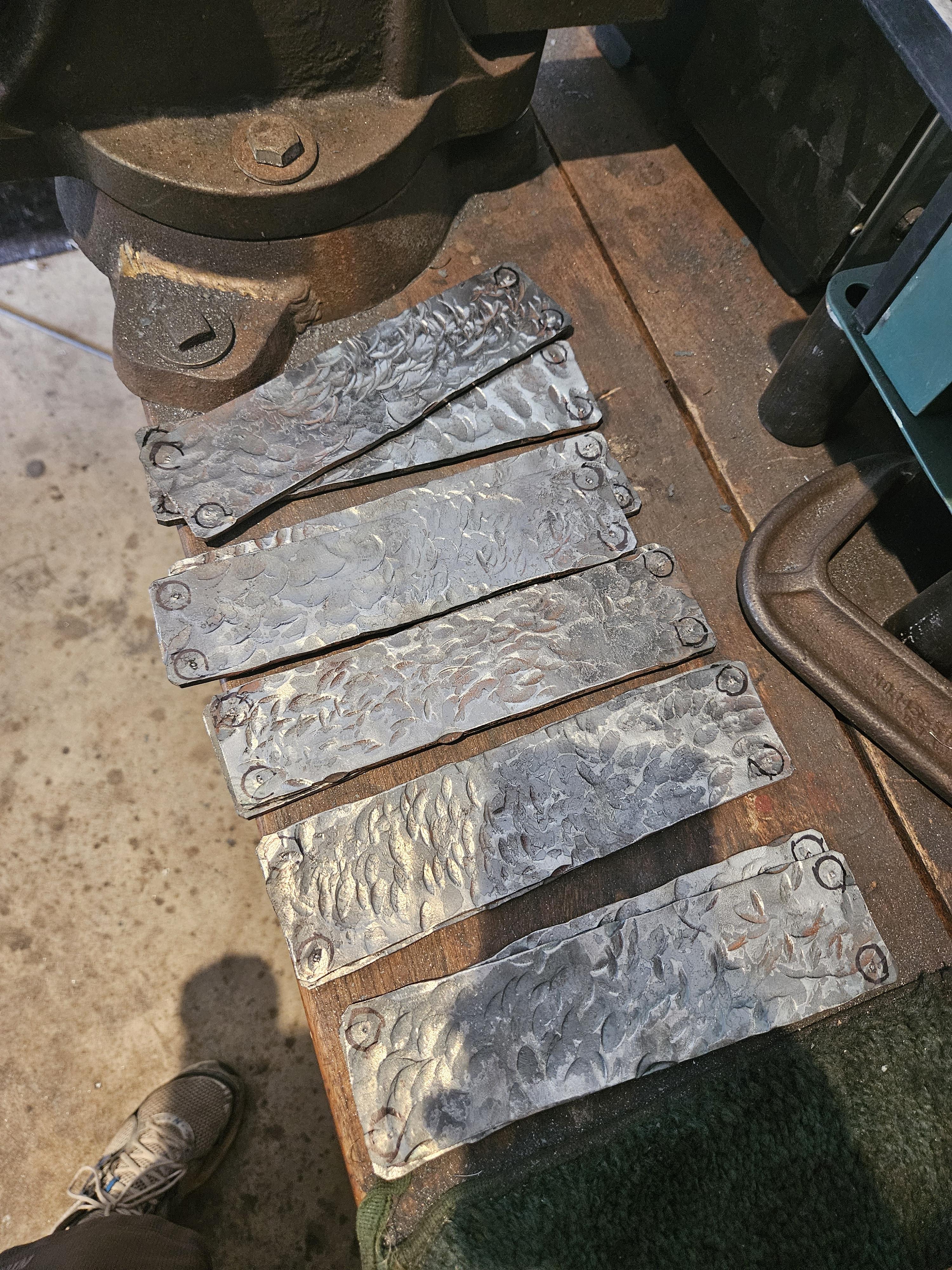

Well...I just used the punch to do 20 punches on mild steel...and I have zero deformation on the tip!!  It definitely wasn't like that before!  I do not know the exact type of steel that this punch is made from, but assuming a tool steel is a very safe bet.  It did harden, and testing proved it.

Sharing pics of the punch,  my harbor freight belt sander, my tempering oven, the steel that was punched, and the custom oil quench tank I fabbed up with Fusion 10 oil in it.
Need to correct my post, but can't edit original:  I did 40 punches.

That is WAY too hot to harden. At high orange to yellow there's a chance the steel will shatter in the quench and a way better chance it will form micro fractures. Next time just bring it to non-magnetic and let it soak for a few minutes. Use an iron magnet to check, NOT one of the robber ones! I have a magnetic extending pickup tool I use. It collapses to pocket size and fits a breast pocket nicely. It's also REALLY handy for picking up things I drop.:ph34r:
I have the same model Black and Decker toaster oven in my shop!
Frosty!  Thank you!  Noted for future reference.  You're one name I've seen on more posts and boards than I can count,  I know you know your stuff, you have my gratitude to have your input on one of my posts.
Frosty-meant to mention I have a telescoping magnet too, I have used before to ascertain critical temperature.  Even came in handy when tongs didn't have a good grip on a small piece of O1 being used as a heat-treat trial-piece.
Glad to hear you have the same oven!  My wife didn't want it anymore due to getting an air fryer, so I said I will gladly take that for shop use!

ILoveSteel:  if you haven't already, look up the recipe for superquench. It will give you a way to sort of harden mild steel. I've had a lot of fun making cheap chisels and punches with it.
