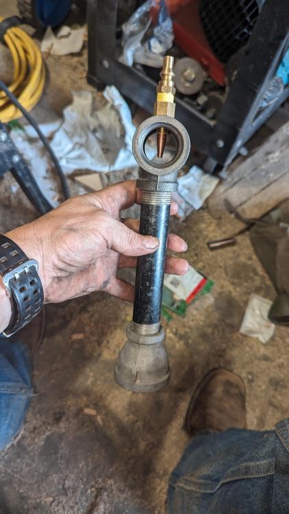

Ok, getting the T Burner put together and testing it before hooking it up to the ribbon burner. For some reason I can't seem to get it to light. I've attached some pictures of the burner. I'm using a 30psi regulator, needle valve, and ball valve before the quick connect. The tip length difference is the two different tips I tried in it.PXL_20240607_180443334.thumb.jpg.3f5e691be84a745c5b2fa3b7754e08fe.jpgPXL_20240607_180433246.thumb.jpg.7d1f9a640b259f7223c9bb6048f35f72.jpgPXL_20240607_180329758.thumb.jpg.7678ea1280f2c71eb592d20ad4b3e899.jpgPXL_20240607_180337797.thumb.jpg.83ecc3a979b8dba3478ab30a3d33d783.jpg

The mixing tube looks to be about 6" long and the T says its 1" x 3/4" so that much looks okay. I never use  bell reducer for a flare but lots of guys tune them to work so it's maybe okay.
The problem I see is in the pic looking down the mixing tube, the gas jet (mig contact tip) is off center. Centered down the length of the mixing tube is important.
What diameter are the mig tips?
The farther away from the Throat (where the T and mixing tube meet) draws more air, that is how I tune mine, I NEVER extend the jet farther than half way across the intake ports as seen in your pic.
Yea the pic down the tube was slightly off. It is centered though. The tip is .035. Only thing I can think of is maybe my tank is just to low to provide enough gas. I'll stick with the shorter tip then as it's right at about midway. I guess I'll try again and update when I can get a full tank.
A low tank doesn't usually cause issues if it's a short burn time but full is better. 0.035 is what I run in my 3/4" Ts. We'll get it tuned and working.

Ok, barely cracking the needle valve I did get it to light...sort of. It was burning back to the mig tip, and as soon as I open the needle valve more it goes out. Take off more tip?
How many psi are you putting through the regulator? I've never used a needle valve, I only have a 1/4 turn ball valve between the regulator and burner and that's just open/closed. I've had burners that wanted me to take a second or so opening the ball valve but if it needed more I rebuilt the burner I'd done something wrong.
Just open the needle valve and forget it's there. At best they're useful for fine tuning a specific flame for a specific reason.
Do you have a gage on the regulator? Except for very broad psi I do NOT recommend a gage, too many people try to tune a burner to run under the same pressure some guy on the internet runs his. You want to tune the flame, not the pressure if that makes sense, if not forget I said it for now.
Burning back to the jet means there isn't nearly enough psi to operate. If on the other hand it blows the flame off the end of the burner the psi is too high.
Put the short jet back in, we'll go from there.

PXL_20240608_003247312.thumb.jpg.3c5f85f6a1ff3fba191b7a9ba4110016.jpgThis is what my setup looks like. I tried starting at 5psi. It seems like it's blowing it out so I will try just cracking the regulator? I'll have to see if I can find thread protectors. I'm sure there is a plumbing supply nearby somewhere.
I may possibly have figured out my problem....it helps if you double check things. My tip was .025 not .035. upon replacing it if I light it with minimal gas pressure and slowly turn it up it will catch and hold the flame and was able to turn up to 5 psi and had it roaring. Now to make it work with my ribbon burner head lol.
