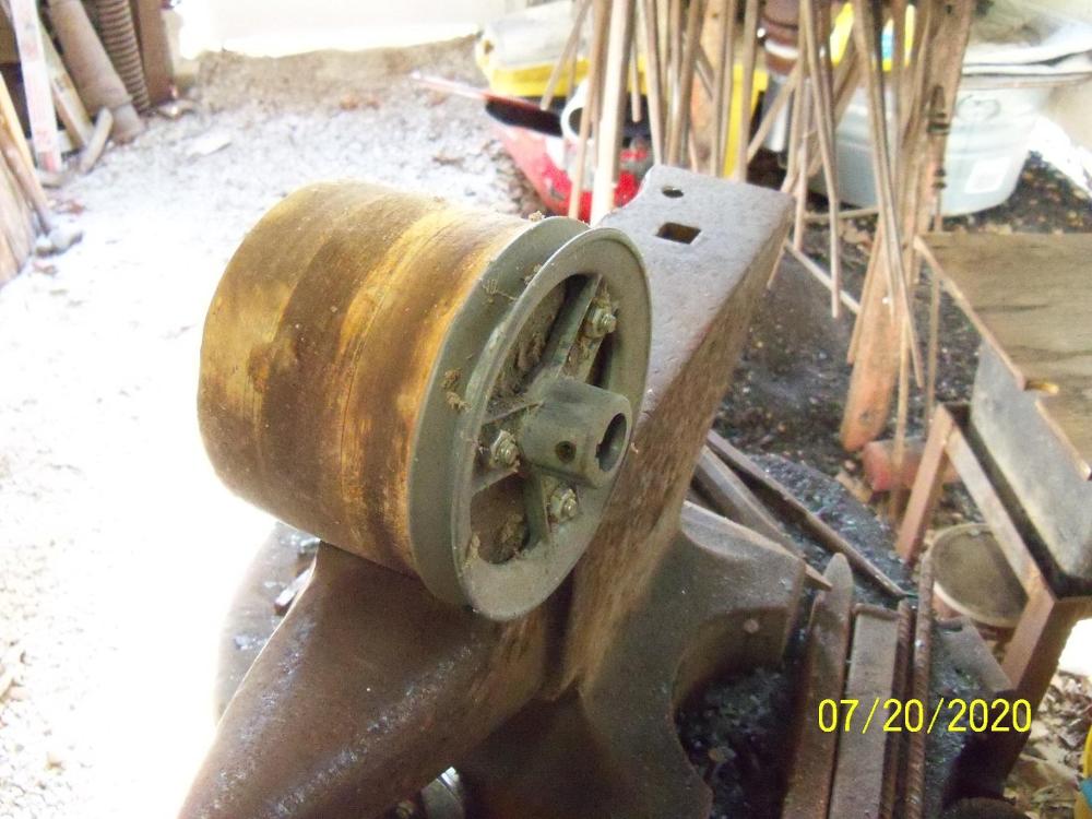

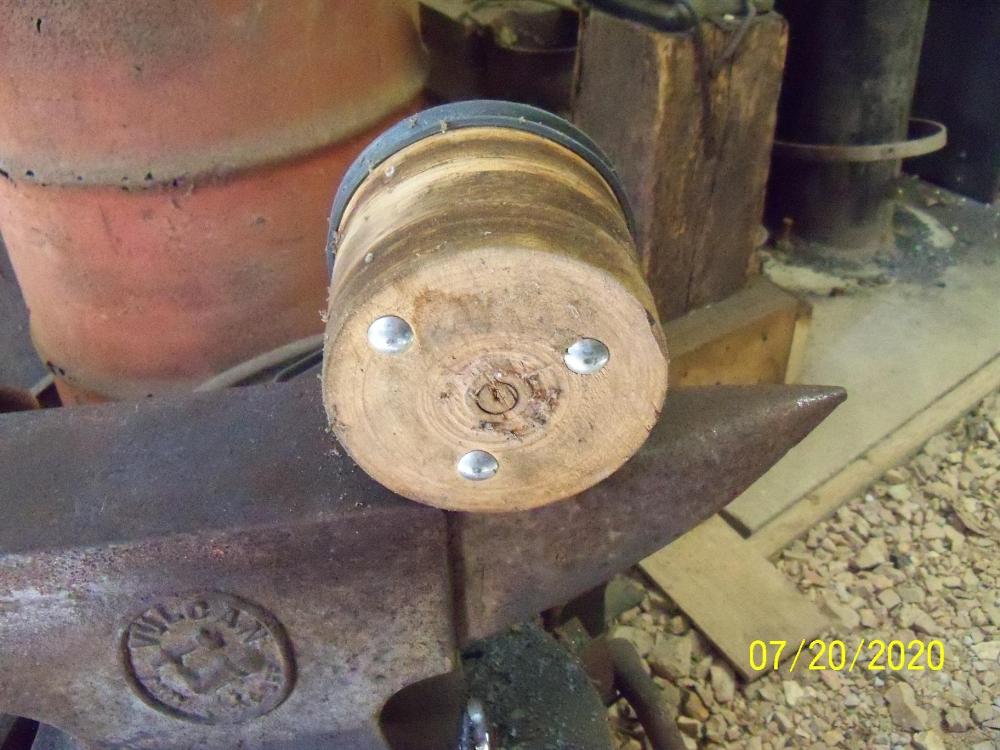

Are we talking about the drive pulley that goes on the motor. If so I made one to run my 30 pound star, but couldn't use it as the mice/pack rats ate the leather belt, so I converted to a V-belt drive. Here is the one I made, laminated wood mounted to an old V-belt pulley turned down on the wood lathe. It could use a bit of a crown to help the belt stay on.
