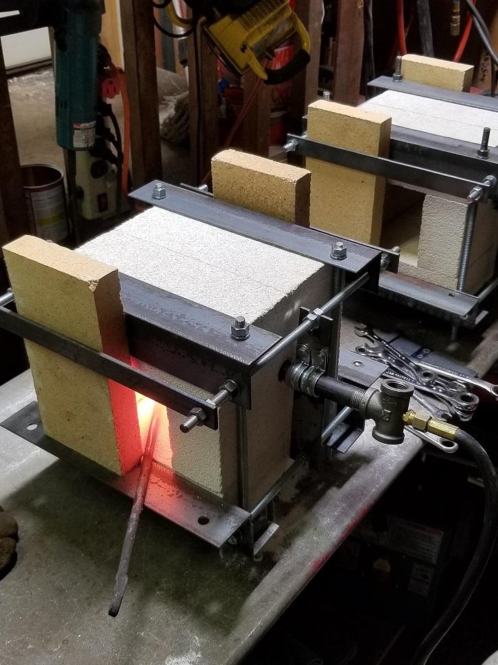

Frosty Posted February 22 Share Posted February 22 If you want to make a fire brick forge then make one. Mixing and mismatching different types of forge never works well, believe me I know. Below is the picture of my no weld, brick pile forge it uses Morgan Thermal Ceramics, K26 insulating fire bricks, they are designed to survive tapid temperature change and are rated to a sustained working temperature of 2,600f. They are rapidly replacing the old 1600f soft insulating fire brick that used to crumble in a couple firings. K26 are cheaper and that was when the old style IFB (Insulating Fire Brick) were available. The pic was taken less than 5 minutes after lighting, someone stuck the piece of steel in right away. It was on the final day of the club's burner and forge build clinic a real madhouse. We built IIRC 34 functioning forges. The interiors were kiln washed with Matrikote. Matrikote and Plistex are ceramic compounds like glaze you do not need to go through a complicated firing sequence. It will air dry in maybe 10-15 minutes, light the burner for a couple minutes to dry the brick underneath then bring it to working temp. Both products have working max temperatures in excess of 3,000f As Buzz and I have told you building the forge correctly, just follow the detailed instructions in the propane forge section of Iforge. A properly built propane forge is as safe as any home built propane burning appliance is going to be. The ceramic fiber is completely encapsulated by the hard refractory and cemented together by the rigidizer. To get a release of fibers you'd have to break the liner out of it by main force, hammer and chisel for example. Regardless, if using Insulwool, the non-persistent refractory blanket ("Non-Persistent" means the material it is made from can be dissolved by the human body without producing dangerous byproducts. Anyway, if the safe stuff is still too scary for you then try a brick pile forge and wear a dust mask when drilling, cutting, filing, etc. the bricks themselves. Frosty The Lucky. Quote Link to comment Share on other sites More sharing options...
