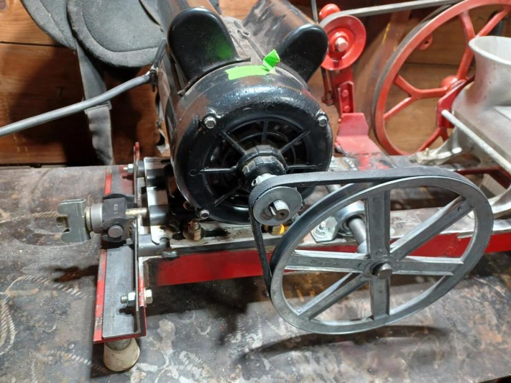

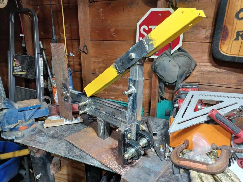

Archie Otteson Posted February 18 Share Posted February 18 First three are the meat grinder and base after latest rebuild and paint.. I'm telling you that thing will grind frozen meat without hesitation. Geared down to a brisk 85 RPM and grinder input wheel. Last two are the belt grinder in progress. I just ordered the wheel set today. I know things are backwards right now. Platen is on wrong side for the wheels. It won't end up in this exact form after the tweeking is completed. A work in progress. Quote Link to comment Share on other sites More sharing options...

Archie Otteson Posted February 22 Author Share Posted February 22 Everything unbolts from the frame. After that cleaning is pretty straight forward. The frame gets sprayed off in the laundry tub. The ready rod is there to hold the plates on the output side. I was grinding some stiff cold meat and the threads stripped off the grinder. Instead of buying a new grinder I made those plates to hold it all together. Quote Link to comment Share on other sites More sharing options...

Archie Otteson Posted February 26 Author Share Posted February 26 The one I have uses 1/4", 5/16" and 3/8" nuts and bolts. Then the grinder portion gets rinsed in hot water then into the dishwasher. I found out early on to store it all dry in a wood box. The time it got oiled before storage the oil "polymerized". There was one fine holed plate where the oil was so hard I degreased it with my torch. I also have a all in one like the kitchen aid. Just noi fast enough to grind season and stuff 30lbs of meat. So, I made this one in the picture. Quote Link to comment Share on other sites More sharing options...
