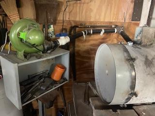

Here is my rig for the airflow on my ribbon burner. This one is a plain 1&1/2” ball valve plumbed in approximately 2’ ahead of the mixing tube. I have had excellent luck with is set up for the last two years. I believe we even have the exact same blower. Hope that helps.
Thanks for the pic BsnNFrnt. I’ll take that PVC ball valve into consideration. Your blowers just like mine, I guess the input damper on the blower wasn’t enough? Just out of curiosity do you have any pics of the face of your burner? Just curious really about hole size and number of holes.

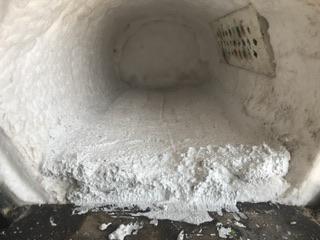

Yes sir, the rotating damper on the side was not enough for me. I use a valve on the air flow of my coal forge set up too. My burner is 12”x4”, there are 32 individual crayon sized holes. As you can see from the pictures. I run a .030 mig tip for the propane supply and mixing tube has a blender vein inserted nearly the full length. I can attain welding heat around 4-5# of propane tank pressure.
My forge opening is roughly 11” by 7”. I use various arrangements of doors depending on what I am working on.
I went ahead and dropped in a picture of my crayon mold for reference. I got all the ideas and information from the ribbon burner threads on this site.
