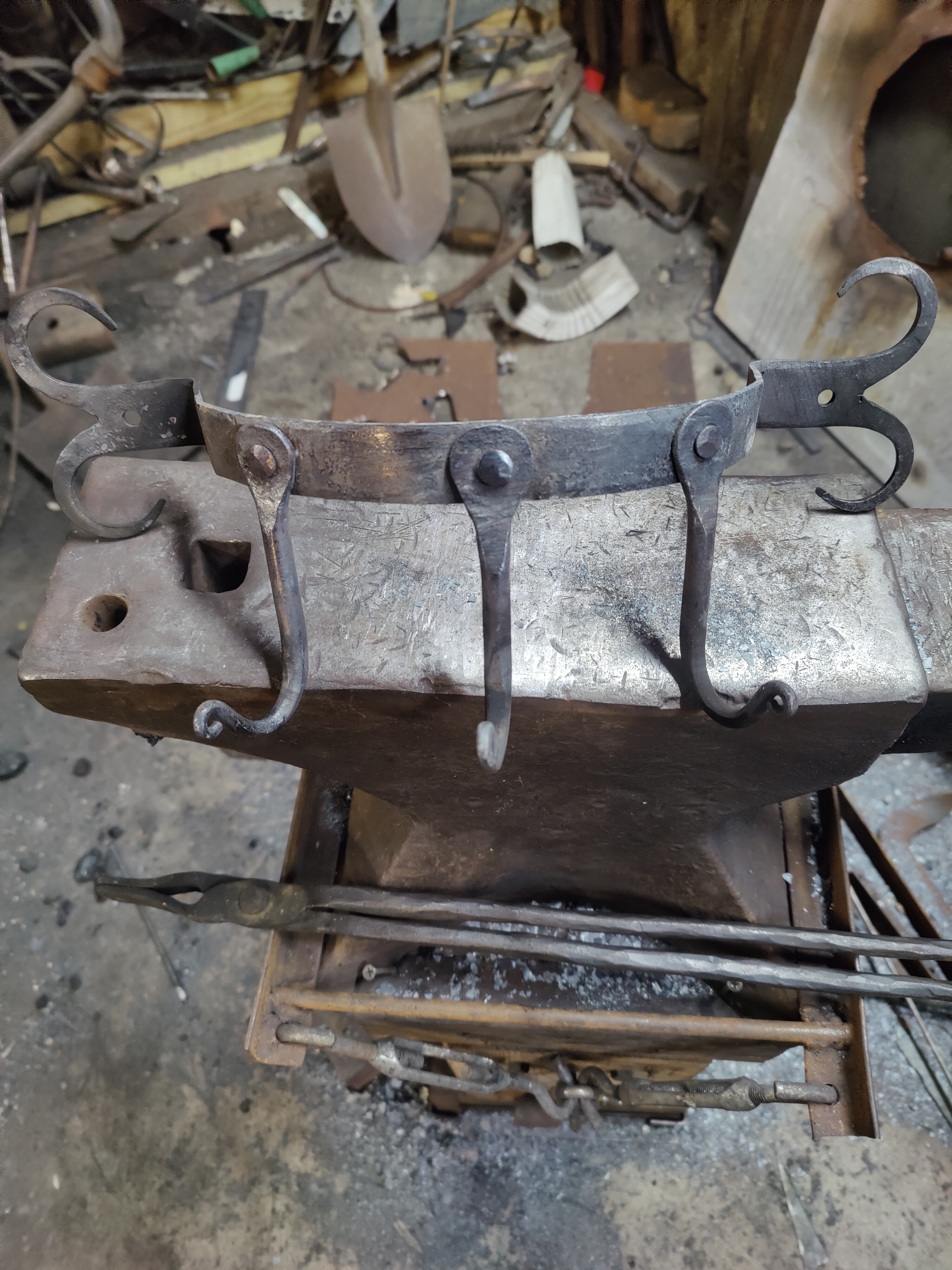

Here is the set i made for m parents last Christmas. It was my mom who suggested the broom handle be shorter to make it more wieldable when in use. The broom is one i bought at the local hardware store and just put my own handle on. A whole broom cost like $8 where a replacement head for one was like $10 or $12.
I made this to hang it on the wall rather than a stand that can keep getting knocked over.

The swage i used is actually the one they are laying on in the pic. The other side has a shovel form. I have doen them on the anvil though and you can also cut and bend into square shovels. Using the anvil the sides are not to difficult, just use the corner of the anvil, but the back, or what i have always called the heel, is a bit tricky. I use the step of the anvil and hit it with the corner of my hammer. It takes time and is fussy but with patience it will come out.
