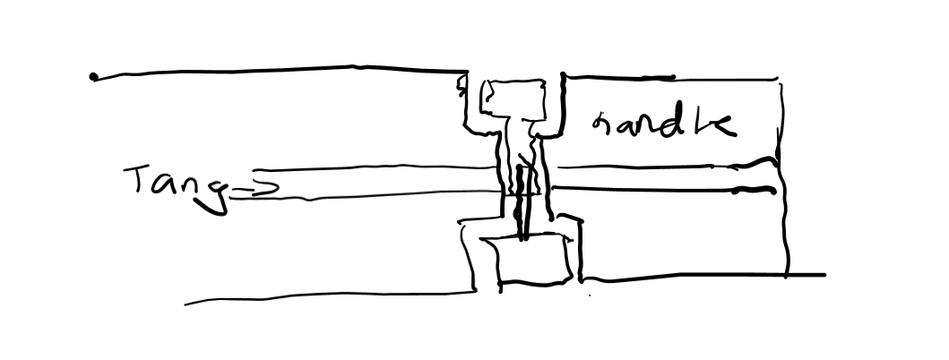

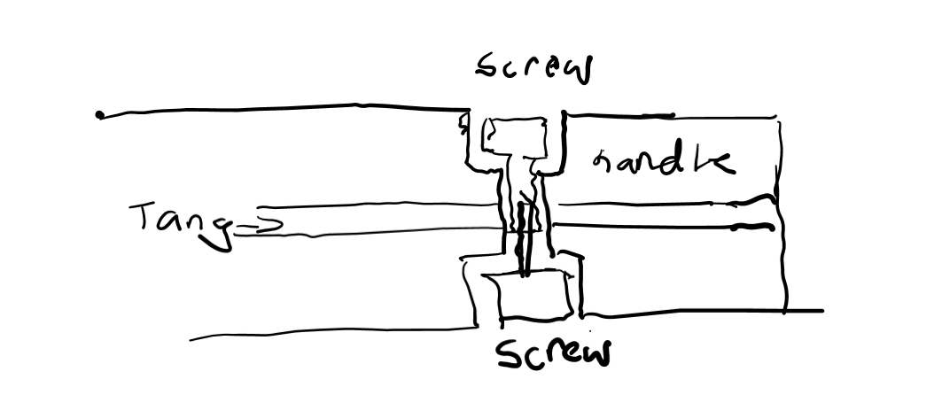

yes the plastic is either black or blue, so having fancy designs wouldnt be an issue. as for fastening, i was just thinking of using a 2 part epoxy and some sort of pins. i saw some quite cool pins a while back on a YT video, i cant remember what it was called tho, they were ones that you counterbore a hole and then the pins screw into each other and lock very tight. kinda like this. if you know what they are called i would appreciate it if you could tell me.
Corby sounds like the name. Try searching on a knife supply site. If you use your preferred web search engine and add Iforgeiron to the terms it will search Iforge first and IFI has a large knife section. Unfortunately Iforge's search engine stinks LOTS. but that's the operating system, not Iforge.

They're corby bolts, and almost any epoxy will do fine for you. Just don't use five minute stuff. It would likely work, but I've had some of them fail me a few times over the years. Only once with a knife handle, but still.
Truthfully, a couple of plain old .125" stainless pins will do you just fine. Unless the look of the corby bolts is what you're after. Just dome/rivet the ends and you're good.
